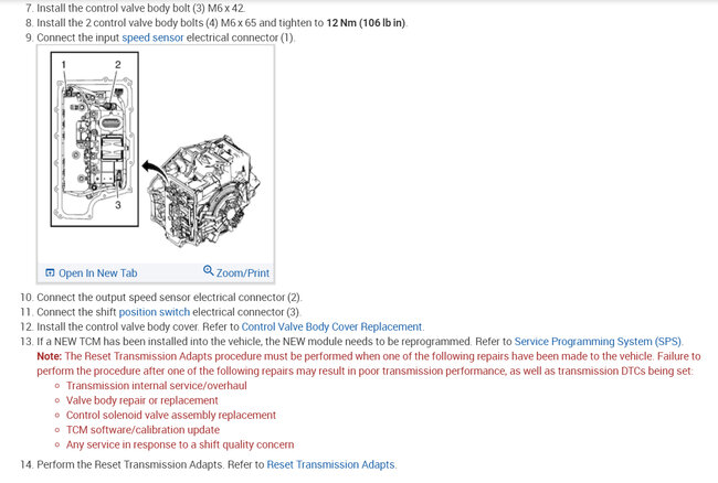

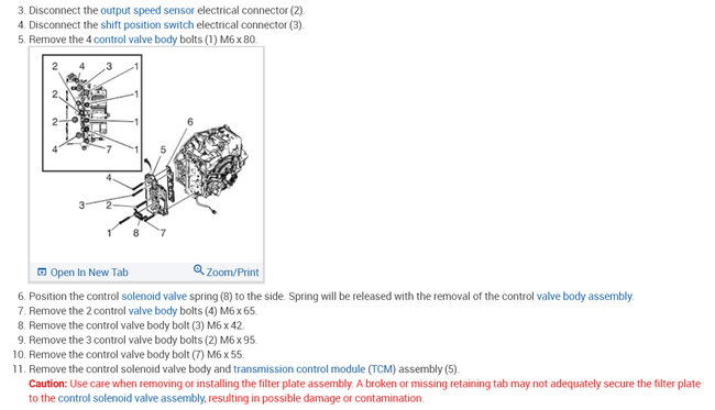

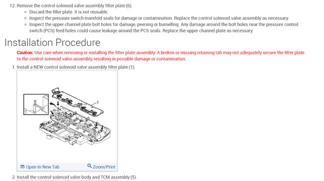

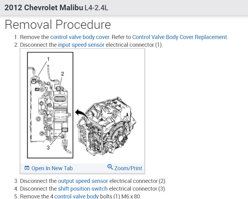

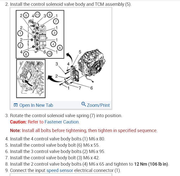

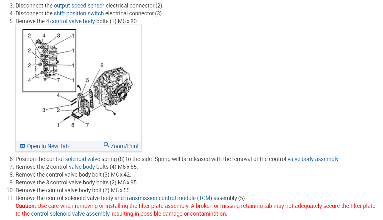

Let's go through each code:
P0013 - Camshaft Position Actuator "B" Control Circuit/Open (Bank 1):
P0700 - Transmission Control System (MIL Request):
P0766 - Shift Solenoid "D" Performance or Stuck Off:
P0324 - Knock Control System Error (Bank 1):
P0326 - Knock Sensor "1" Circuit Range/Performance (Bank 1) or Sensor Performance (Bank 1):
Here is how to change the shift solenoid out to fix the problem. Please start a new question for the additional problems we only handle one problem per thread, please post your new question here, you must be logged in.
Check out the images (below). Please let us know if you need anything else to get the problem fixed.
