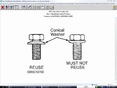

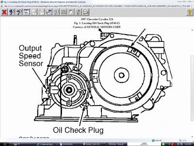

I have tried checking the trans fluid but there is no dip stick in the cap, I don't know if that is suppose to be that way or not. How can you tell if the level is full?
Dec 13, 2007 at 10:17 AM
MERLIN2021
  • 17,250 POSTS
Manual sys, warm to operating temp, then shift thru all gears, leave in each gear 3 secs, then leave it running, raise on a lift, remove the plug, if fluid drips out, it's full, if fluid is added stop when it puors out.
