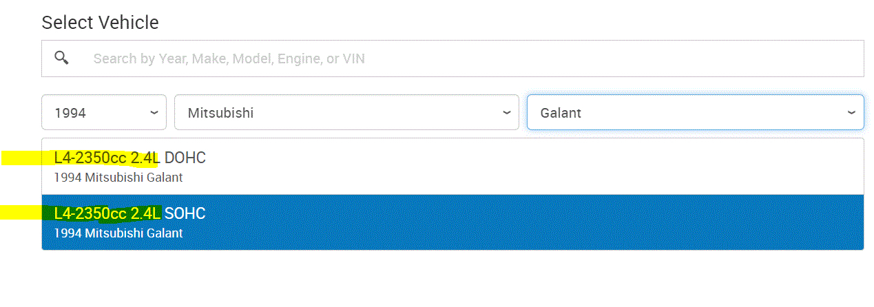

Let me know as much as you can. Also, let me know if you have a live data scan tool, the fault code found, and I need the correct engine size. According to my manual, it came with a 2.4L SOHC or a 2.4L DOHC. See pic below.

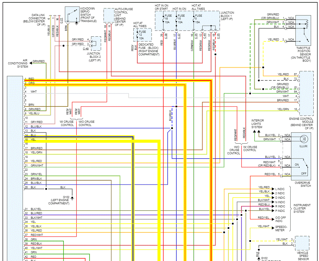

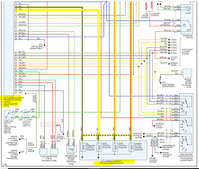

Also, I attached a copy of the wiring schematic for the transmission. I highlighted the wires that are related to the transaxle solenoid valves. Note where they all go to. Each one is controlled by the transaxle control module located under the dash in the vehicle.
The chances of two solenoids failing this quickly are low. I suspect there is either a wiring issue between the solenoids and the control module that is being temporarily fixed when work is done. After a short time, the connection is lost.
Of course, that is a theory at this point. However, before I would replace more parts, I would wiggle wires, disconnect and reconnect harnesses and inspect them, and see if it makes things work again for a period of time.

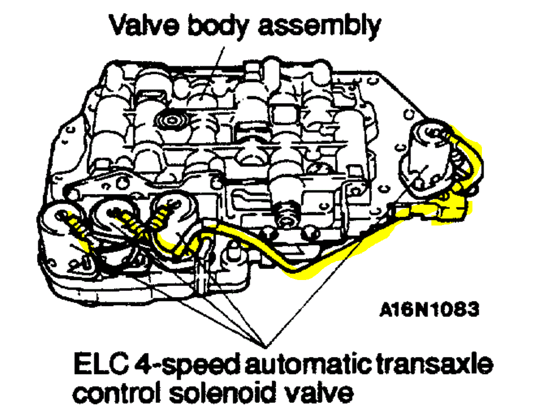

Let me know. If that has been done, then it's time to start checking wiring for faults. If one exists, it is likely in the transmission. The solenoid valves are attached to the valve body. See pic 3 below.

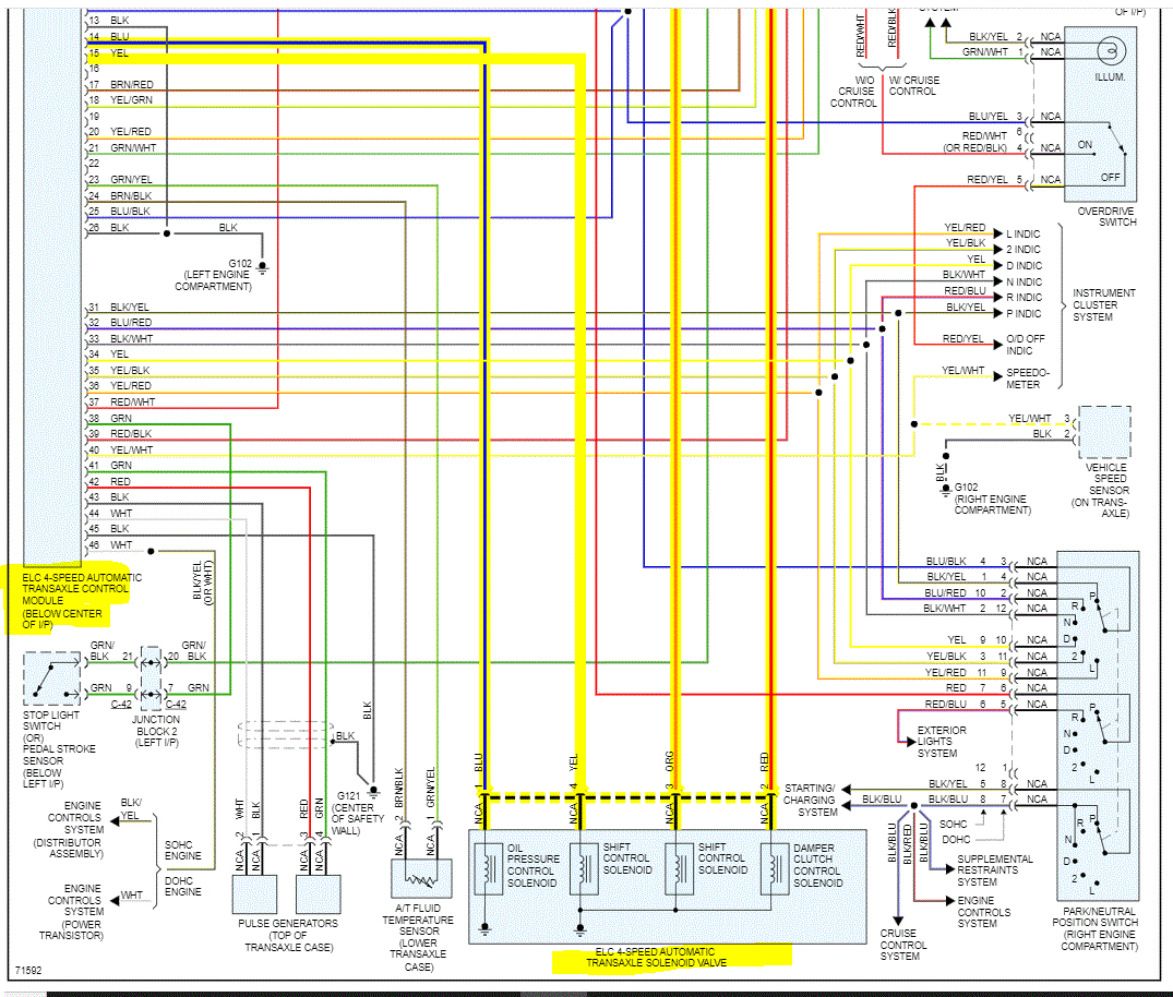

See pics below: Note: I had to cut the wiring schematic in half to make it readable. However, I did overlap the two pics and highlight the wiring involved.
