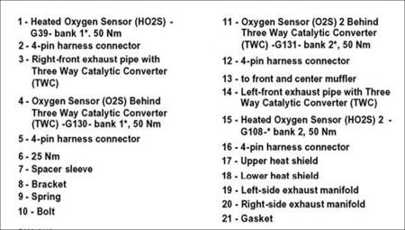

Hello Okay, you have 4 sensors on the vehicle. Here are the banks below. Cylinder bank 1 is located on right side in direction of travel. Cylinder bank 2 is located on left side in direction of travel.
https://images.2carpros.com/forum/automotive_pictures/248015_Picture1_96.jpg
https://images.2carpros.com/forum/automotive_pictures/248015_Picture2_62.jpg

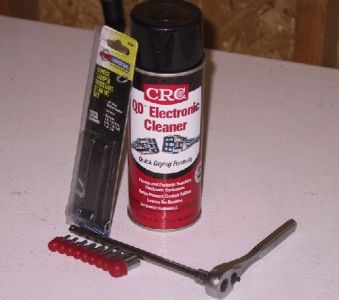

Since your code is Bank 2 Sensor 1 that would be number 15 the one before the cat. You are supposed to follow the directions below using the grease. You may have to get this at the dealer. 1. Heated Oxygen Sensor (HO2S) 2 - G108-* bank 2, 50 Nm Only use "G 052 112 A3" to grease thread; do not let "G 052 112 A3" get onto slit of oxygen sensor You will need to use a special tool you can get it at Auto Zone and you may be able to use their tool check out program if they have that to loan.
https://images.2carpros.com/forum/automotive_pictures/248015_02_Sensor_Tool_1.jpg
Try cleaning your MAF sensor with electrical cleaner. Just spray it really good...the resistors and the fine wire. don't touch it otherwise. just the spray.

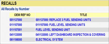

Hello - Also, it looks like you may have some recalls on your vehicle. The dealer may fix these for free. Please contact the dealer service department, give them the VIN number of your car and have them check on these to see if they apply to you.
https://images.2carpros.com/forum/automotive_pictures/248015_Recall_30.jpg
