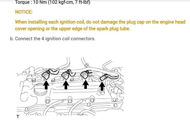

My car recently had a rough idle and after checking the Check Engine light at AutoZone, they told me that I'd have to try and replace them. I don't have the money to go to a mechanic and have them do it for me so I'm trying to do it on my own.
Will something happen to my car if I disconnect the battery to do this? And any tips to try and make this easier on myself?
Apr 22, 2022 at 8:08 AM
Good afternoon,

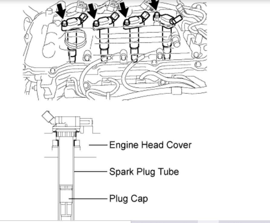

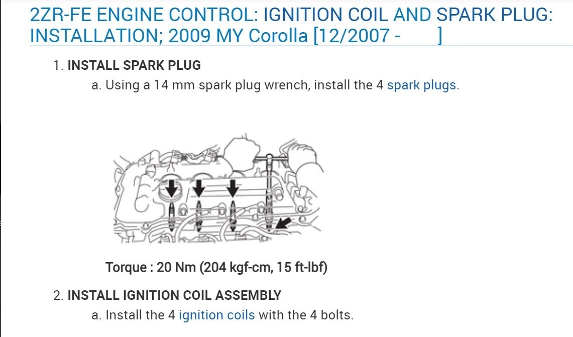

No need to disconnect the battery. Just remove the four connectors for the coils and remove the plugs.
I attached the procedure below for you.
Apr 22, 2022 at 8:17 AM
ANTHONYWILSON1
Thank you so much! Though i am worried about the torque since I don't have that kind of wrench on me. Would i have to get a digital display wrench or is there a different way?
Apr 22, 2022 at 11:40 AM
You can rent one at a parts store.
