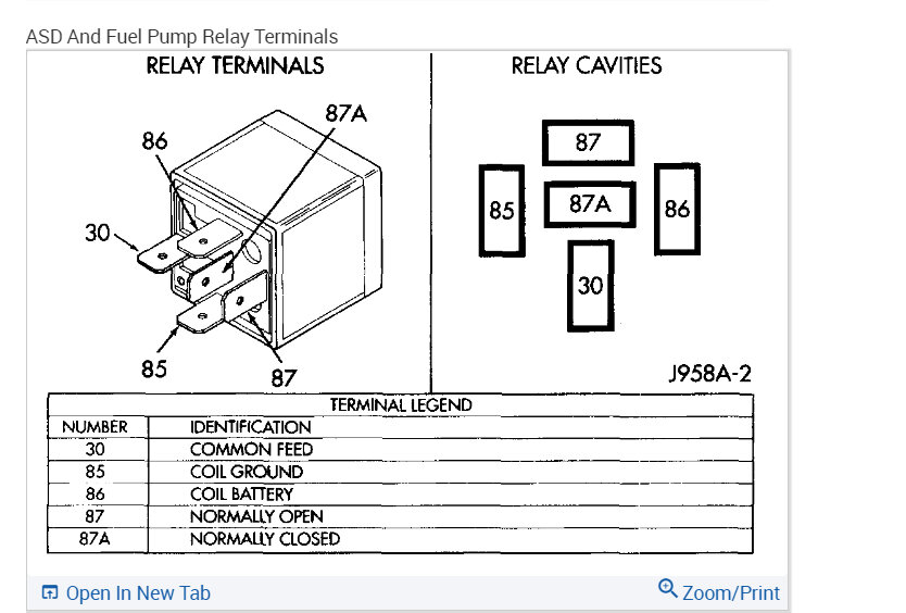

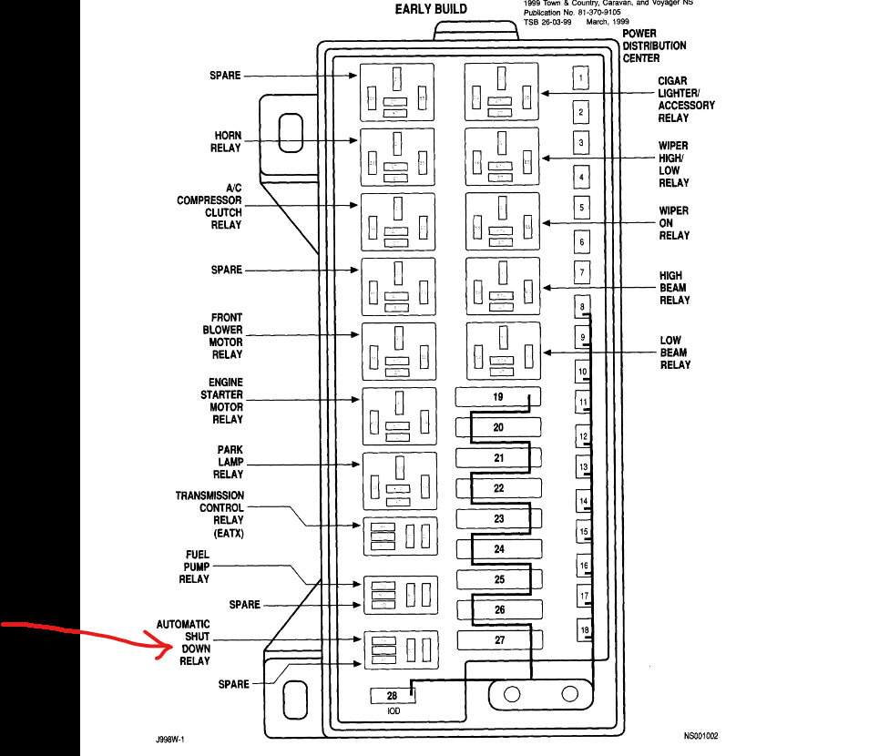

So now you can't hear the fuel pump with the new battery, does the engine crank over but not start? Here is the location of the ASD relay so you can swap it out to see if that fixes it. Also, if it cranks but does not start can we try starting fluid to see if the engine runs? Please check the images below for the ASD relay location.
This guide may help as well:
Check out the images (below). Please let us know what you find.

Hi folks. Please allow me to make one comment that may head you in a different direction. That has to do with your understanding of the ASD relay. "Automatic shutdown", (ASD) relay is a confusing term due to how it works. This has nothing to do with the anti-theft system. Other manufacturers use a similar relay but with very different names. Its purpose is to stop the engine when one of two sensor signals goes missing.
Under normal operation, when you turn on the ignition switch, the Engine Computer turns the ASD relay on for roughly one second. During that one second, 12 volts is sent to the ignition coil(s), injectors, oxygen sensor heaters, and the fuel pump or fuel pump relay. If you can hear it over the chime, you may be able to hear the hum of the fuel pump for that one second. After that, the ASD relay is turned off until you crank the engine. At that time the crankshaft position sensor and the camshaft position sensor will develop signals that switch on and off multiple times per engine revolution. Those are the signals that tell the computer to turn the ASD relay back on. Now there's power to the ignition coils, injectors, and fuel pump.
That ASD relay remains on as long as the engine is rotating, (cranking or running). This is a safety circuit. If a fuel line is ruptured in a crash and the fuel pump were to remain running, raw fuel would get dumped onto the ground, creating a major fire hazard. Instead, with a broken fuel line, there can't be any fuel pressure. With no pressure, no fuel can spray from the injectors, so the engine stalls. Once stalled, there won't be any signals coming from the crankshaft position sensor or the camshaft position sensor. When either or both signals go missing, the computer turns the ASD off to stop the fuel pump.
