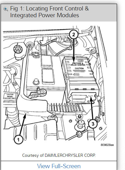

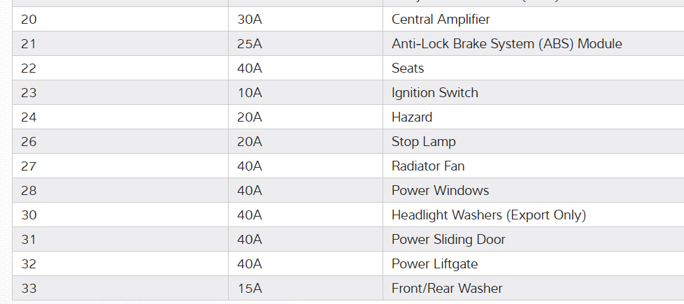

I am not a car guy, my battery went dead and I went and bought another battery, without looking I put the batter in wrong, went to attach the cables seen a spark and put it in the right way. Car starts and wipers work electric seat works but heat, radio and alram doesnt work. Any ideas? I took it to auto zone and that was useless. I went to advanced auto they said fuse was blown but we could not find one that was blown. Help I live in Ohio and I need the heat too work.
Monday, February 15th, 2010 AT 11:29 AM
JDL
  • 16,098 POSTS

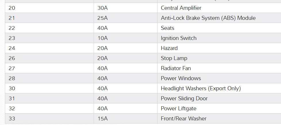

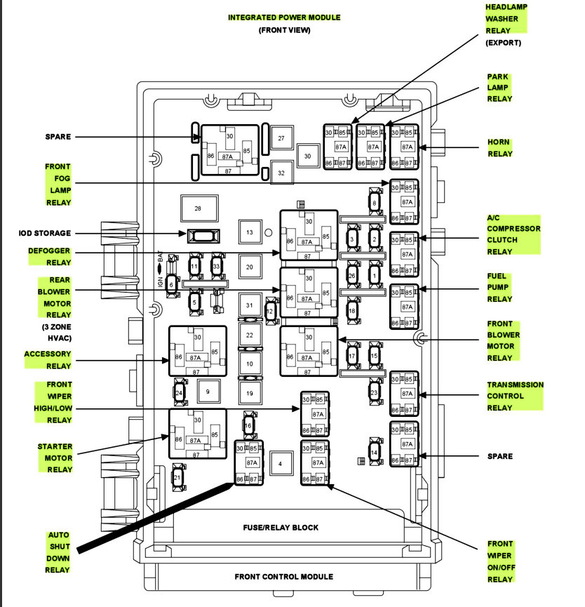

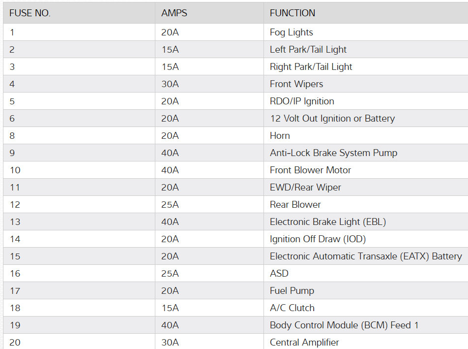

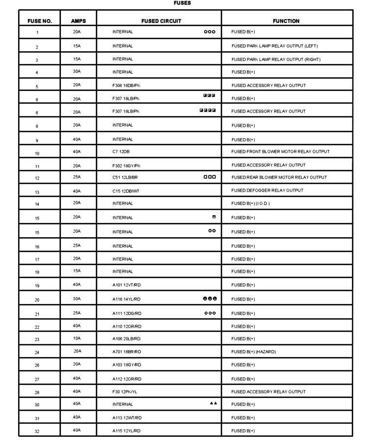

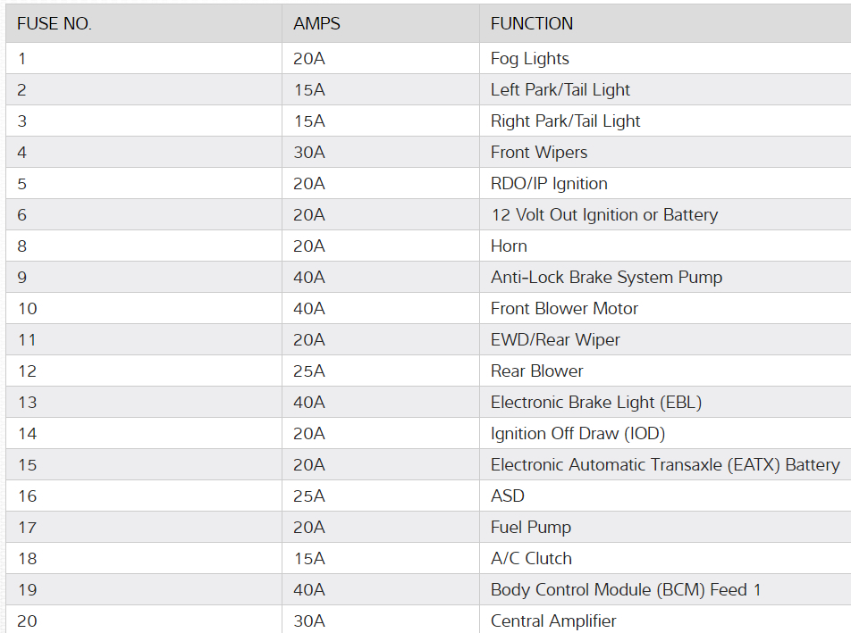

Here is a guide that can help you check the fuses with the fuse locations in the diagrams below.
https://www.2carpros.com/articles/how-to-check-a-car-fuse';
