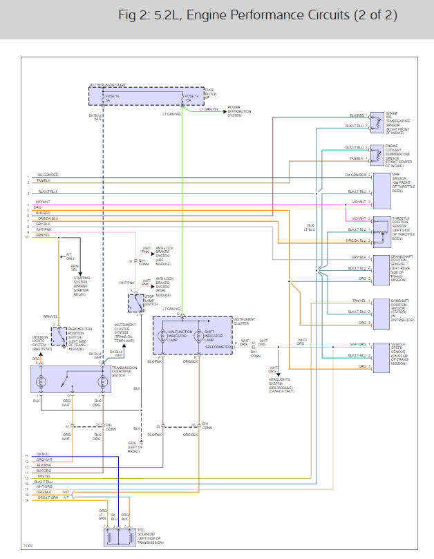

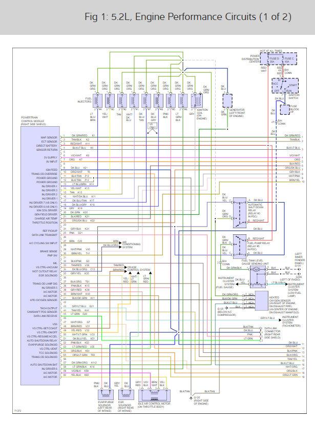

Is the security light flashing when you try to start the car? It sounds like a computer issue not closing the relay, but we should check the wiring. Here is a guide to help you and the ASD relay wiring diagrams:
Check out the diagrams (below). Please let us know what you find.
