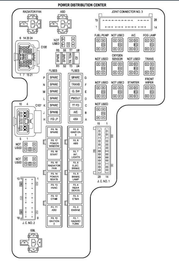

2002 dodge dakota can anyone tell me how the automatic shutdown relay is listed in the power distrabution panel is that how it is listed or is it called something else.thanks and may god bless
Aug 22, 2010 at 12:00 AM
  • 75,988 POSTS

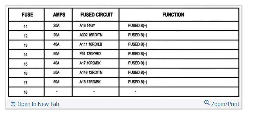

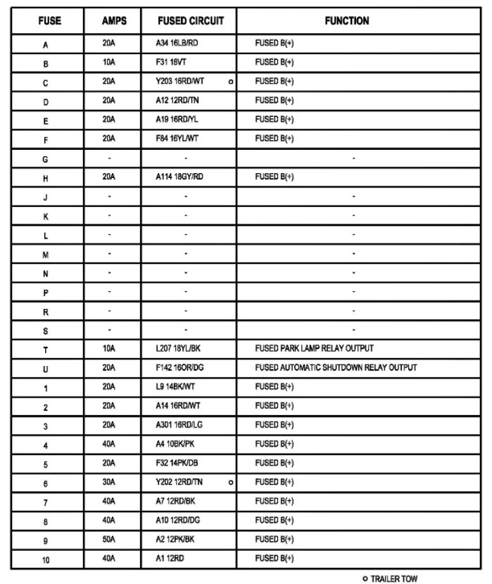

The ASD relay is located in the Power Distribution Center (PDC) . Refer to label on PDC cover for relay location. Here is a guide to help test the relay with the ADS relay location in the diagrams below.
