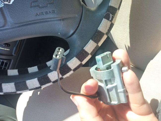

I had to replace my ignition because i lost my only key. Finally put in the new ignition and the car turns on and runs fine. But the anti-theft light stays on solid now. How do i reset the system to accept the new ignition/key to get the theft system light off?
Desperate for help.

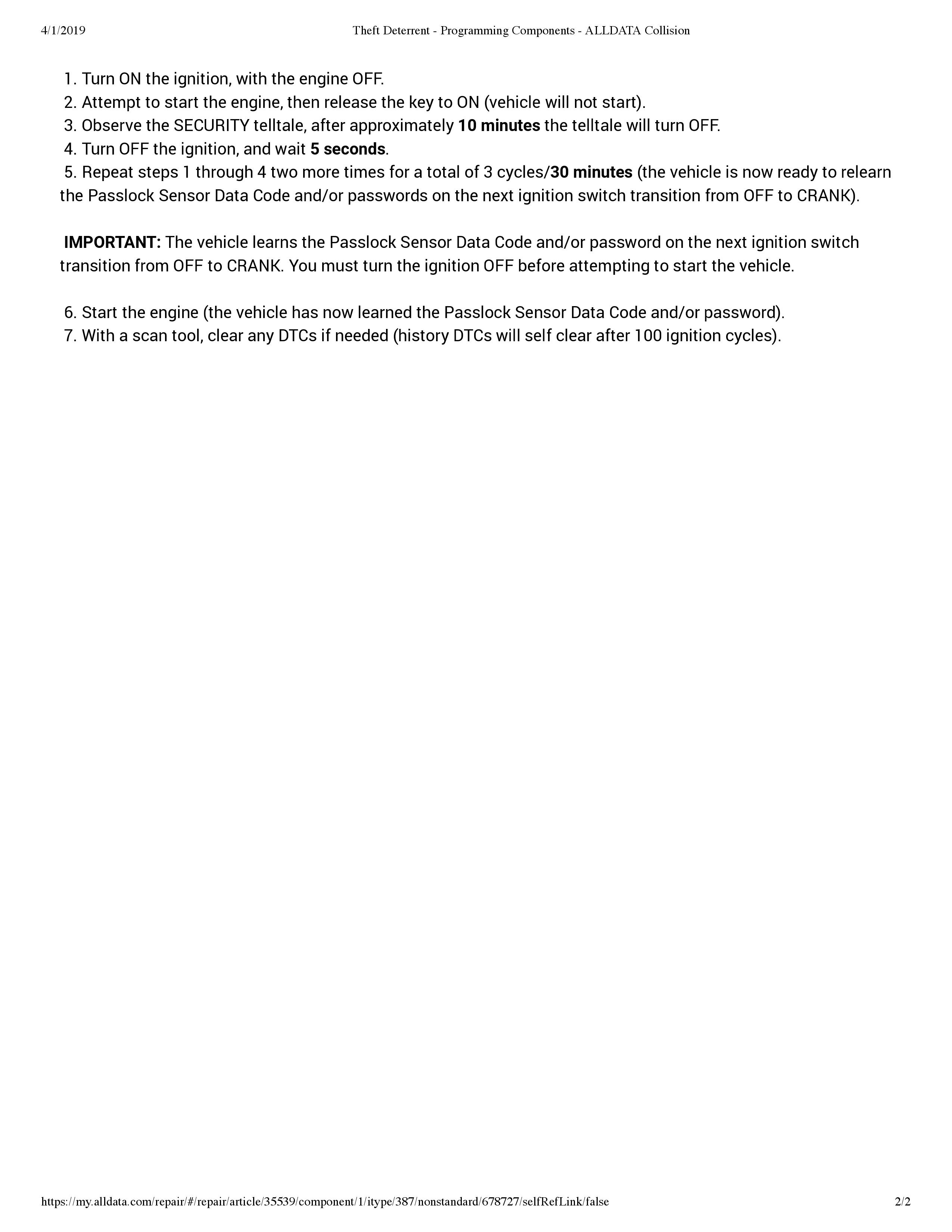

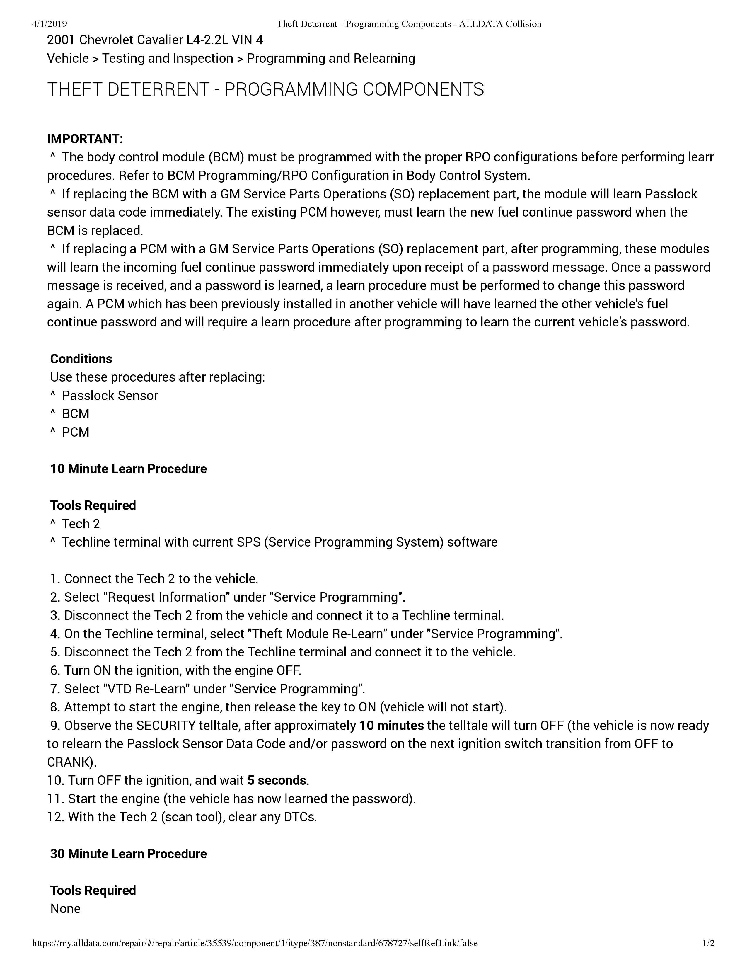

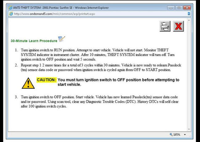

Hey TEIGHLOR LOVE,
Please see the information attached as to relearn the passlock system.
Did you replace the electrical part of the ignition switch or the key and lock cylinder?
If following the instructions below you may need to attach a battery charger as the ignition has to be left on which may drain the battery during the process.

TEIGHLOR LOVE
  • 10 POSTS
I replaced the key and lock cylinder that has the little black cord with one white cord coming out of it.

I thank you for your help by the way! I will try the thirty minute relearn process when I am off of work. And will respond with an update.

The thirty minute relearn process is the safer way to go.
If you try the thirty minute relearn and it doesn't work i can run you through how to do a battery reset.
It looks like the part you replaced included the PASSLOCK sensor so the relearn should work to get rid of the light.

TEIGHLOR LOVE
  • 10 POSTS
Still no luck, the light never went out during the entire process! :(
Apr 4, 2019 at 1:52 AM
TEIGHLOR LOVE
  • 10 POSTS
Fixed it! I put the new key tumblr in the old key cylinder and sensor. Light is gone now!

Unfortunate that you couldn't get the new PASSLOCK sensor to code to the system.
It should have worked unless the sensor in the new part you had is not correct for the vehicle.
