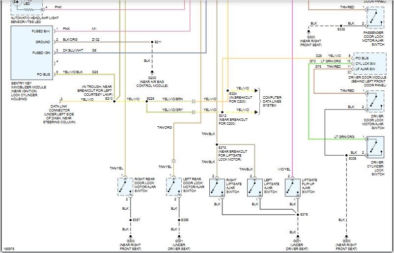

My vehicle is stuck in anti theft mode and want start. what can I do to get it started?
Sep 13, 2020 at 6:30 PM
4DRTOM
  • 467 POSTS

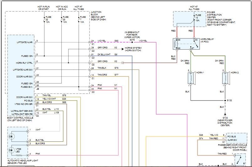

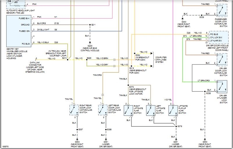

A very common issue with those vehicles is the wring harness in the drivers door jam. the wires in there break usually it starts with the windows not working but the door lock wires run through there also. I would look at that there is a very good chance that you have some open wires in there that are making you anti theft trigger. If you see that all those wires are good let me know a we can go on from there. I attached the anti theft wire diagram as well for you.

A Body Control Module (BCM) is used to control and integrate many of the functions and features included in the Vehicle Theft Security System (VTSS). In the VTSS, the BCM receives inputs indicating the status of the door ajar switches, the driver cylinder lock switch, the ignition switch, the liftgate ajar switches, the liftgate flip-up glass ajar switch, the power lock switches and, in vehicles so equipped, the hood ajar switch. The programming in the BCM allows it to process the information from all of these inputs and send control outputs to energize or de-energize the combination flasher, the horn relay (except vehicles with the premium version of the VTA), and the VTSS indicator. In addition, in vehicles built for certain markets where premium versions of the VTA is required, the BCM also exchanges messages with the Intrusion Transceiver Module (ITM) over the Programmable Communications Interface (PCI) data buss network to provide the features found in this version of the VTA. The control of these inputs and outputs are what constitute all of the features of the VTSS. Following is information on the operation of each of the VTSS features.
