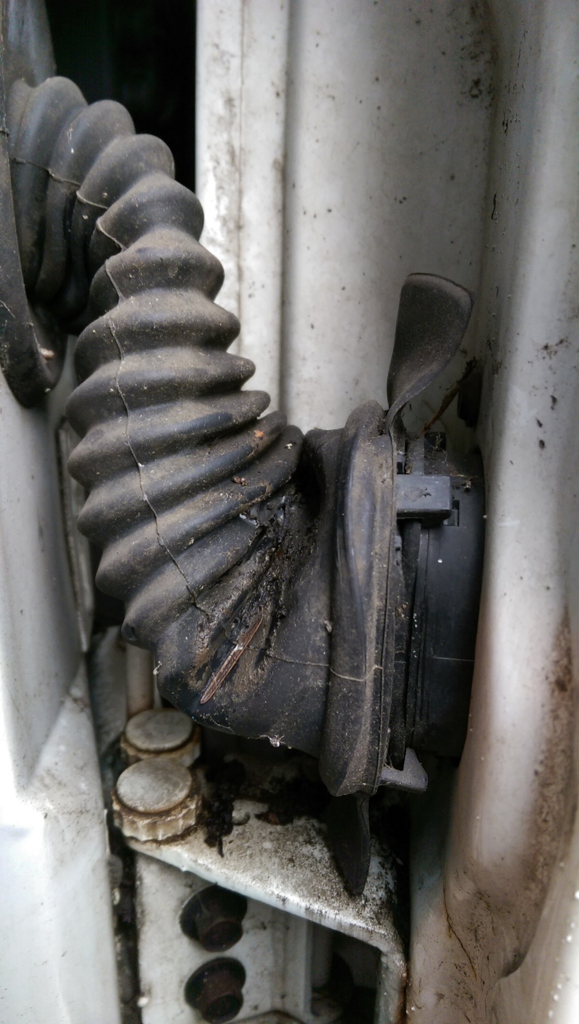

Random Alarm:
My first intro to this was horn honking when doors were opened or closed - horn timed to dome light on and off (delayed dome light off on with passenger door) then two days later, lights flashing and car stereo blaring. Twice in one night.
There are multiple threads on this topic and it appears to be one of many Jeep weaknesses. I luckily found no severed wires in the door boot, but did find the boot was not secured and several wires have cracked insulation. The section from the drivers side is supposed to fit over the boot from the door side keep all the wires comfy and dry. It was not sealed in my case, so rain water from the drives door moulding was pouring right into it. BTW, securing that boot is impossible ( I still cant do it) possible due to the age of my car (22+ years) so my trashy duct tape fix will have to do for now.
