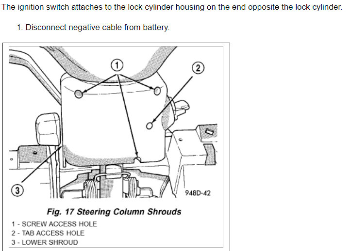

Thank you. The car would not start before I went to the hospital. I fully charged the battery last night. When I get back from church I am going to see if the automatic shut off relay is good. If not, I will remove the steering column cover and check the ignition switch, and the ignition actuator. The pin going into the switch is probably worn or broke.

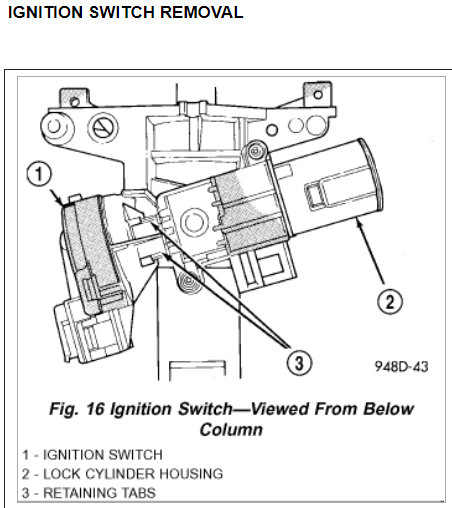

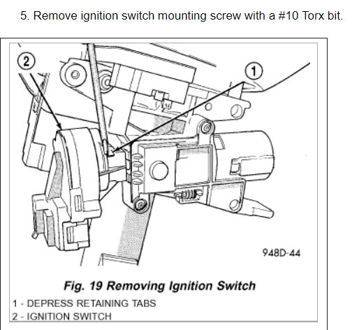

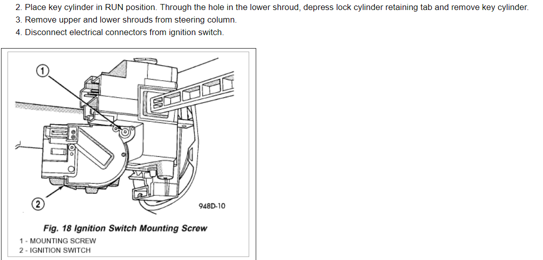

Here are diagram to help you change the tumbler and ignition switch out. Check out the diagrams (below). Please let us know what you find.
