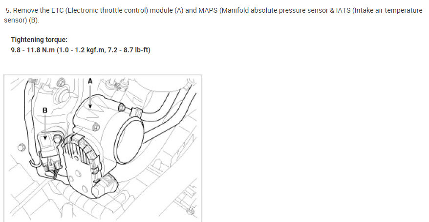

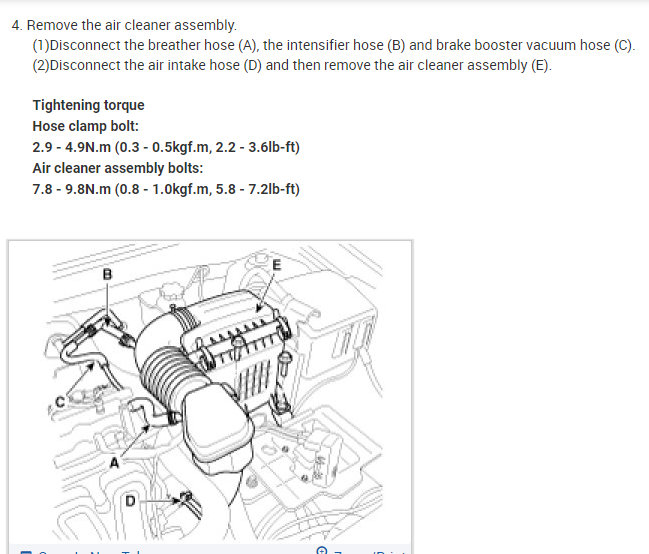

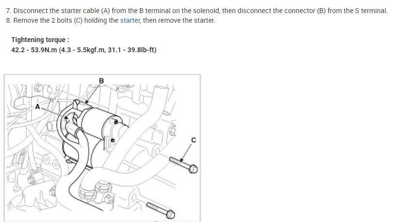

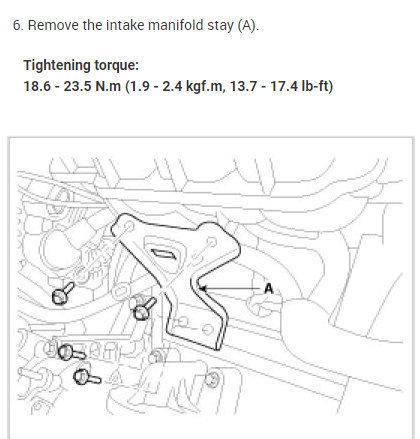

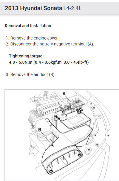

You might be having an issue with the starter motor solenoid. The solenoid is what engages the starter motor. Here is a tutorial showing its operation and replacement:
https://www.2carpros.com/articles/how-a-starter-and-solenoid-works
Most auto parts stores will test the starter motor for free. I've attached picture steps below for removal and installation of the starter motor for your vehicle. Hope this helps and thanks again for using 2CarPros.
Danny-
