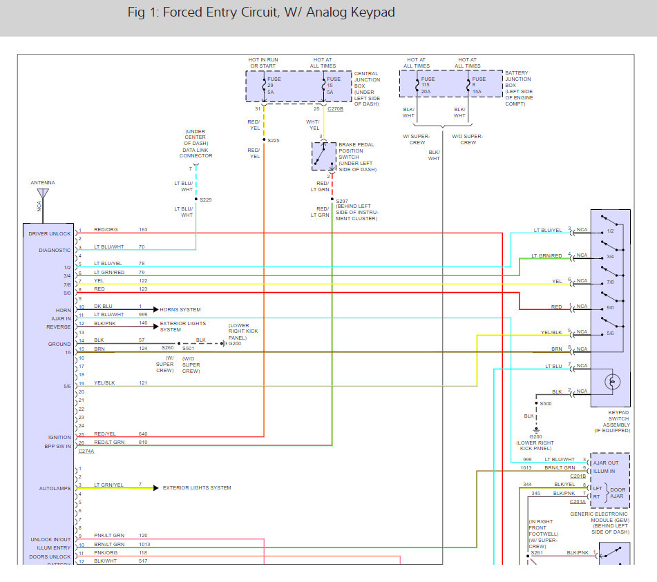

I believe that my Anti-theft system has been triggered and I have done everything I can possibly think of to fix it, including disconnecting battery to changing and checking fuses.How can I reprogram the receiver/transmitter?I have original keys to the truck with no damage to them.
Jan 18, 2021 at 6:06 PM (Merged)
  • 54,832 POSTS
Use the key to lock and unlock the drivers door should deactivate the alarm.
Here is a guide that will help you.
https://www.2carpros.com/articles/how-to-reset-a-security-system

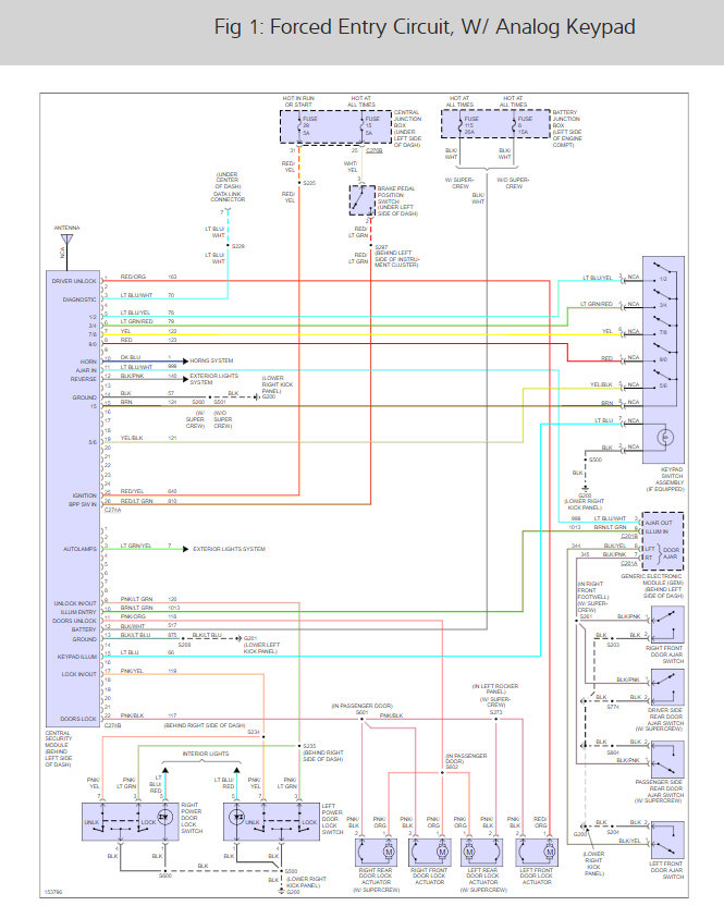

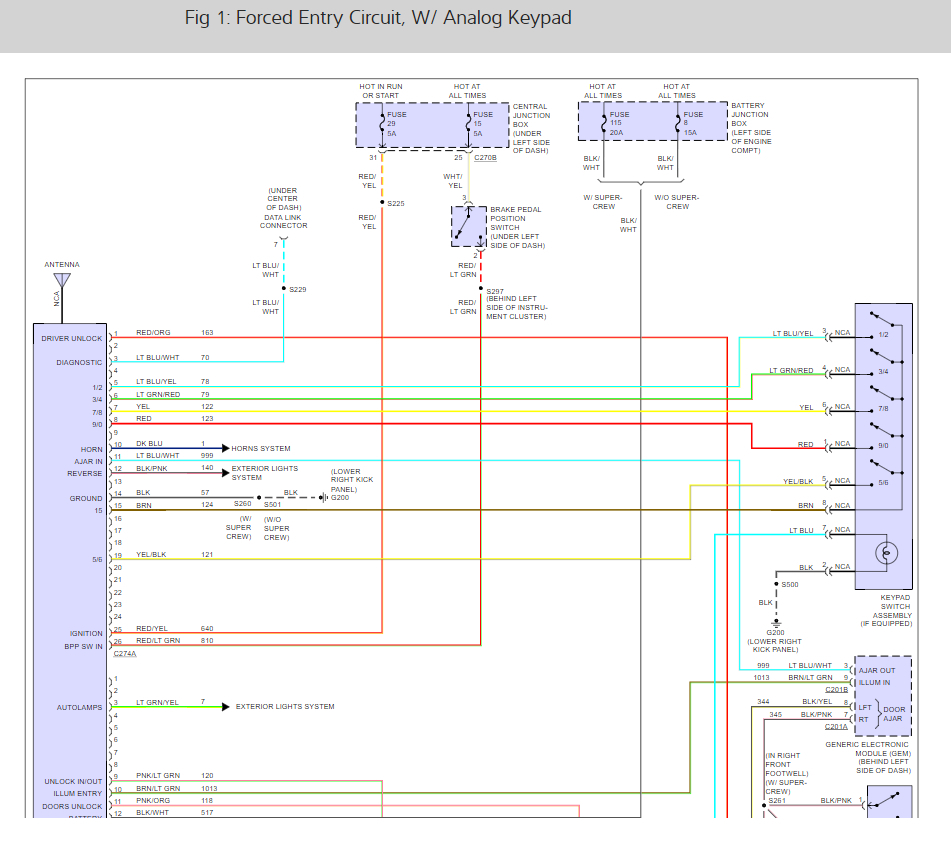

I have also seen where the drivers side door latch micro switch for the security system goes out and will no allow the security system to be reset.
Here is a guide to help you test the connection.
I will include the security system wiring diagrams (below)
Here is what the book says:

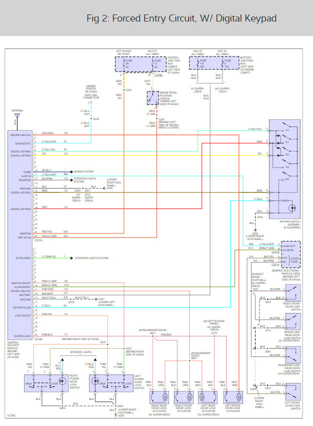

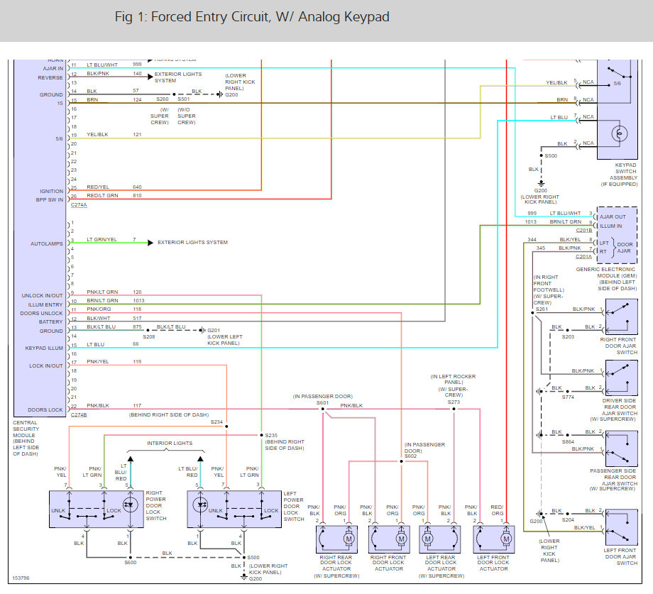

  • 54,832 POSTS
It sounds like the security module is going out not holding the program. Here is a wiring diagrams you can see how the system works. (below)
Here is information the book has to say.
Note: The Passive Anti-Theft System (PATS) module must be reconfigured upon replacement of the instrument cluster. Refer to the diagnostic tool help screen on the configuration card to program.
