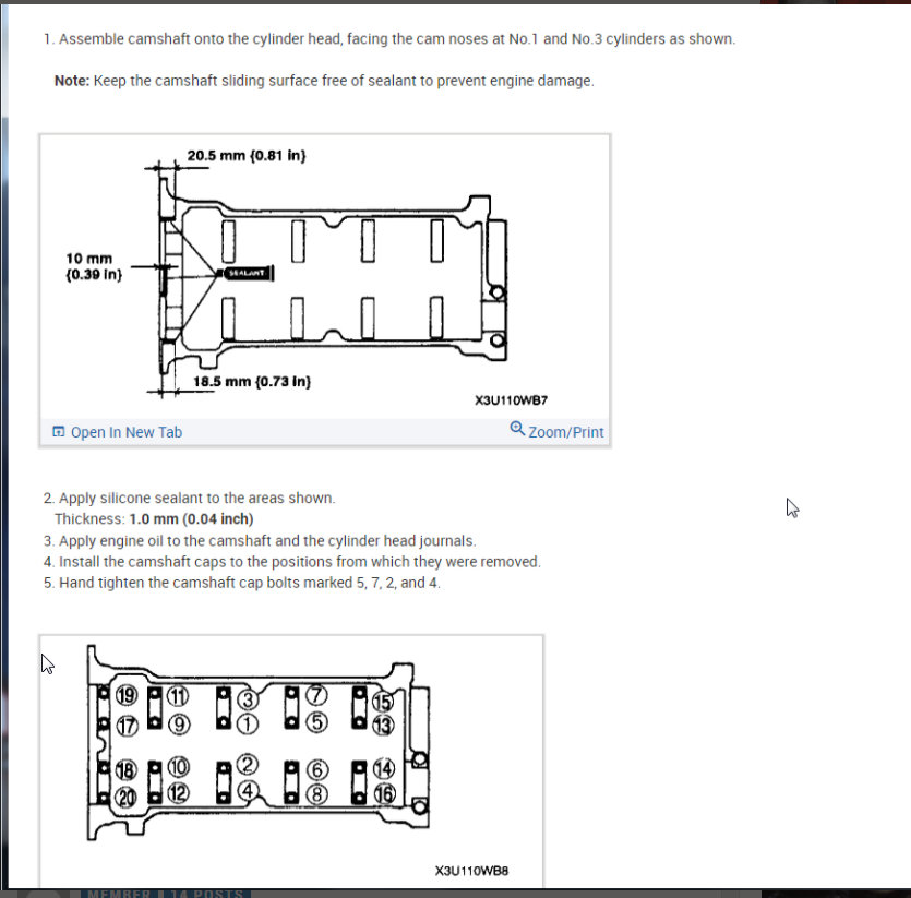

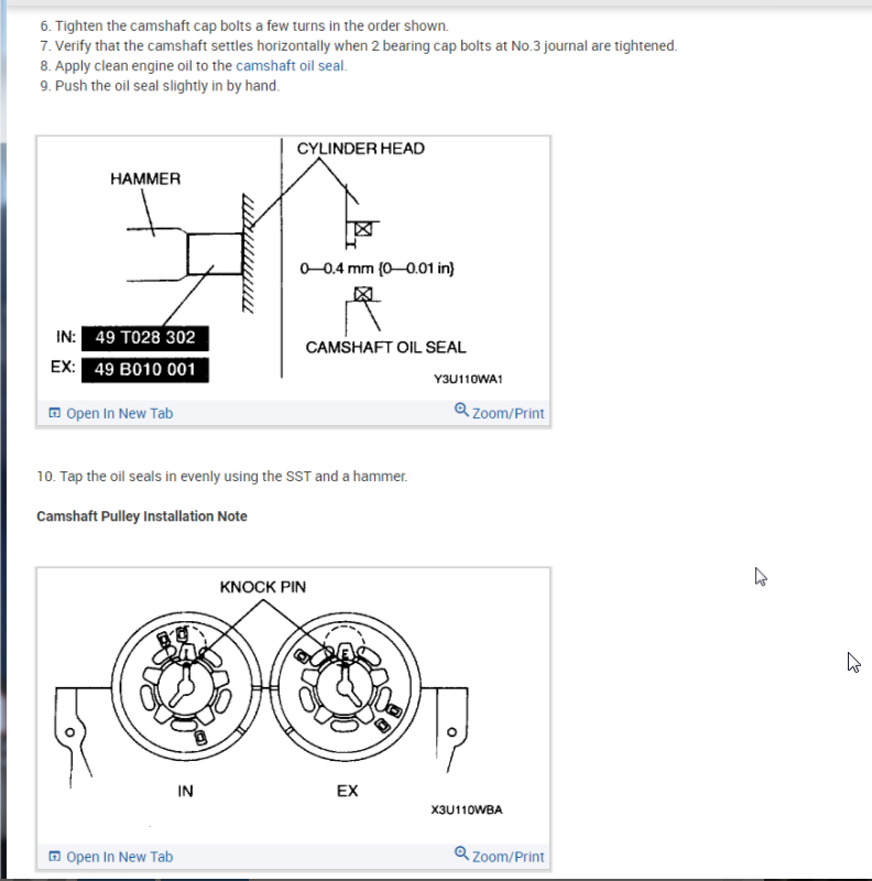

Crank no start issue
I am not aware of any special tools that you will need other then a engine support of some sort that is shown in the last attachment. I am attaching the process again below for you to review.
