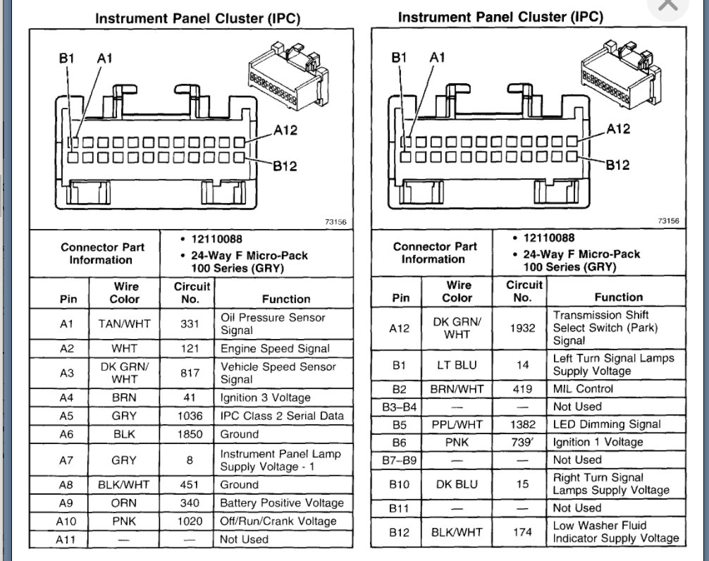

I added an extra ground to a6 no difference. I got a rebuilt cluster no difference.

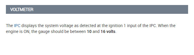

Just to jump in the volt meter on this cluster is just displaying the voltage that it gets on the ignition 1 feed which is pin B6. Can you turn the ignition off and back probe this wire and see if you are getting any voltage on it? You should have 0 volts when the key is off.

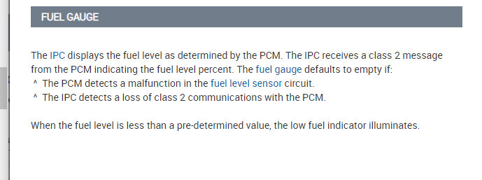

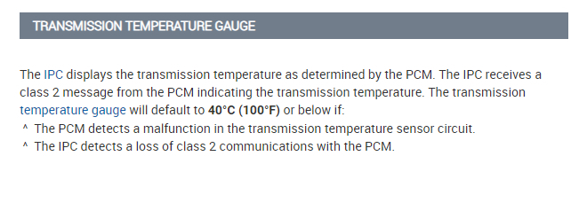

As Joe mentioned before, if you have an issue with the fuel and trans temp gauge as well then those are what are called Class 2 bus messages. This means this is a coded message from the PCM to the cluster and the cluster displays the message after it decodes it.
So if you are getting these gauges fluttering when the ignition is off then we have something backfeeding through the cluster or voltage from another place.
