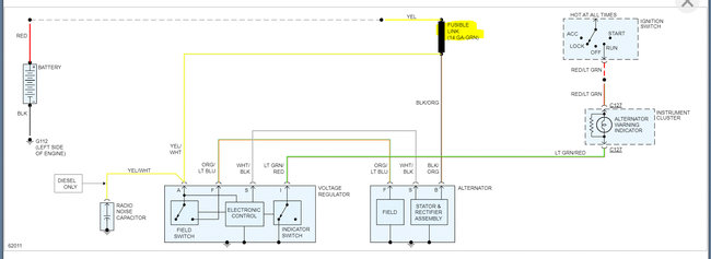

Replaced the alternator. Had to clock it. Not charging battery. Battery had drained before replacement. Battery charged on battery charger.
May 4, 2022 at 7:13 AM
  • 110,248 POSTS

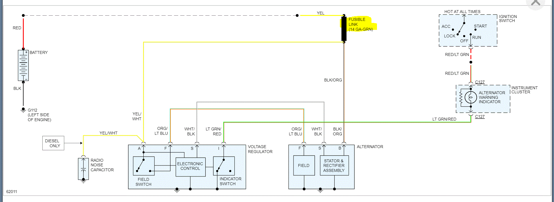

If the new alternator isn't charging, the first thing I recommend is to check the fusible link between the alternator and the battery.
A fusible link, in this case, will look like a traditional wire, but it functions as a fuse. If shorted, it will melt down internally. So here is what to do.
I attached the wiring schematic below for the charging system. I highlighted the fusible link. Disconnect the battery first and then check for continuity between the black wire with an orange tracer and the positive battery terminal (not the battery).
