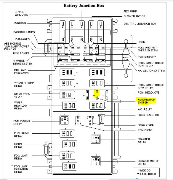

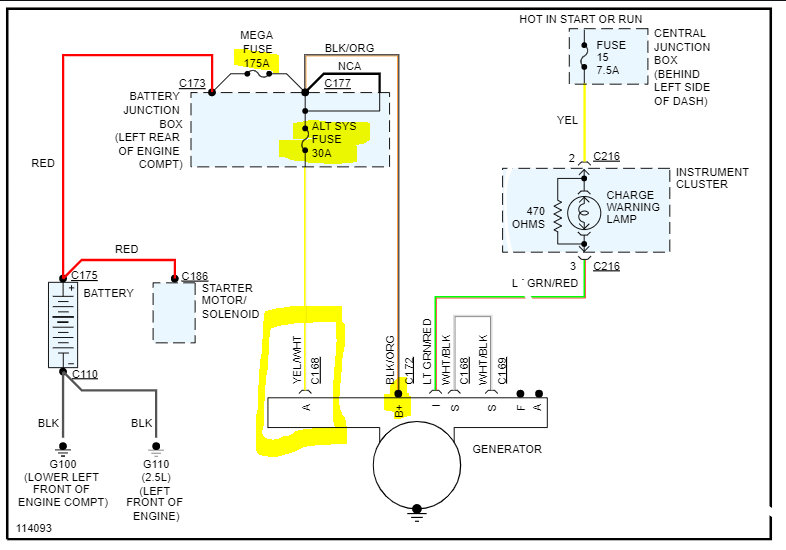

I've already replaced it with a new one twice. I checked the big fuse up under the hood by where the relays and fuses are cleaned it all up. I have continuity between it have continuity between the black and yellow wire to the battery positive, but I've got no voltage to the yellow and white wire on the alternator. I think I'm supposed to have voltage there is anybody know.

The yellow and white wire should have power. It is powered by a fuse in the under-hood fuse box.
I attached a wiring schematic below of the circuit, so you have a reference.
Recheck the alternator system fuse in the under-hood fuse box. In addition, it is important to confirm there is power to and from the fuse.
See pics below. Note: Pic 2 shows the fuse location that I referred to above.
