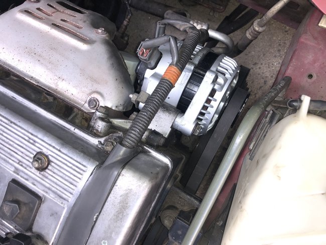

Hello, we have replaced the alternator on my car, but as we tried to tighten the bolt that tightens the timing belt, the belt was not tightening like the videos we have watched said, and the bolt also snapped. now we are unsure of what to do apart from buy a new bolt and try again. We would like to know how to put tension back on the timing belt so I can start driving my car again.

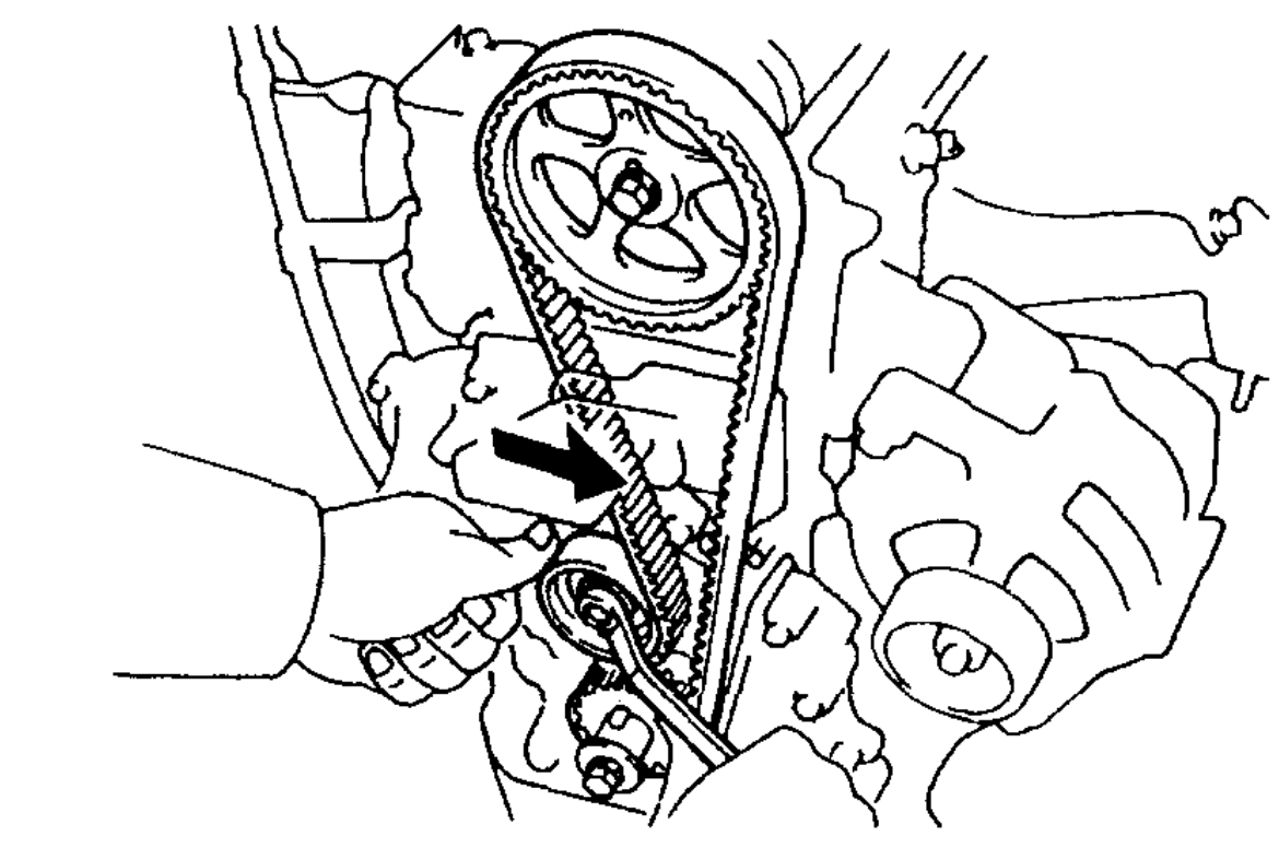

The tension-er is mounted on an eccentric. Pushing it clockwise from the left should tighten it. The spring should take up most of the slack put you will need to push some. A short pry-bar will add enough tension. If the tension-er is not going left to right in a rising arc you need to replace it. I'll post an image below on how to push it.

It’s the belt that is connected to the alternator it has no tension.

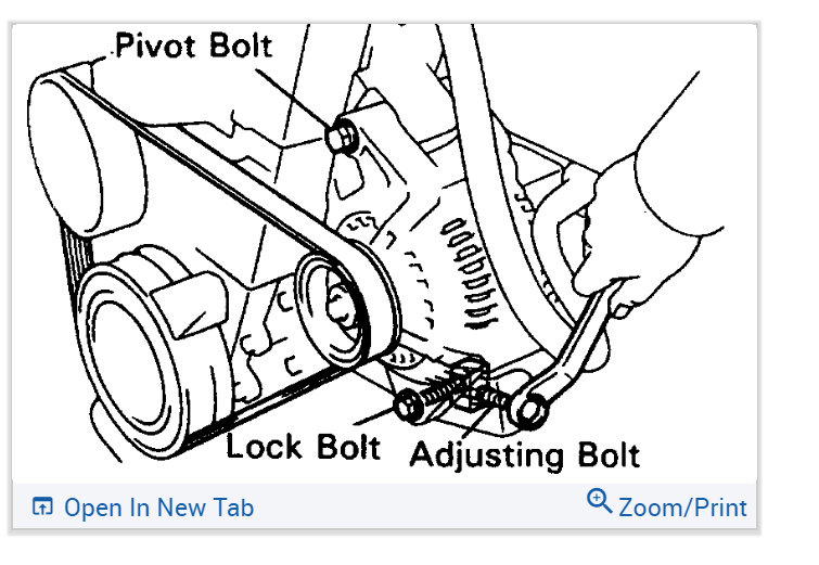

Thanks, what you need to do is loosen the pivot bolt and lock bolt then turn the adjusting bolt clockwise to tighten. Once the belt is tight you may tighten the lock and pivot bolt. I'll post a picture below.

So do we have to tighten the adjusting bolt first before tightening the other bolts for the belt to get tight?
Mar 18, 2019 at 9:04 PM
KENW1
  • 213 POSTS
Yes, the other two bolts must be slightly loose so the alternator will move will you tighten the adjusting bolt.
Mar 18, 2019 at 9:05 PM
LP08820
  • 5 POSTS
Okay, thank you. I will try and do it another day as we need to buy the bolt again as it snapped, but I will Let you know how it goes. thanks for the help!
