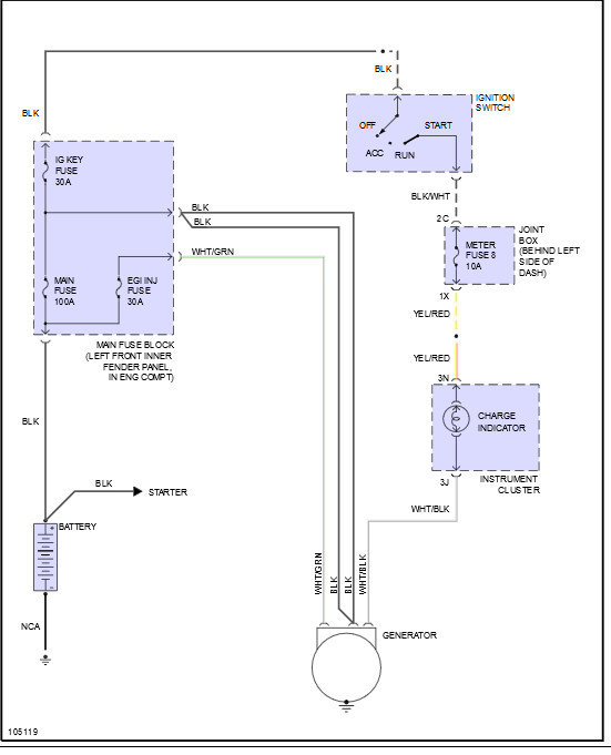

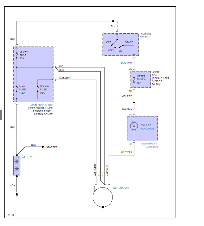

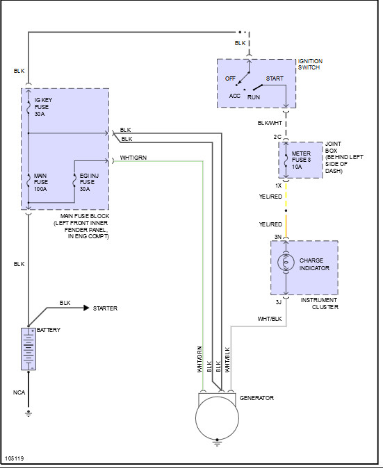

No, the ECU does not send any signal to the charging system. As I stated before, the ECU plays no part in the charging system circuit. Check the diagrams below to see for yourself

This vehicle has no connection between the charging system and the ECU as per attached wiring diagram. The regulator is internal to the alternator, not the the ECU.
