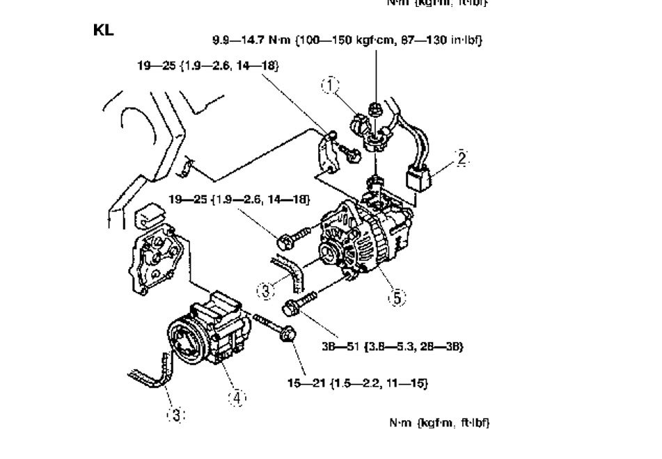

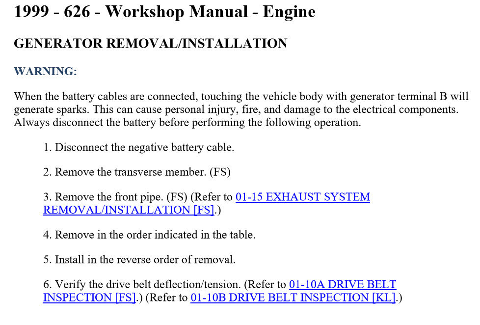

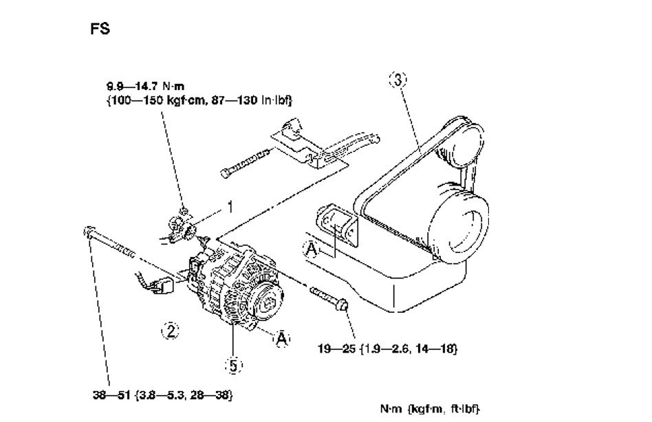

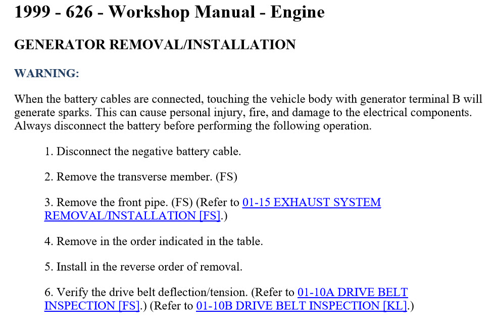

see pics one is for no a/c other has a/c we have no instructions for removing front pipe
