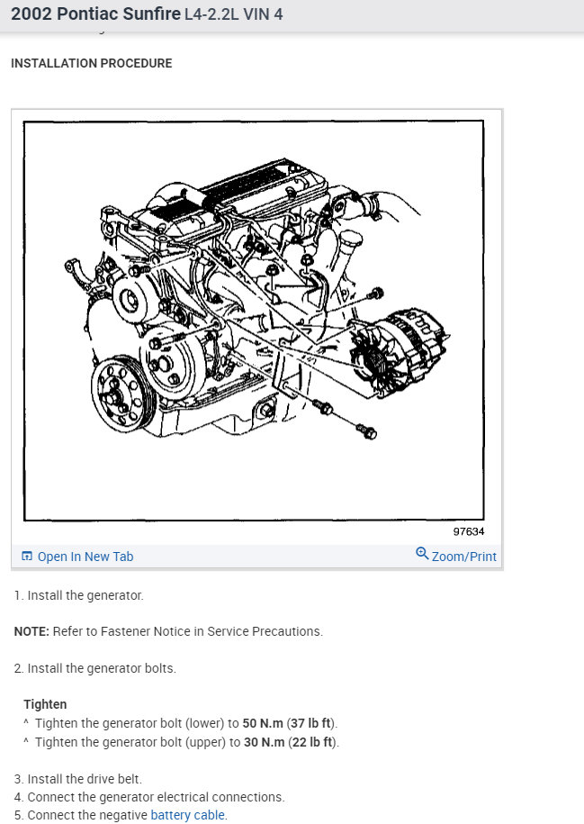

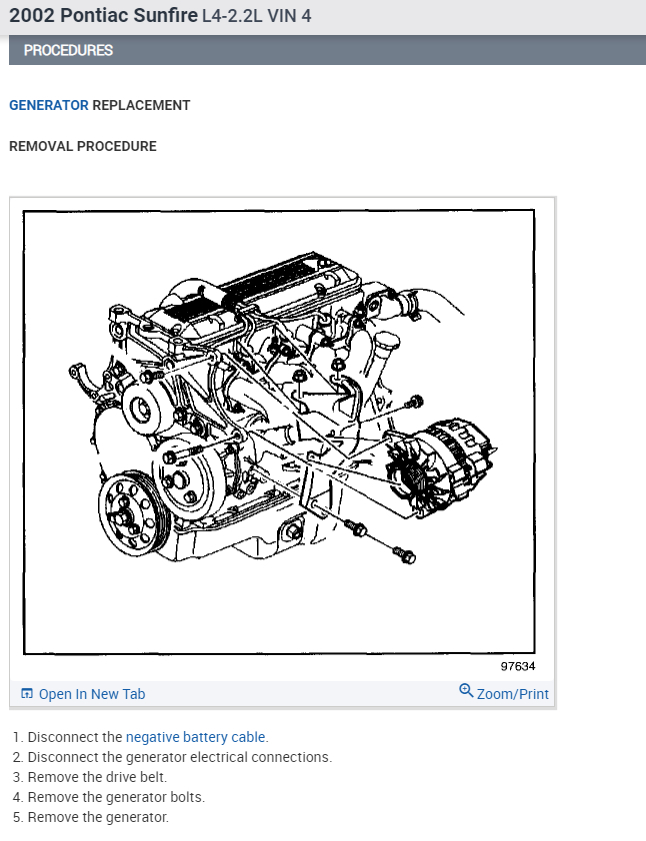

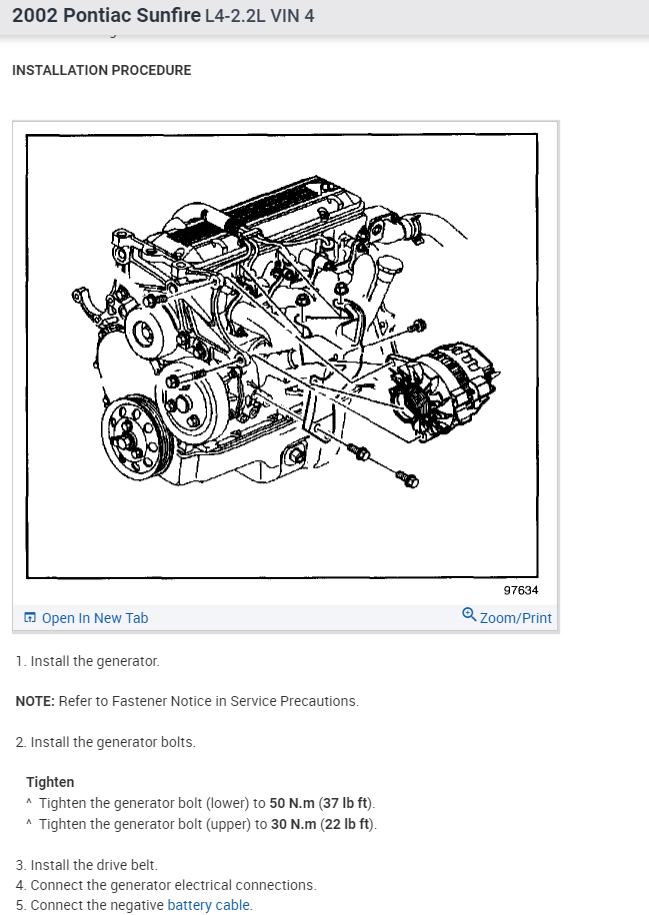

My alternator seems to not be charging my battery because I have to charge my battery with a charger and then it only runs for like 10 minutes before it drains. I've tested and there is 11.8 volts coming from the alternator. I haven't tested the wire at the battery yet because the wire goes up behind the engine and disappears so I can't follow it and I can't seem to find a diagram for it.

It sounds like you have a bad alternator.
You should have 13.6V-15.2V from the alternator, as you are only getting 11.8V, it is likely bad.
You can also bench test the alternator to make sure that it is indeed faulty. Most auto parts stores have bench testers for alternators. You will simply have to remove the alternator and have them test it.
Here are a couple of helpful guides:
https://www.2carpros.com/articles/how-to-replace-an-alternator
Let me know of any questions.
