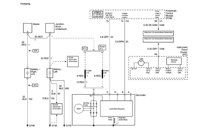

Battery not being charged. Power at battery plus alternator side. No power on three excited wires. What's proper procedure for checking system? Unable to locate alt. Fuse or relay. Due to no information. Computer controlled alternator 145 amp alternator.

I attached a wire diagram for you to view.
What is the voltage at the battery with the engine running? the PCM does control turning the alternator on and off to maintain the battery charge.
do either of the little wires at the alternator have any power with the engine running?
