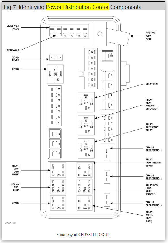

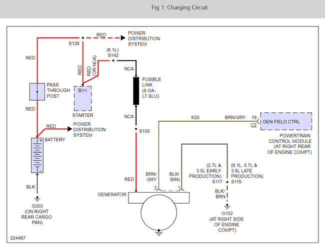

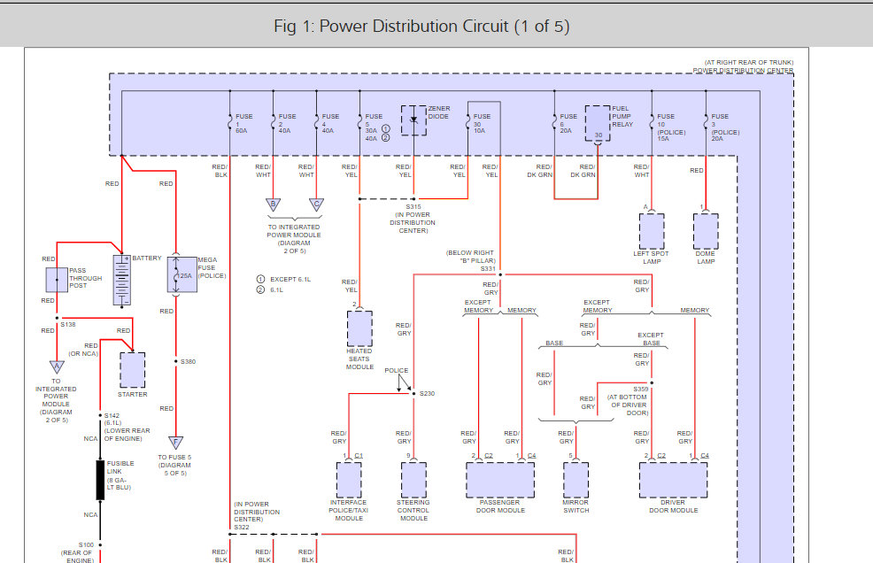

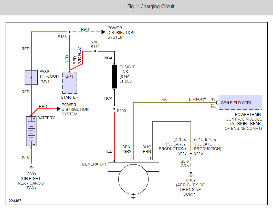

It sounds like the PCM is not working or the power inputs are missing. Here is a wiring diagram so you can see how the alternator is wired and the PCM fuses so we can check those as well:

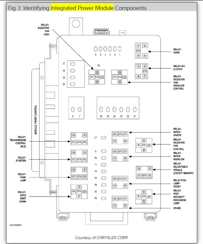

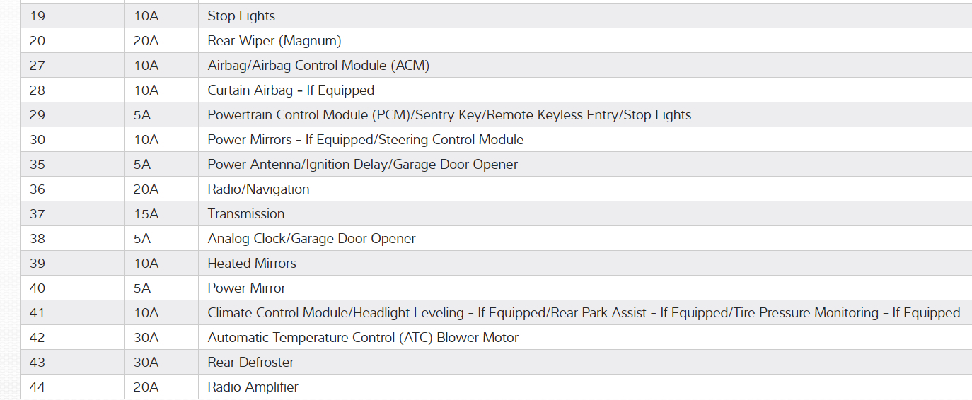

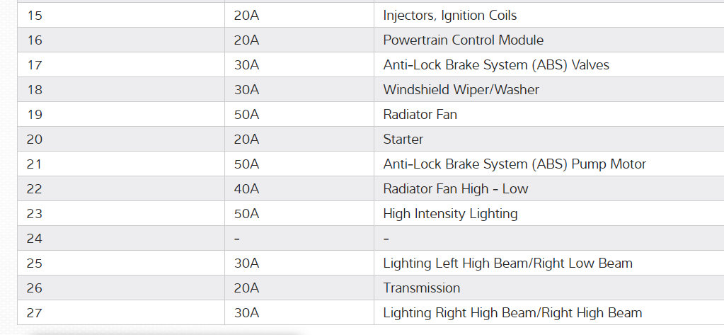

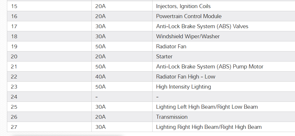

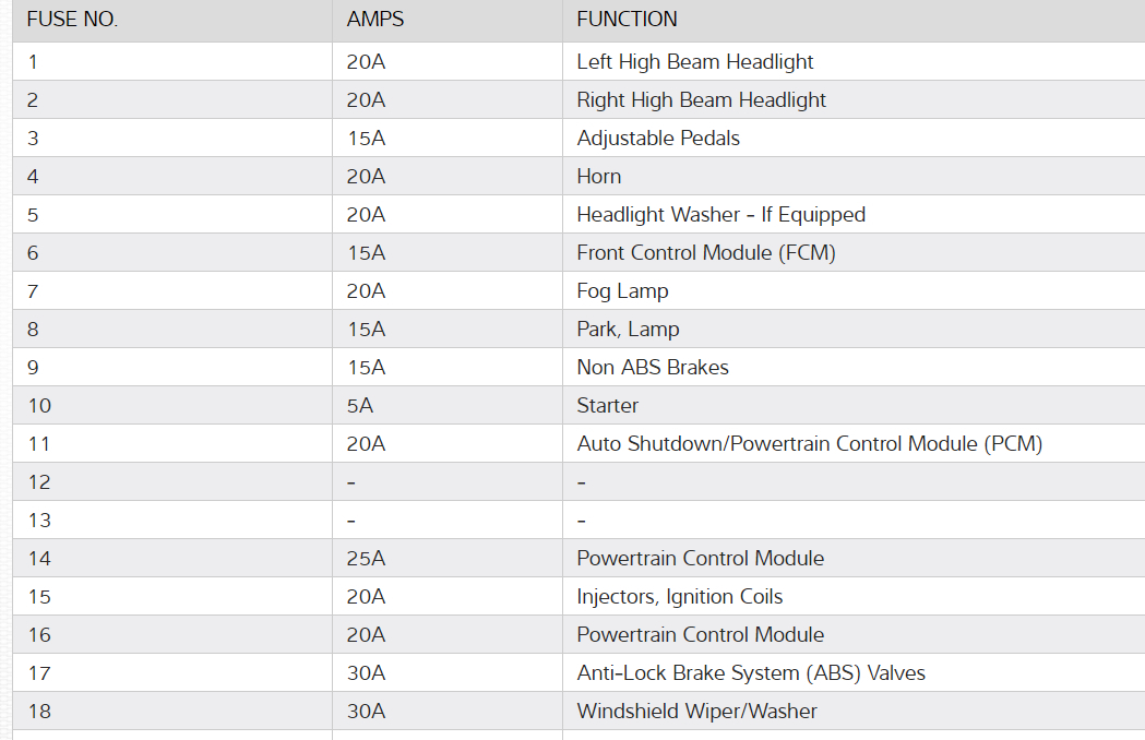

Check fuse #8 15 amp here are the fuse locations. With the key on make sure there is power at the fuses.
Check out the diagrams (below). Please run some tests and get back to us.

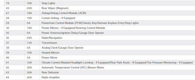

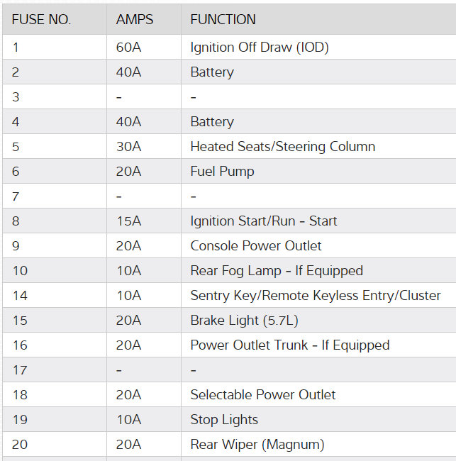

Okay Ken, here are the results from the fuse tests: (used a test light). Checking rear fuse box fuses with ignition on but engine not running, #8 15 amp fuse good, #29 5 amp fuse good. Oh just so you know I check both sides of all fuses for power. Front fuse box fuses with ignition on but engine not running, #6 15 amp fuse good, #9 15 amp fuse good, #10 5 amp fuse no power to fuse but fuse fine, #11 20 amp fuse good, #14 25 amp fuse no power but good when engine is running, #16 20 amp fuse no power but good when running, and #17, #20, #25, #27 fuses all good. So the red flag award goes to #10 5 amp fuse(power-train control module/starter) with no power going to fuse whatsoever. And for #14 and #16. I assume they are supposed to receive power when engine is running but not when engine is not running. So how should I go about fixing this? Ken, I appreciate you helping me trying to resolve this issue, thank you very much! Karl

#10 says it is for a police version of your car here is the power distribution diagram so you can see. Can you do me a favor and using a test light can you see if the main charge lug on the alternator has power?
Check out the diagrams (below). Please let us know what you find.

No power at all at the main charge lug on the alternator.
Jun 19, 2018 at 4:25 AM
  • 55,433 POSTS
You found the problem, there should be power there at all times check the fusible link and look at the alternator wiring diagram above. Let me know what you find upload pictures of the problem would be way cool for anyone else that has this problem.
