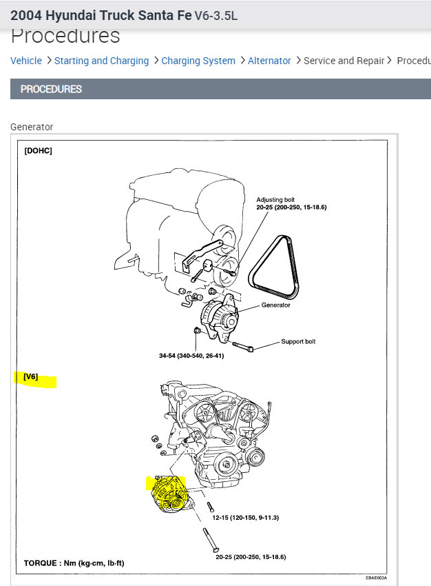

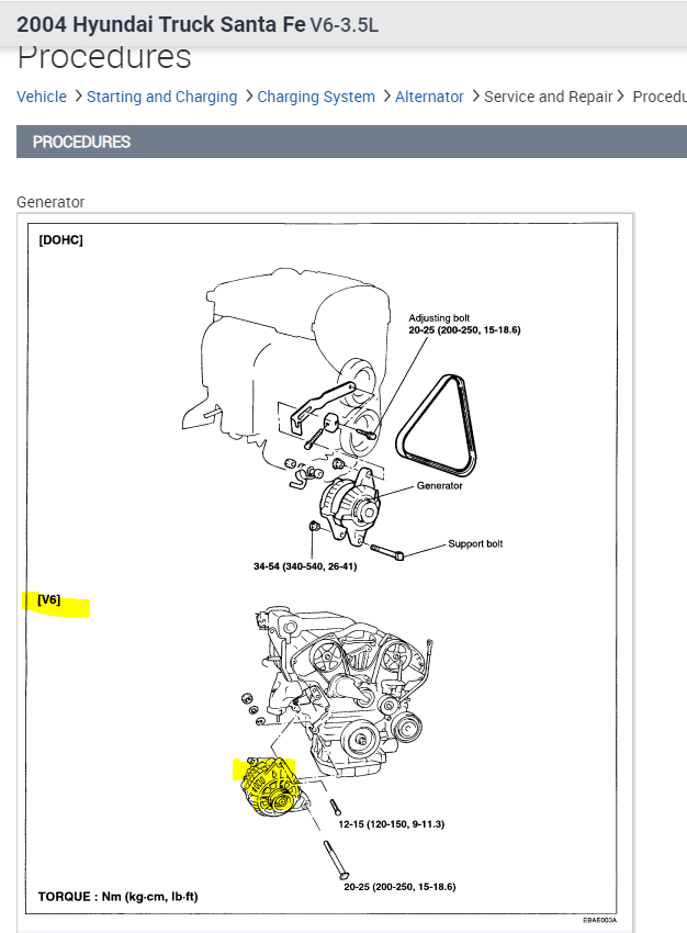

I am trying to replace my alternator on my vehicle listed above GLS and I am having trouble locating it.
Feb 1, 2022 at 2:47 AM
SQM
  • 6,383 POSTS
The alternator is located toward the bottom of the engine. It is right next to the crankshaft pulley.
In order to replace the alternator, you will have to access it from under the vehicle. Which means removing the skid plate. Also, the A/C compressor will need to be removed to get the alternator out.
https://www.2carpros.com/articles/how-to-replace-an-alternator
I have attached a diagram for your reference.

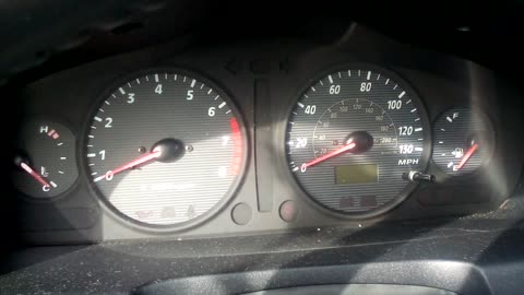

Okay, so, I am still troubleshooting so far, I have a new battery and gas in the car and it's still not trying to start, but it's making the attempt to start by going through the motions.
Feb 1, 2022 at 10:49 PM
SQM
  • 6,383 POSTS
So, the engine is cranking over but not starting?

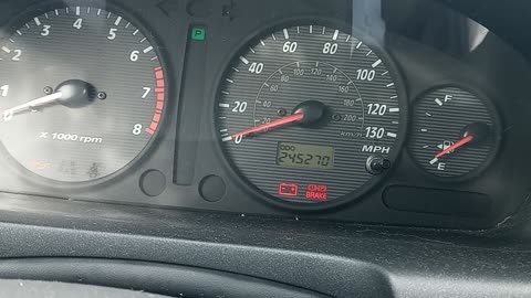

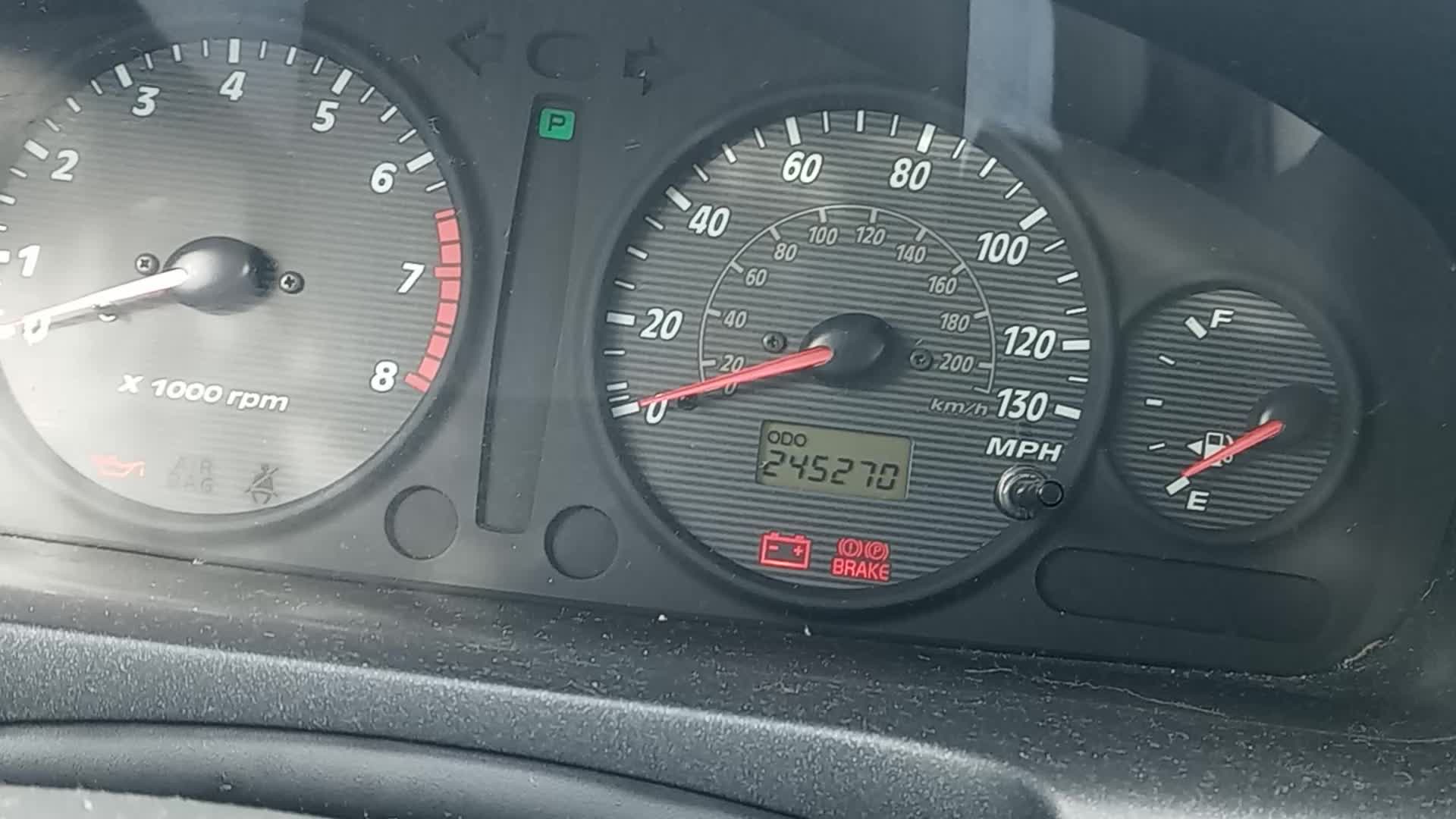

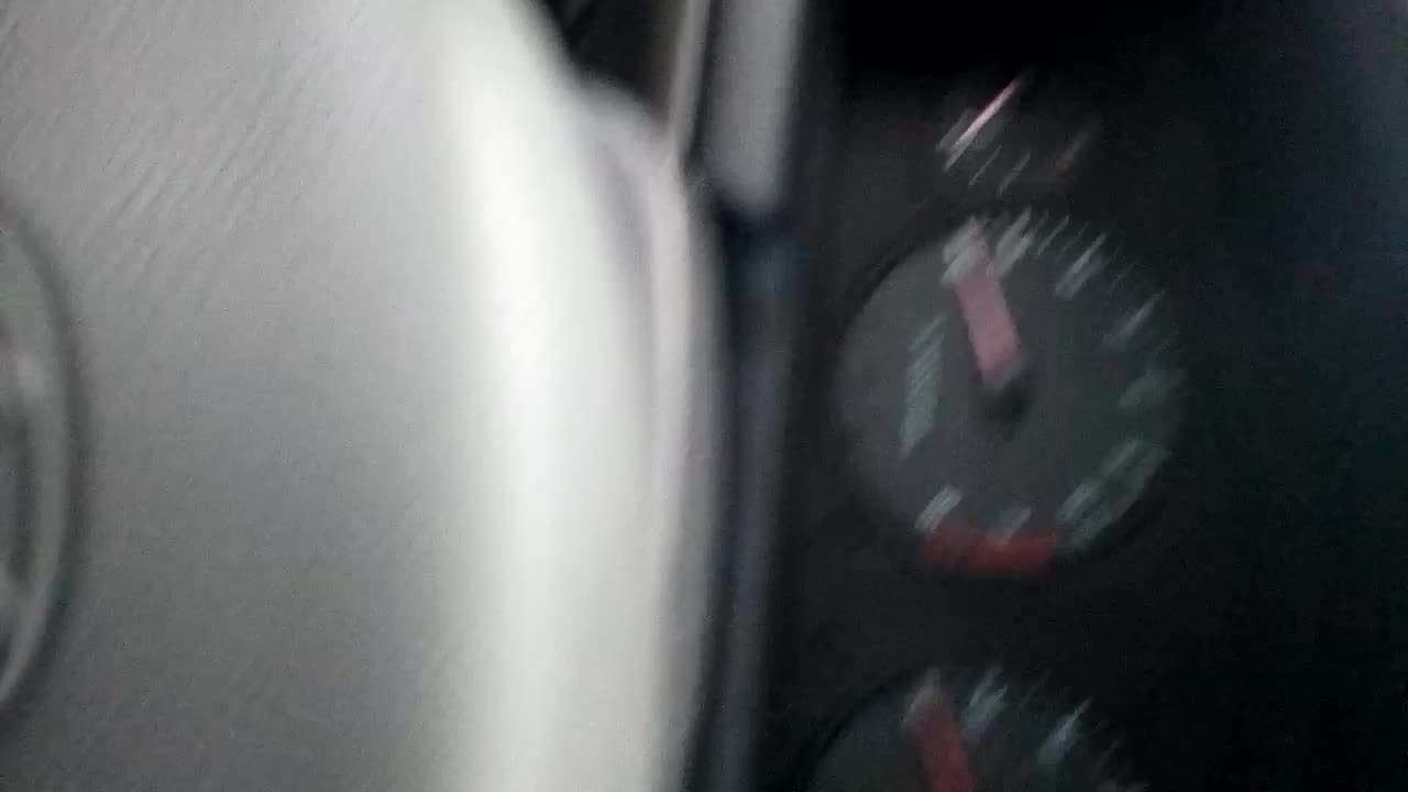

Here is a little video of the car trying to start:
Feb 2, 2022 at 1:02 AM
SQM
  • 6,383 POSTS
Hard to tell from the video if the fuel pump is turning on.
But does the engine actually cranks over? It was difficult to tell from the video. I can see the lights flicker on the dash, but the noise did not sound like it was cranking.
Feb 2, 2022 at 1:28 AM
JUDIE_SIMMONS
  • 57 POSTS

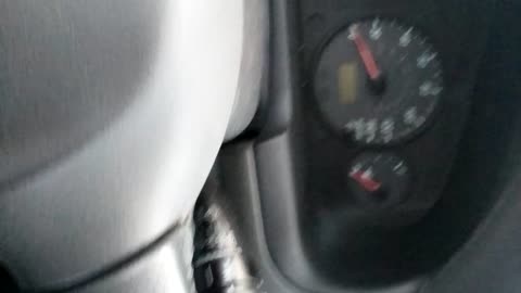

I don't know if you could hear the sounds of the video in the last one, so I had to do it again, is it the alternator.
Feb 2, 2022 at 1:51 AM
SQM
  • 6,383 POSTS
It's almost like there is not enough power.
Did you try to jump start it?
When it is the alternator the engine will stall when the jumper cable gets removed.
Feb 2, 2022 at 3:11 AM

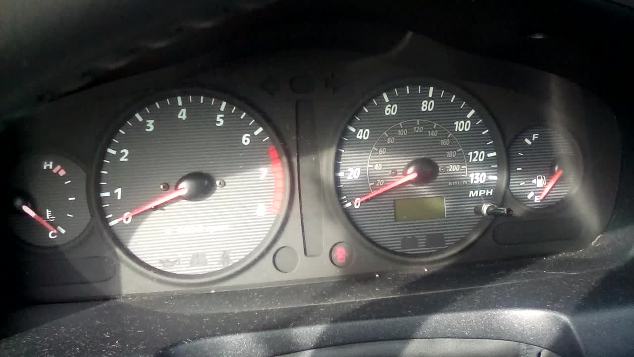

I'm not too sure if the jump starter is working correctly so I'm not sure that I can rule out the alternator from this video what is it sounding like to you.
Feb 3, 2022 at 7:45 AM
