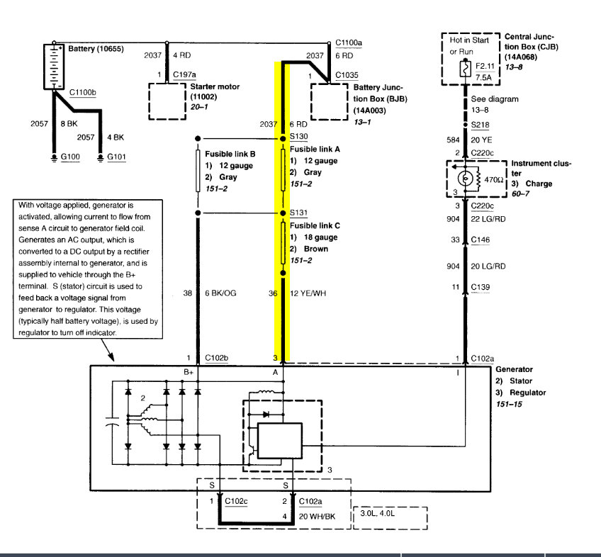

Replaced alternator. yellow wire with white stripe has no power. looking for fusible link or Alternator fuse location.
Nov 3, 2019 at 3:26 AM

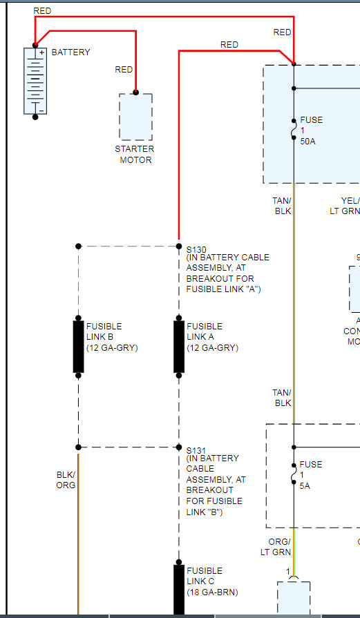

You have two fusible links on that circuit, but I would just go in front of them and make sure you have power. If so then you can run your own wire and put your own links in if you can't find them. However, these are going to be in the battery cable cable and will be broken out so just follow the battery cable and you should find them.

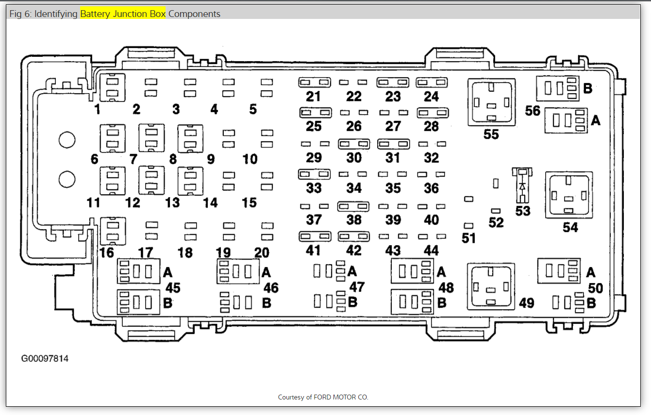

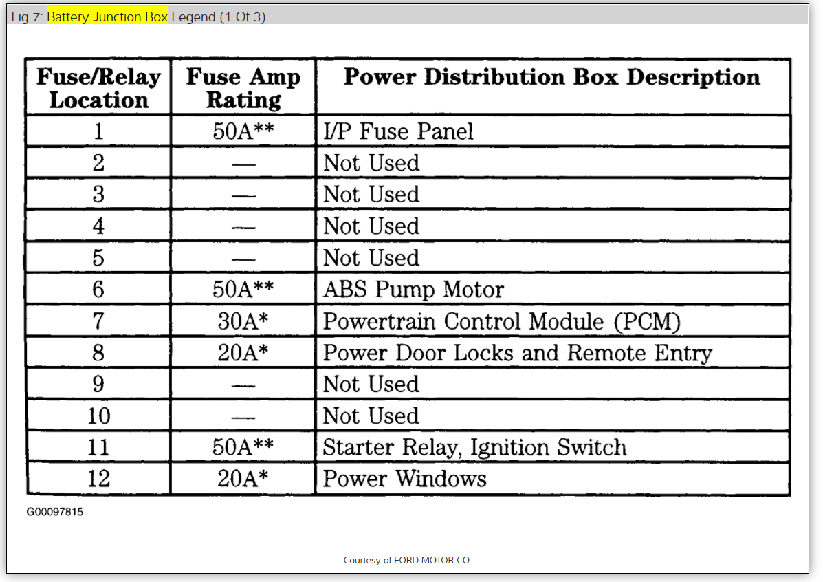

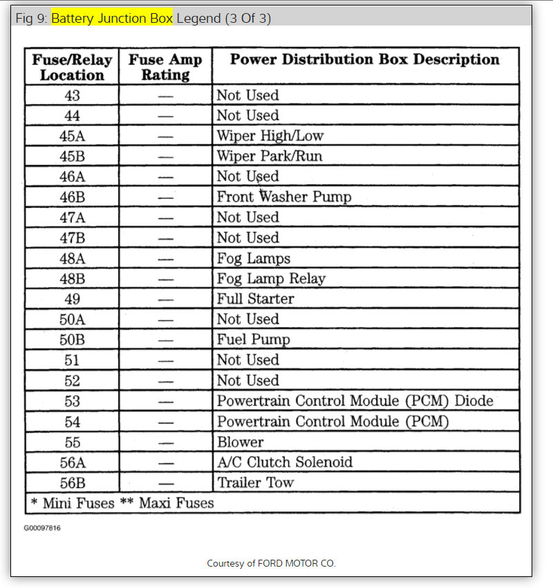

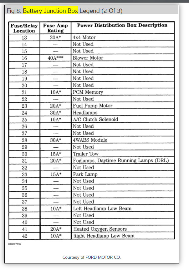

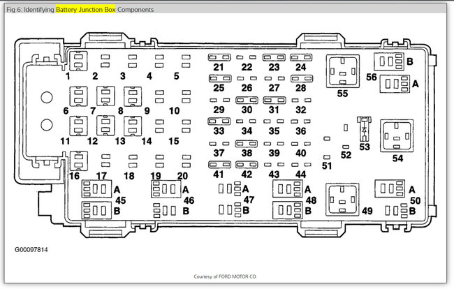

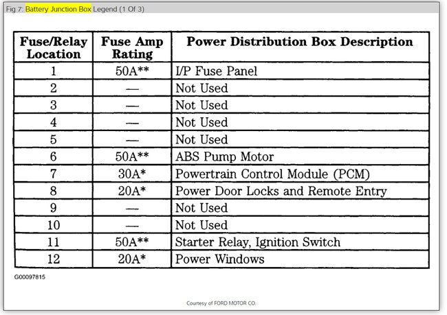

Here is a guide to help you step by step with instructions in the diagrams below to show you how on your car.
