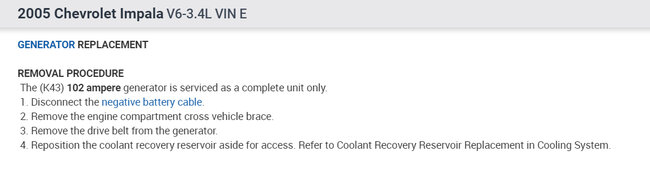

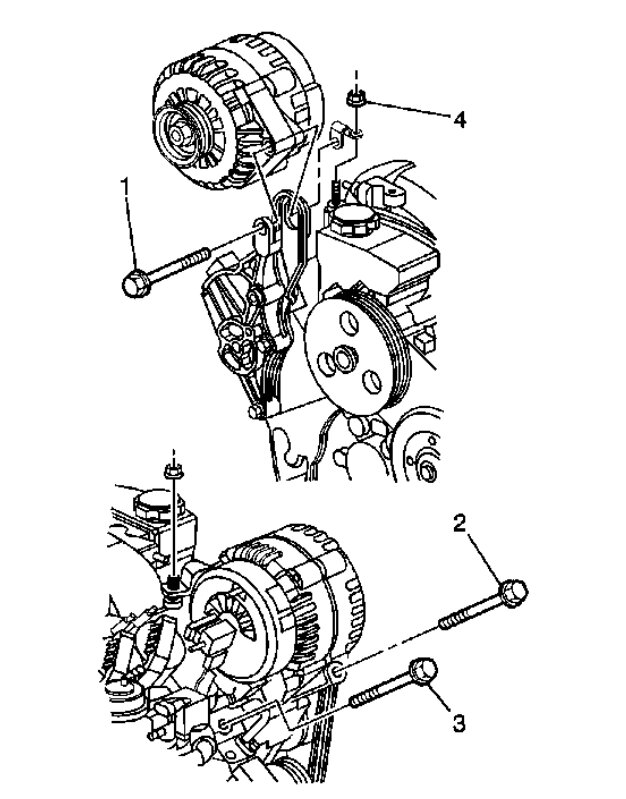

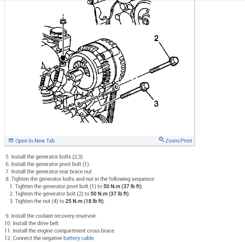

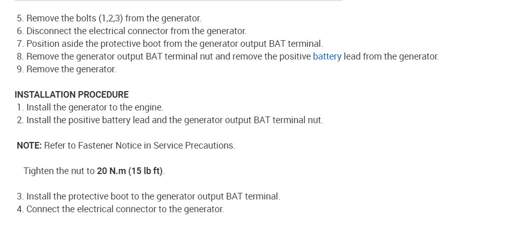

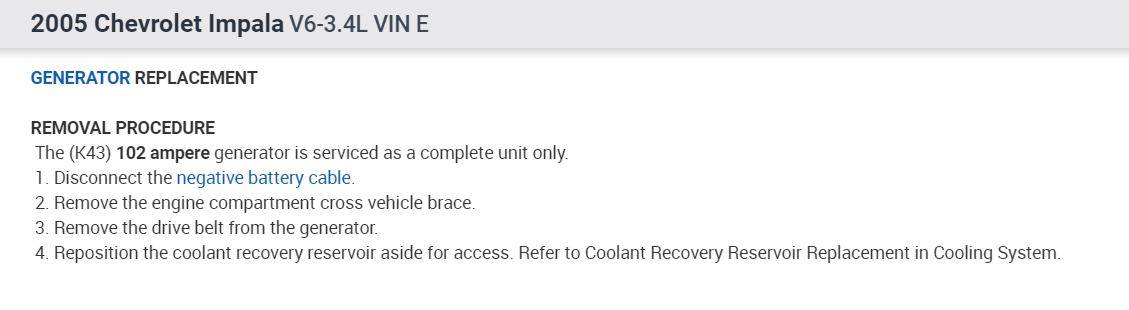

It sounds like the alternator shorted out or you trapped some wires while the engine was being reassembled from the water pump job. Can you upload some images so I can see what's going on? Here is how to change the alternator out for a new one in the images below. I would also recheck your work to make sure the new alternator does not have any problems. Check out the images (below). Please let us know what happens.
