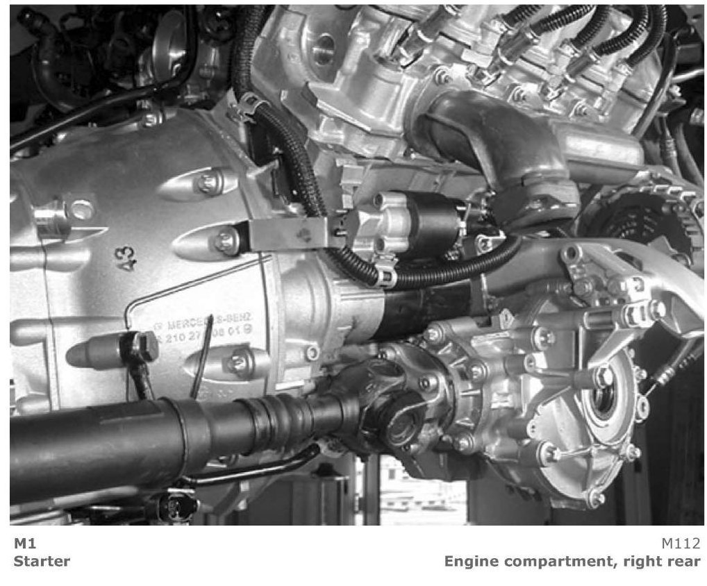

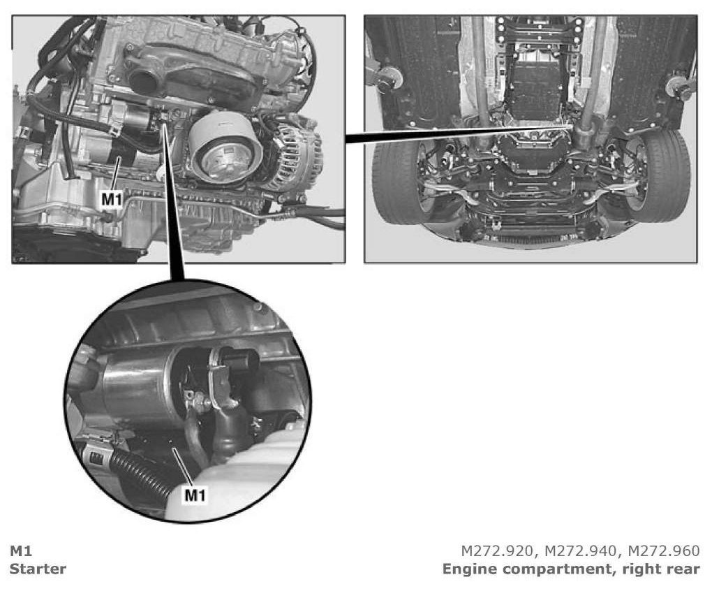

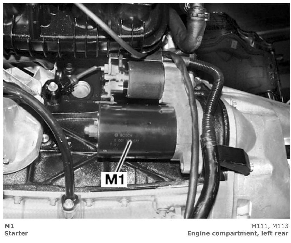

No to the fuse. If the starter engages, it is getting power. I attached 3 pictures below to help you locate the starter. The pictures are from different points of view.
Do me a favor. If you can, record the sound of what the starter is doing. It may help me.
Let me know if you find it.

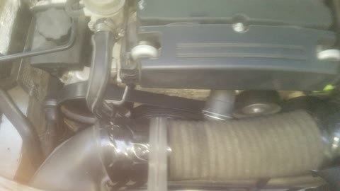

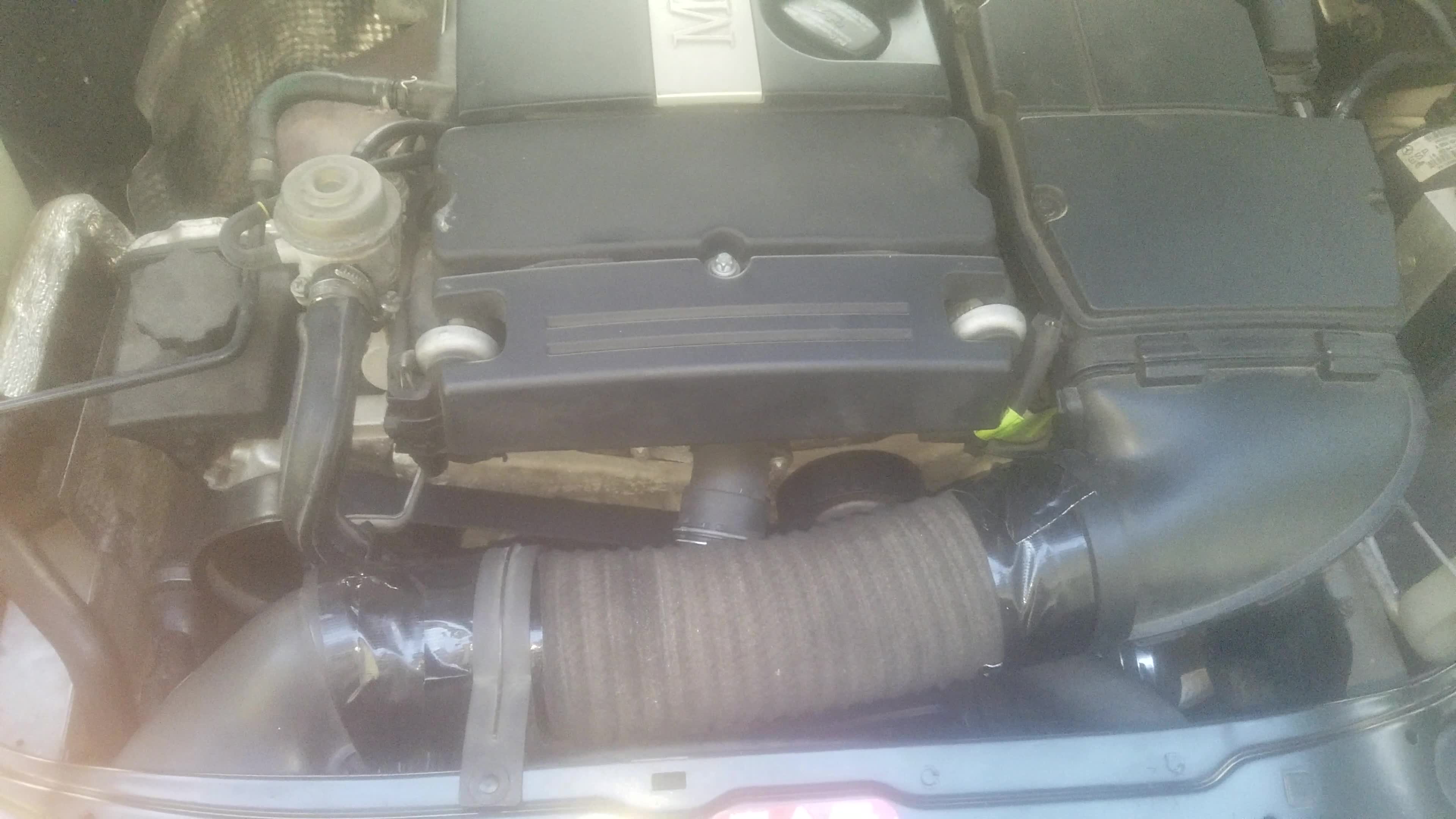

Okay, I was told by someone to try and start it without the belt because he said the belt looked tight. I took the belt off and it started right up. All of the pulleys turned freely without the belt with the exception of the crankshaft pulley. Any ideas?
Sunday, September 22nd, 2019 AT 11:56 AM
  • 109,867 POSTS
Welcome back:
That makes no sense. Tell me, was the AC on or defroster when it wouldn't crank? Also, this vehicle should have an automatic belt tensioner, so it shouldn't be too tight.
The reason I ask about the AC and defroster is because the compressor may be locked up. The AC compressor functions in both the AC and defroster modes.
Even though the pulley may have turned easily when you had the belt off, with the key off, the compressor clutch wouldn't have been engaged so it would have turned.
Sunday, September 22nd, 2019 AT 4:41 PM
M_ZGLINICKI
  • 6 POSTS
So due to me having back surgery several months ago, I am not as able to crawl around on the ground as I used to. My son when he took out the alternator didn't pay attention to which way it came out and I didn't pay attention as he was pushing it up to me. So my Polish blood was working overtime and when we put the new one it, we had it rotated 180 degrees. That will cause it not to turn freely both ways, We flipped it and now it is running and I don't have "steal" the car and light it on fire.
