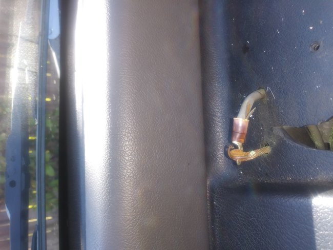

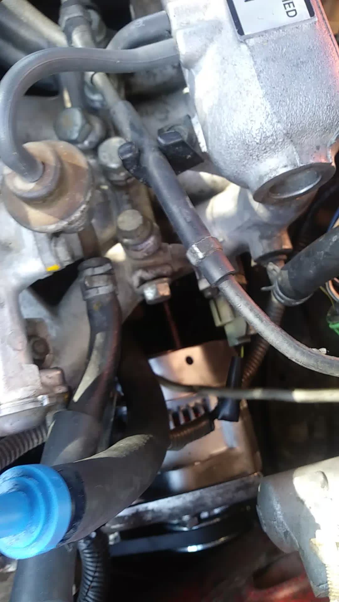

My alternator is bad. While I was trying install the new one I noticed the positive and another wire are going through my fire wall and out the top of my dash. I think they made a ground since that is coming out of my dash. Does anyone know the proper way to wire the alternator or a pictures so I can do it correctly? I am so stumped on why previous owners even did this. The picture is the ground out of my dash I followed the positive wire and another alternator wire to that ground.

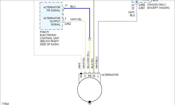

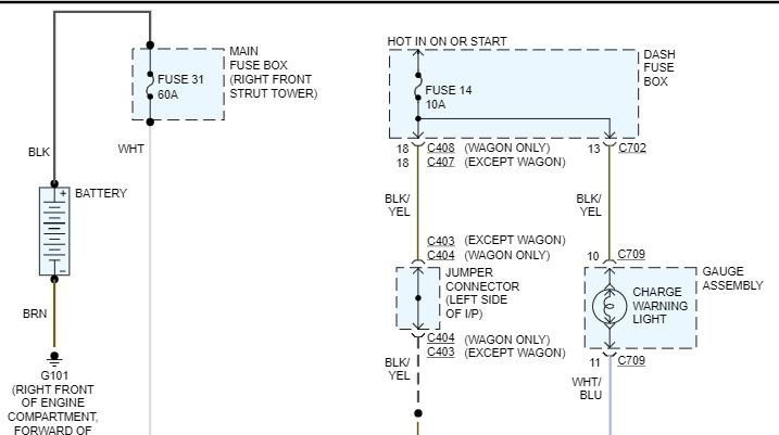

I have no idea what that is on the dash. I pray it isn't anything from the alternator. However, wires do run into the vehicle. I attached a wiring schematic for you to look at. It is the entire charging system. I had to break it into two pictures because of size and so you can read it. Take a look at it. It shows wire color, where they go, and indicates everything related to the charging system.
Here are a few links that you may find helpful:
https://www.2carpros.com/articles/how-to-replace-an-alternator
Take a look through the schematics I attached and see if it helps. Let me know if you have questions or need help. Also, I would love to know what the wires sticking from the dash are for.

The wiring on this car in general is just a mystery. They bypassed the key starter to put a starter button in. I turn the key and push a button to start the car. There is a switch to turn on radiator fan that never worked. Only thing I can think of for that ground on top of the dash was he had a phone charger bolted by it but no wires to it so I didn't understand. The schematics definitely make more sense. I am going to try tomorrow morning redue it.

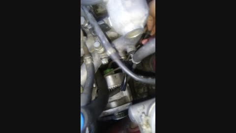

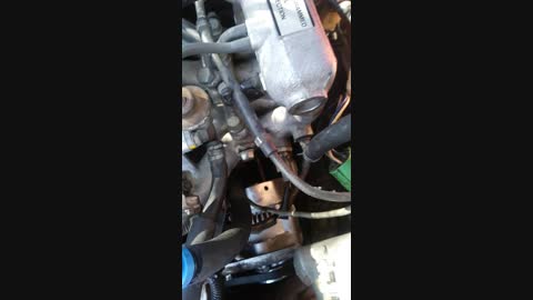

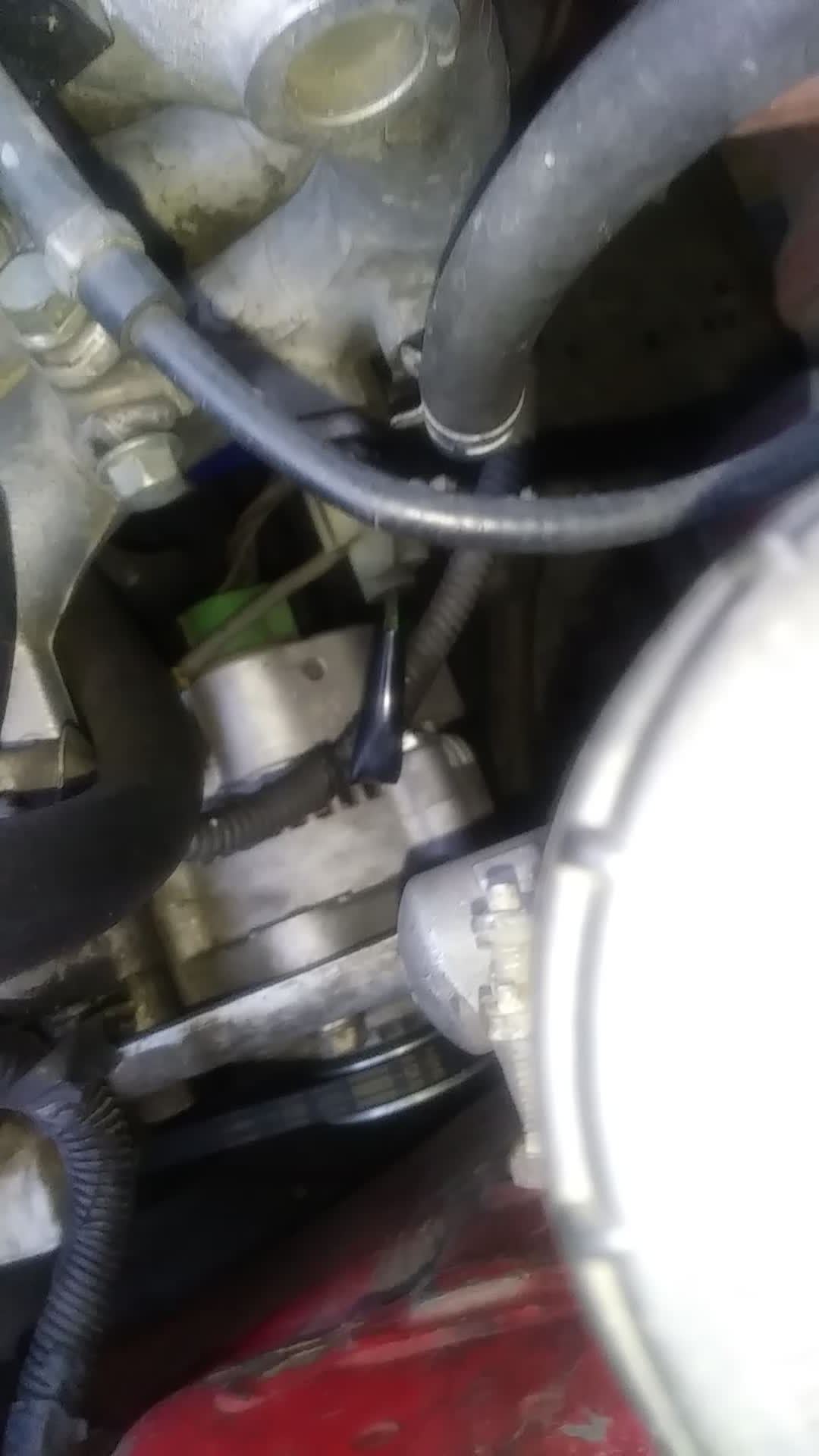

So problem I am running into is just getting the part out. I think the brake booster has been replaced. I cannot get it out on top or even out from the bottom.

I finally got new part in and everything seems working good. The wire coming out of the dash is spliced into the ground wire for the alternator from what I can see all the rest of the wiring is done correctly.

Good job. I'm glad you got it working. I still can't understand the ground wire coming out of the dash. Regardless, let me know if you need anything.

So I went to yank out the mystery ground in my car dash. When I ripped it out now the entire car wont start or click over.
Thursday, February 28th, 2019 AT 2:29 PM
  • 109,885 POSTS
Wow. Do this. Tell me approximately where it is going and the color of the wire. I will look through schematics and see if I can locate it.
