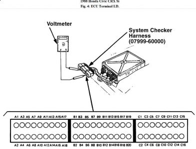

I do have a question though, when we were putting the conversion wires together, i did notice that each wire slot on the plugs were numbered but did not match the diagram from the civic, still went by the diagram. I wondered since i went by the color codes, that since the numbers did not match is why the problem still excist? the diagram went as a1, a3, a5 and so on, then a2, a4, a6 and so on. this could also. Also the plugs were did not seem to match in the position on the diagram also. something seems wrong or i did something wrong. The plugs are double row and teh diagram show as single.
Mar 1, 2010 at 10:07 PM
KHLOW2008
  • 41,814 POSTS
The schematic are only for illustrating where each wire should be. You need to understand the connector layout to get the correct position.
https://images.2carpros.com/forum/automotive_pictures/192750_ECUTerminal88CivicFig04_1.jpg
