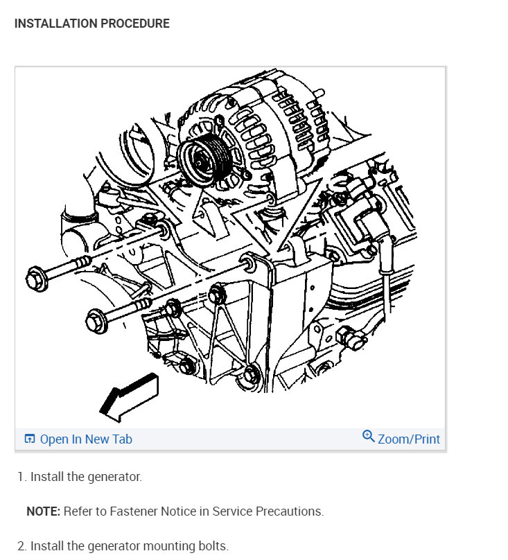

I have the truck listed above 1500 SLE and i have to replace the alternator and i am going to get a used one what years are the same to swap alternators with?
May 9, 2023 at 11:30 PM
  • 55,399 POSTS
there can be variations even within the same model year, depending on the engine and specific trim level.

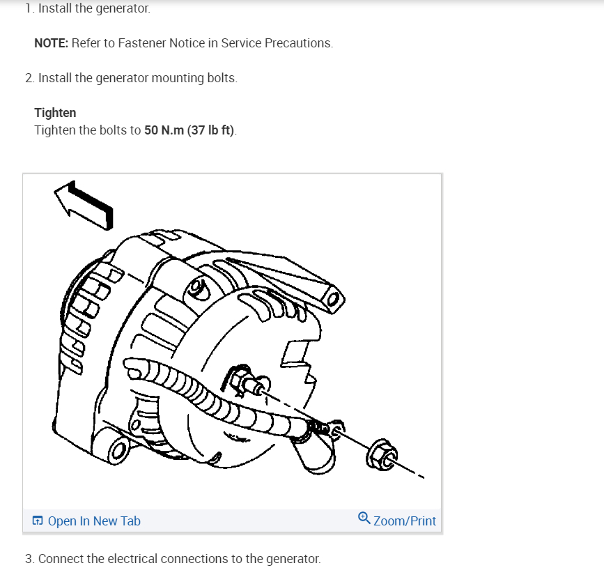

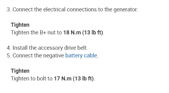

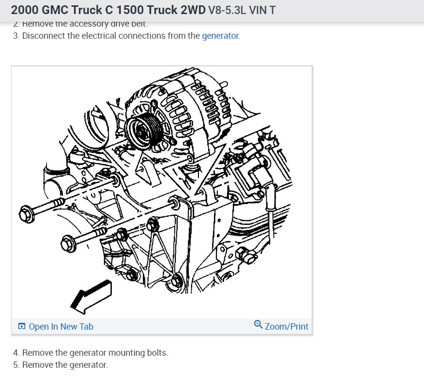

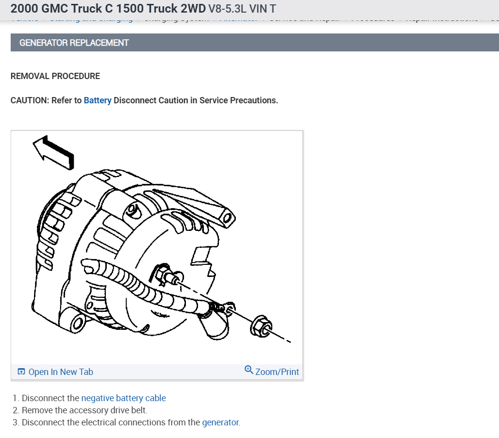

Here are the instructions for the replacement below. Please let us know if you need anything else to get the problem fixed. Disconnect the battery before you begin.
105 Amp Alternator 10464438
Alternators Are Sold As Assembly Only. Contact Dealer for most current part and price information
130 Amp Alternator 10464443
