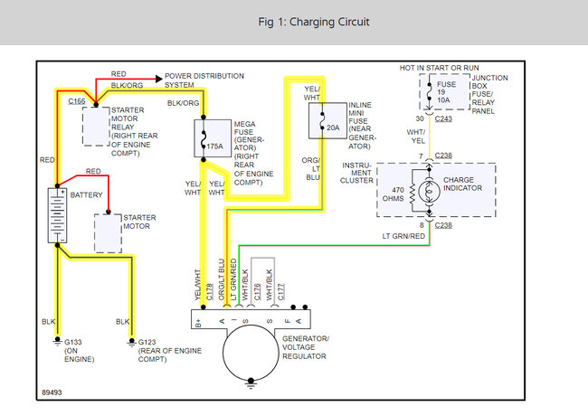

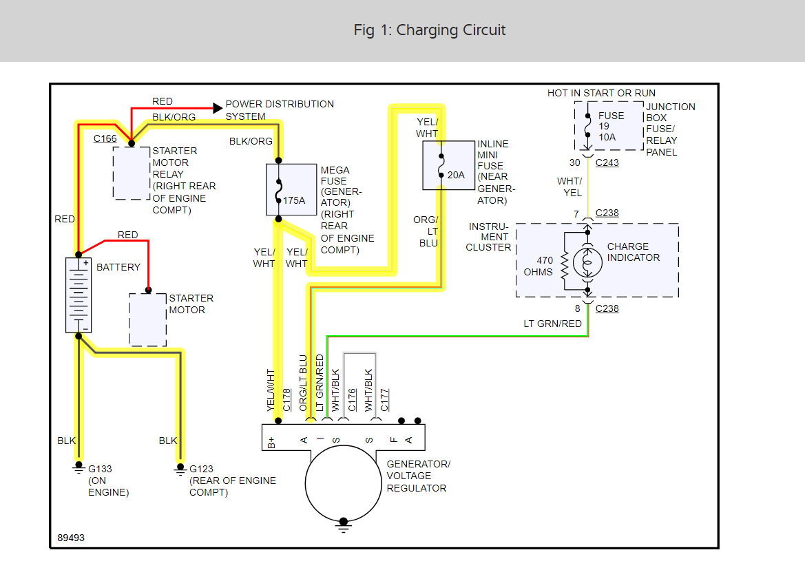

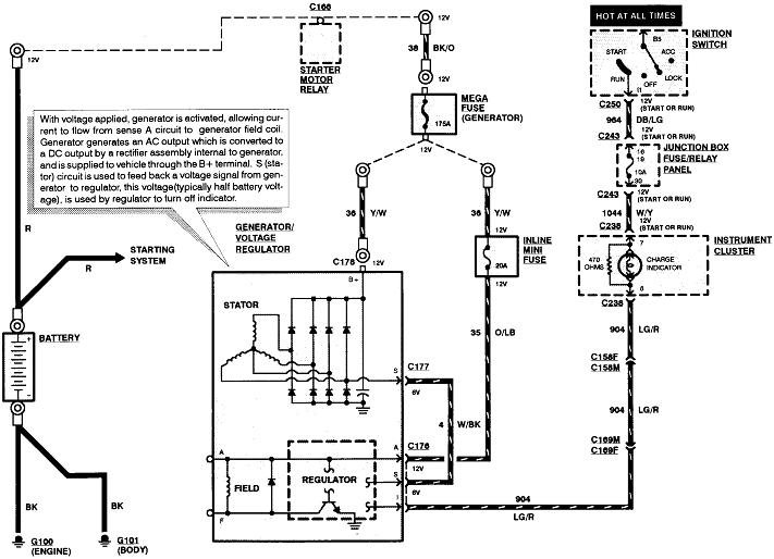

This could be a problem with the wiring going from the alternator to the battery. In the diagrams down below I have included a wiring diagram of your vehicle's charging system. Please double check that all the wires are tight and connected securely, as well as the electrical connectors from the alternator to the battery. I have them highlighted on the wiring diagram for you. Please get back to us with what you are able to find.

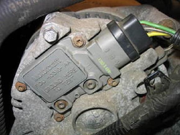

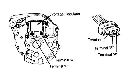

Where is the voltage regular located on this vehicle? I am having problem keeping the battery charged
Jan 22, 2021 at 3:37 AM (Merged)
MERLIN2021
  • 17,250 POSTS
It's an integral regulator, meaning it's bolted to the back of your alternator...Use a voltmeter at the battery terminals, see what the alt is putting out, you want 13.8-15 volts with all lights and accessories on. If OK replace battery, if weak replace both battery and alt! You want a fully charged battery in place with a new alternator, or you can damage the new alternator!

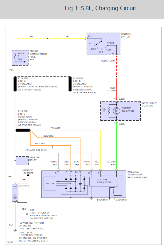

Good morning.
Attached is a diagram for the charging system. the light is controlled by a fuse in the junction box. that is what powers the light.
check for power on both sides of the fuse and then check for power at the connector for the cluster. it could be the cluster or it may be just the fuse.

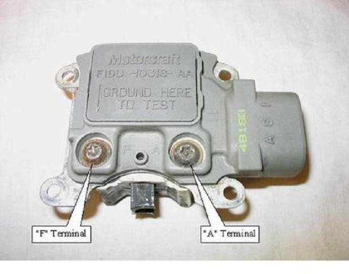

JBNY
  • 6 POSTS

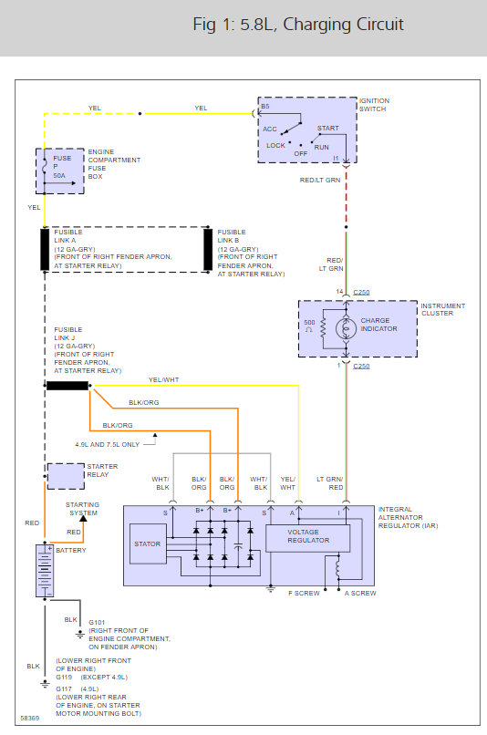

New battery will not charge. New alt/reg did not solve problem. During testing, grounding the regulator proved 18 volts from alternator. New regulator and known good regulator all act the same.
At one point, grounding the regulator would make the system work properly until engine was shut down. This no longer happens.
Followed testing procedures laid out in Haynes manual and everything says replace regulator. Does not fix problem

WRENCHTECH
  • 20,758 POSTS
Follow the orange with lt. blue wire from the alternator and look for a 20amp inline fuse and check that.
Also check all the fuses in the under dash fuse box. There is a 10amp fuse there associated with the alternator but I don't know what it's labeled. Use a test light to check them all for power at both ends with the key on.

JBNY
  • 6 POSTS
The mini fuse is intact as well as all the fuses in the circuit. Power is where it's supposed to be and grounds are intact. The alternator puts out 18 volts when the IAR is grounded at the test point.
Wiggle tests showed no irregularities and I'd rather not be opening the harness unless I have to. The circuit is fairly simple with only a clutch interrupt switch and ignition switch involved. I get the feeling this is a unique problem and am totally stumped as to how to proceed.
Being able to ground the IAR and have the system work properly is really throwing me, especially since now it no longer does that. This is making absolutely no sense.
BTW-thanks for responding. I was an ASE certified Ford wrench for ten years specializing in EECIV systems and driveability. I've never run across this.

JBNY
  • 6 POSTS
No it's my turn to apologize for the negative feedback I gave after your snarky response.
There is no power on the lt grn/red wire with KOEO. A test vehicle right beside this one confirms there should be. This line comes from the instrument panel charge indicator so I believe you've given me a direction to go in. I will be back after I trace the wire backwards from the alternator.
What is your experience with where I might find the problem in the circuit?

WRENCHTECH
  • 20,758 POSTS

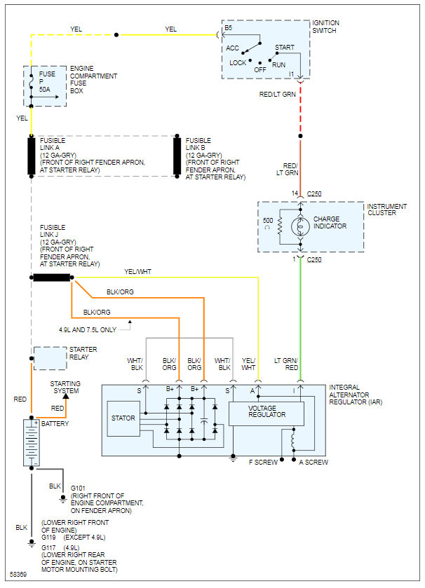

Green red comes from the fuse in the dash box through the charge light in the dash so it could be interrupted at the back of the cluster. It's white/yellow from the fuse to the light.

JBNY
  • 6 POSTS
It's even simpler than that. You'll get a kick out of this. When I checked the fuses in the fuse box earlier today I physically took each one out and looked at it. Then your advice got me back there checking again with the same results-everything's OK.
Rather than yank the cluster out I went to the fuse box again and was going to work up from there. Well, the 5 amp mini fuse in the circuit (#19)was still OK BUT when I put it back earlier I put it in the slot above where it was supposed to go. DOH!-I boned myself. Your check at the IAR connector is what got me there and I can't thank you enough.

CARADIODOC
  • 34,415 POSTS
Does the "Battery" warning light turn on when you turn on the ignition switch? Does it turn off once the engine is running? How was the generator tested and what were the results?
Go the voltage regulator's plug and check for 12 volts on the yellow / white wire by back-probing through the rubber weather seal. If that's missing, the 20-amp fuse is blown.
Check for 12 volts on the generator's large output terminal. If that's missing, it will be missing on the yellow / white wire too. Check the 175-amp fuse and be sure its nuts are tight.
If you have both of those, check for voltage on the light green / red wire when the ignition switch is in the "run" position. You should find around 2.0 volts. If you find it's near 12 volts and the dash warning light is not on, there's a bad connection between the mating terminals in that plug.
If all those voltages are okay, run the engine, then measure the battery voltage. You should find between 13.75 and 14.75 volts. If it stays near 12.6 volts or less, ground the "F" terminal on the back of the voltage regulator. If charging voltage goes way up, the regulator is defective.

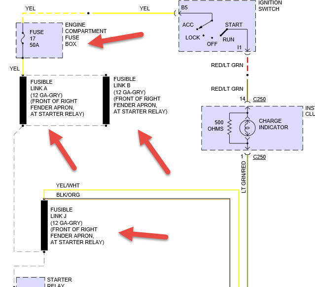

HMAC300
  • 48,601 POSTS
I do not know why auto parts guys think they know everything about a vehicle they only sell parts nothing else. there are three fusible links and a fuse which any of them could be bad see picture to check them. they should have 12 volts on each side wiggle them as they may only have one or two strands connecting.

GEEGEE
I had this problem it was the fusible link was blown, FYI.

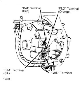

BMRFIXIT
  • 19,053 POSTS

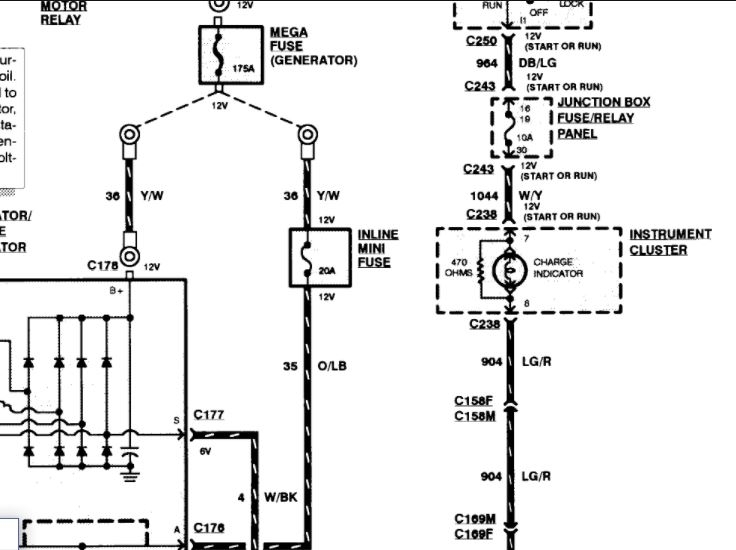

What kind of alternator do you have ? with internal or external voltage regulator?
https://images.2carpros.com/forum/automotive_pictures/99387_Graphic1_425.jpg
https://images.2carpros.com/forum/automotive_pictures/99387_Graphic2_212.jpg
check fuses check wiring check for battery power at the B terminal

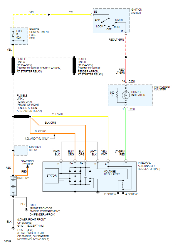

MATTHEW SHAWN
Two days ago driving down the road all lights dimmed really quick. Realizing that I believed the alternator just fried got to a safe place that I could work on it took both battery and alternator and had them tested both were bad. Come to find out it has a 1989 alternator with external voltage regulator in it. Changed alternator and battery, but not voltage regulator. Last night it sat for maybe an hour and a half (nothing was left on) tried to start it and all I heard was a loud pop (one click) noise coming from the voltage regulator and nothing. Tried to jump it and did same thing one click nothing. Tapped on starter solenoid, test diode fuses and every other fuse. Battery is completely drained. What could be the issue or how can I fix this?
I managed to get it figured out the screw that allows it to engage was not positioned correctly. Now that I have it set I am going to find something to keep it from moving and call it a day.
Jan 22, 2021 at 3:39 AM (Merged)
Thanks for the update. That is great that you got it figured out. I am attaching the wiring diagram for not only your future use but also, for others that may have this issue. While you figured out that your vehicle was installed with the wrong alternator the voltage regulator was external. This vehicle should have a voltage regulator as part of the alternator.
Here is a guide on how to test the alternator:
Please view the wiring diagram below for more info. Thanks and let us know if you have other questions. Thanks
