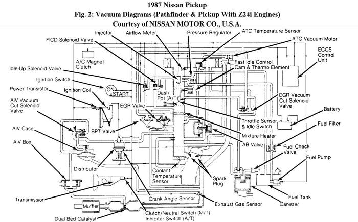

Don't know which engine you have so here are both.

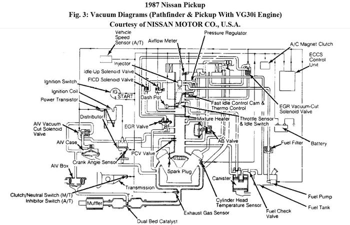

I recently purchased a 1987 nissan d21 pickup 2.4L, the engine was shot so I rebuilt it. The problem im having is that when I received the vehicle all the vacuum lines were a mess and most of them missing or disconnected. I have looked everywhere for a detailed vacuum diagram for this vehicle and have not yet been able to find it. I was hoping you guys could help. Thanks, Dyerpunk

https://www.2carpros.com/forum/automotive_pictures/66751_vaccum_3.jpg
here ya go! thanks for the donation
+2
Thursday, February 18th, 2021 AT 12:19 PM (Merged)
DYERPUNK
Thanks a lot guys, the diagram is exactly what I needed, everyone that I did find wasn't complete. Thanks Again.

I have a 89 nissan d 21 pick up I need a Vacuum diagram to check the routing of the existing lines any help thanks engine Z24 2.4
MERLIN2021
  • 17,250 POSTS
Here's both V6 and 4 cyl..
https://www.2carpros.com/forum/automotive_pictures/62217_VacDiaV6_1.jpg
https://www.2carpros.com/forum/automotive_pictures/62217_VacDia_1.jpg
