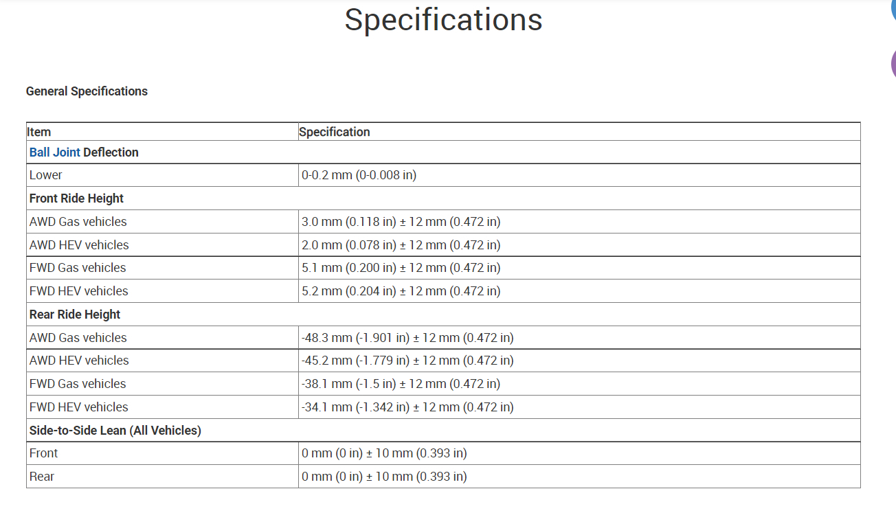

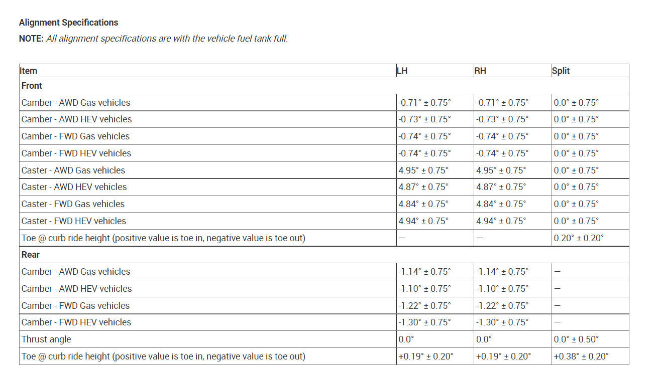

Hello. Could someone help and tell me the Alignment Specs of the vehicle listed above Titanium? Thank you a lot.

Good morning,
I attached the specs for you below for that car. Check out the diagrams (Below). Let us know what happens and please upload pictures or videos of the problem. Let me know if you have any other questions.
