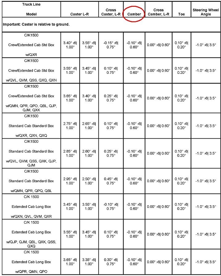

Lifted truck took to tech for alignment they couldn't get passenger side aligned when they did it would push driver side out of alignment.

All bets are off when the vehicle is not at the suspension ride height as designed, so there is going to be miserable tire wear and handling, but the numbers should still look okay on the alignment computer. You'll have to be more specific about what is happening. It sounds like the mechanic either dumbed it down to make it understandable, or something got lost in translation. Adjusting something on one side shouldn't affect anything on the other side. The only thing that interacts is if you have torsion bar front springs, adjusting one up or down to get it to specs will raise or lower that corner of the truck, and that causes the other side to tip too, but that only applies if you have upper and lower control arms. If you have a solid front axle, from ball joints to ball joints, that suspension system is not affected by height changes.
When you have upper and lower control arms, (short-long arm, "SLA") suspension system, those arms, the frame rail, and the spindle form the four sides of a parallelogram with very specific geometric angles designed in. That is what you upset when ride height is altered. If you look closely at the lower control arm, you'll see it is very nearly perfectly parallel to the ground, but the upper arm is angled down a lot as it goes out to the upper ball joint. That angle causes the top of the spindle and wheel to tip in and out on top as the truck body bounces up and down. That reduces how much the tire scrubs sideways across the road surface and is what greatly reduces tire wear.

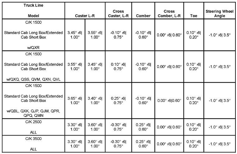

The problem comes in when the vehicle is lifted by installing longer coil springs or turning up torsion bar springs. The spindle and wheel move down, and the upper control arm angles down a lot more than before. As the control arm arcs inward, that tips the wheel in on top. The alignment angle in question is "camber". Most vehicles call for slightly positive camber, meaning the wheel is tipped out on top a little. Perfectly straight up and down is 0.00 degrees, and if you could imagine the wheel laying flat on its side, that would be 90.00 degrees. Typical camber specs for most vehicles including GM trucks are around 0.25 to 0.50 degrees. The chart below shows all versions for your truck as between -0.10 degrees to 0.60 degrees. They don't list a preferred spec.

Where it sounds like you're running into trouble is caster and camber can be adjusted to specs on one wheel by moving the two bushings in and out, but while camber can be made nearly perfect, and caster can wind up being acceptable, we still need to have both of those values the same as on the other side. That means four angles have to be set by moving four adjustments. You might not be able to get caster high enough on one side to match the other side, and you might not be able to get caster low enough on the other side to match the first side. This is where I need to know exactly what the specialist is having trouble with. If you could post a copy of the alignment printout, I can interpret that for you and perhaps figure out what is causing the trouble. If there is no printout, I need to know what you have for camber and caster on each front wheel.
