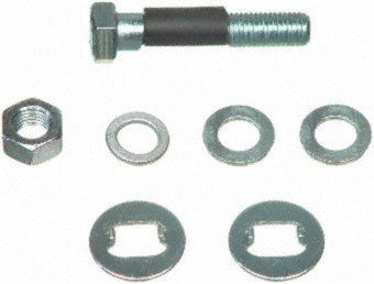

Toe can be adjusted but the front is "as built" for camber without the proper bolt kit. There are no cams or slotted holes for either of the other adjustments. You have to remove the old bolts and replace them with special smaller offset ground bolts, those allow you to adjust the camber. Without them there is no camber adjustment up front.
MOOG K90476 is a single offset kit, MOOG K928 is a double offset kit. The first gives you 1.5 degrees of change both positive and negative. The second doubles that.

This is the Moog K928 kit to replace the lower bolt.

Hi Steve, you do not even need the kits, which for many shops means wasting time waiting for the parts store to deliver them. The holes in the strut for the lower bolt can be ground oval-shaped to provide for adjustment. You do not get the careful control of where you are setting camber like you did in years past when Chrysler used cam bolts, but typically only a little adjustment is needed. Grinding the holes leaves it the same as we used to do with GM front-wheel-drive cars. If a lot of adjustment is needed, either there is a bent suspension part from a crash that must be identified and replaced, or more commonly, ride height has sagged and the coil springs must be replaced.

True, but without doing some form of modification you can't adjust the camber. I use the bolts simply because the old ones are usually rusted on BAD, so It's simpler to cut them off and install the offsets. Folks in states that don't have that issue can pursue other methods.
