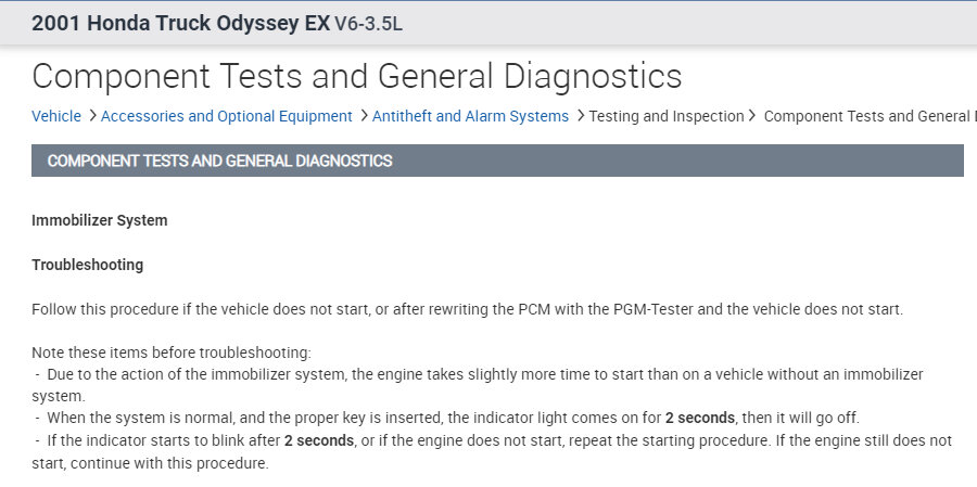

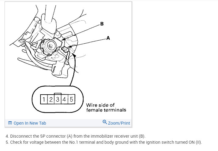

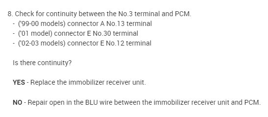

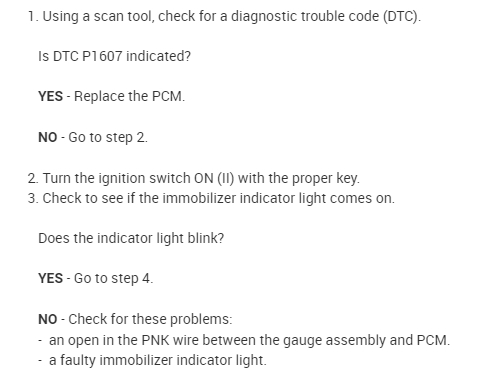

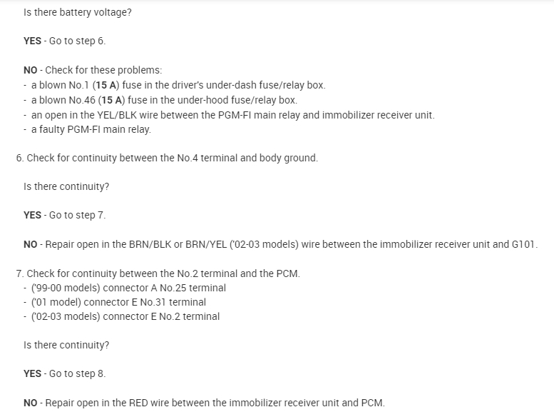

Have you scanned the can-bus? If not, that is where I would start. There is an anti-theft module that may have codes.
Here is a link that shows how it's done:
Next, I attached diagnostics below for general diagnostics related to the anti-theft/immobilizer. Take a look through them and let me know if you are comfortable performing them.
