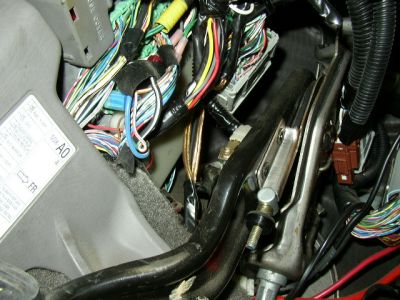

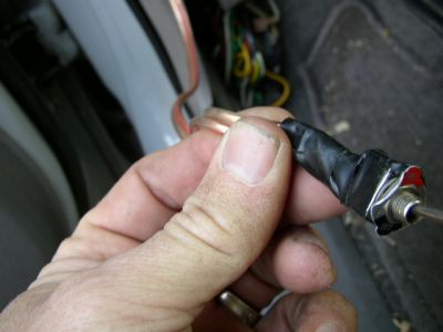

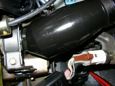

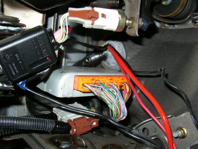

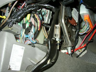

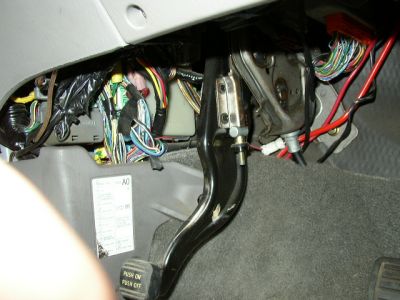

Hi again I have found out that the alarm is after factory. The remote is not Honda issue. The system closes all windows when the remote is closed. So the noise is not the horn. I have looked where you said and can't see anything that would indicate alarm, but I have taken 3 pics of the are and you may be able to spot something. Thanks
https://images.2carpros.com/forum/automotive_pictures/435511_P1010035_1.jpg
https://images.2carpros.com/forum/automotive_pictures/435511_P1010036_1.jpg
https://images.2carpros.com/forum/automotive_pictures/435511_P1010037_1.jpg
Nov 18, 2009 at 3:14 AM
HONDA TECH 1818
  • 536 POSTS
There's a couple of big wires (red) and the black wires is not factory at the right side of the picture. The aftermarket security system could be inside the kick panel just follow the red wires to see where it goes.

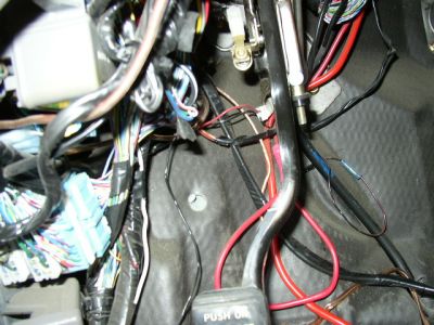

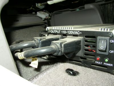

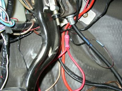

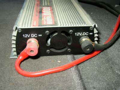

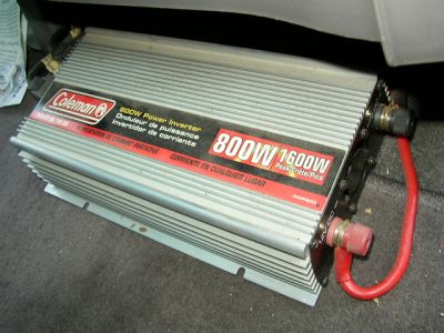

Gee you are good. How you manage to notice that? The wires go to a box under the driver seat. I didn't even know the box was there. I have given more pics. Will I disconnect all wires to this box? The guy who sold this van said he did several add ons. I don't care if I lose his add ons. I only want the alarm cut, but I don't want to disarm anything that I need to get the car up and running. If this is the alarm I suppose I will be able to hook up the box and alarm after the van has been jumped and the battery is good again. Thanks again.
https://images.2carpros.com/forum/automotive_pictures/435511_P1010038_1.jpg
https://images.2carpros.com/forum/automotive_pictures/435511_P1010039_1.jpg
https://images.2carpros.com/forum/automotive_pictures/435511_P1010040_1.jpg
Nov 19, 2009 at 9:12 AM
HONDA TECH 1818
  • 536 POSTS
I repair Honda cars for years and know the ins and outs of their automobiles.
The second picture you provided is a power inverter, which could drain your battery because it is hooked up directly from the battery. This device has nothing to do with your no start.
Check the following places to see if you can find any aftermarket device:
The first picture on the left side is the kick panel (gray) - remove it to see if you could find anything there...
What about the two black wires next to the red wires, where do they go?
Check the area above the two red wires...

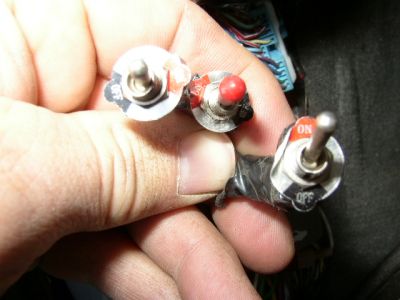

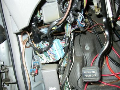

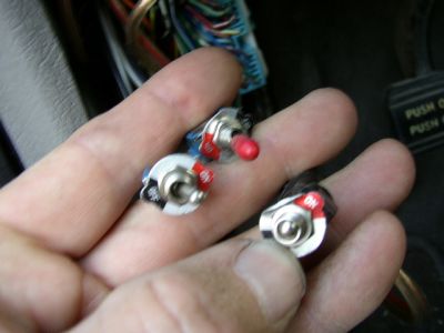

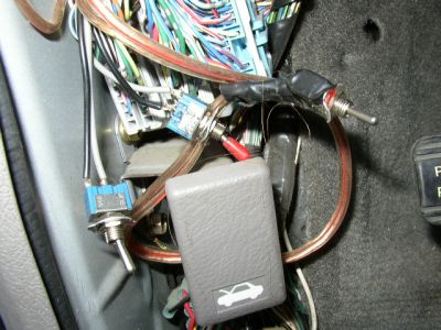

Sorry been so long getting back to you. I have been looking at places you mentioned but am still stumped. I have taken more pics because I still don't know what I am looking for. The pic with the 3 switches are all switched on. One of the switches looks like it has different wire and electrical tape which could be an add on. The black wires seem to go in different directions. If I follow a suspect wire what am I looking for at the end of it? Sorry for being so stupid and I appreciate all your help. - Thanks again. A
https://images.2carpros.com/forum/automotive_pictures/435511_P1010049_1.jpg
B
https://images.2carpros.com/forum/automotive_pictures/435511_P1010050_1.jpg
C
https://images.2carpros.com/forum/automotive_pictures/435511_P1010051_1.jpg
D
https://images.2carpros.com/forum/automotive_pictures/435511_P1010052_1.jpg
E
https://images.2carpros.com/forum/automotive_pictures/435511_P1010053_1.jpg
F
https://images.2carpros.com/forum/automotive_pictures/435511_P1010054_1.jpg
G
https://images.2carpros.com/forum/automotive_pictures/435511_P1010055_1.jpg
H
https://images.2carpros.com/forum/automotive_pictures/435511_P1010056_1.jpg
I
https://images.2carpros.com/forum/automotive_pictures/435511_P1010057_1.jpg
Dec 5, 2009 at 9:16 AM
HONDA TECH 1818
  • 536 POSTS
The picture A- the two swtiches (black and white wires) on the left side looks like one of those is the switch to turn off the alarm. Try turning the ignition key to on and switch the switch to off and see if the alarm would turn off.
The picture E- The alarm shock sensor is on the left side (black box) if you follow the shock sensor wires you might found the alarm (black box also but bigger).

The alarm sensor you talk about is an AudioVox Model AS-9495-4P Shock Sensor.
I was wondering if I disconnected wires from the box it would disable the alarm.
