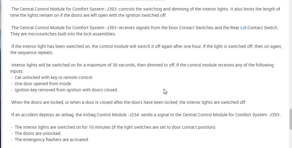

We need to start with scanning for codes. I suspect we have an issue with the central control module that controls the comfort systems and the alarm system. Basically this module gets signal from the door switches and other things to see if the door gets opened with the alarm on. If it does, it turns the alarm on.
Unfortunately we have to deactivate the system using the key fob to unlock the doors but if this is not disabling it then I am sure there are some codes.

Okay. That is good info. I suspect you have a door switch issue or something else causing this.
However, to answer your question, you cannot disable the system as it is a safety system that if easily disabled, a thief would just disable it and get into the car.
I suspect you only option is to lock the car without using the key fob. So can you lock the door manually and it not activate the alarm? Without finding out what is triggering this, I suspect that is the only option.
