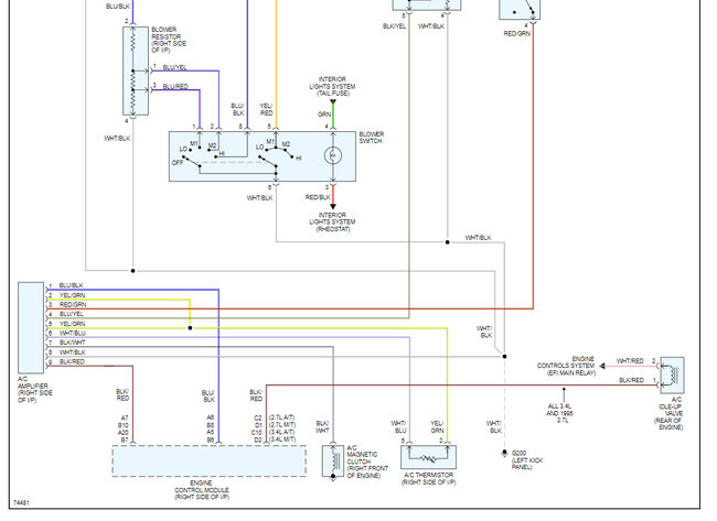

As you might gather I have a problem with my air conditioning.
I have a Toyota picnic 2.0L 16V (July 1999 european model).
All started a while back the aircon would work for a while then the A/C LED would start flashing. If i turned it off and on again it would work again for a while. Eventually it degraded to a situation where the compressor would engage and then almost immediately stop (with the LED flashing.
I have a circuit diagram of the electrical system for a RAV4 which seems identical except for in my system there is no 'conventional' magnetic clutch relay (the wires that enter and exit this on my car go straight in and out of the cabin fuse box so I presume it is controlled by a semiconductor fuse inside this).
I tested the lock sensor resistance (205ohms which is good for the compressor model and identical to the new compressor I picked up (I thought the clutch might be slipping)) the evaporator thermistor seems good (though as it's under the dash I haven't ventured to testing it fully) at approx 25°C (1.5Kohms) it gives a resistance within parameters and drops with increasing temperatures).
The wiring to and from the 12 pin A/C Amplifier (A/C control module) is good (zero resistance across wires and no shorting)
I have still to verify the wiring to and from the cabin fuse box (I need to verify as I noticed a possible short but when I tested again it did not manifest itself).
At present I am thinking along 3 lines:
1) Blown A/C amplifier (took the box out and the circuitry 'looked' good nothing evident to really suggest this).
2) Signals of rpm from ECU to A/C amplifier being off (is this possible?) Would need an oscilloscope to check this.
3 The circuitry within the cabin fuse box (semiconductor fuse?) is switching due to being degraded or a veritable short fusing somewhere. This I need to check more and if I conclude there is no shorting in the harness the I a thinking I could replace/test with a conventional relay (i.e rewire to a relay switch which could also verify a short circuit as the 7.5A A/C fuse would blow).
What council can you give me?
I have been at a loss for a while (not finding a magnetic clutch relay really flummoxed me as well as confusing advice from internet searches and mechanics lol).

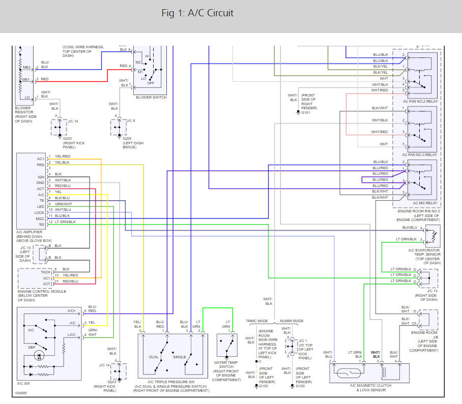

Just to start, have you confirmed your pressure is correct? Or at least jump the compressor with 12 volts and see if it comes on and blows cold. That would be a good indicator that this is okay. If it is and this is happening then you are on the right path that this is most likely something to do with the amplifier or the amp itself.
So based on that, we are going to have to check the voltages at the AC amplifier with the AC on. Basically we need to see what voltage is there and then that will tell us what direction to go. It is much more effective then just inspecting the wiring or checking different circuits looking for an issue.
We need specific voltage at the AC amp in order for it to work so let's see what we don't have and go from there.

The wiring schematic I am using is from this thread: https://www.2carpros.com/questions/ac-amplifier-harness-wiring-colours (see bottom of reply)
However there are differences (wire colors and locations are different and most importantly there is no magnetic clutch relay (also A/C circuit is hot in on or start) so it's complicated for me.
So testing the voltages across the A/C amplifier I get:
GND (5) to A/C (7) 13.6V blower ON A/C switch ON
GND (5) to PRS (2) 11.4V in start 13.7V engine running and all other conditions
SG (12) to TE (8) 0.58V ???
SG (12) to Lock (10) 0V ???
GND (5) to MGC (11) 11.4V in start, 13.6V engine running, 0V blower ON A/C switch ON.
GND (5) to (LED (9) 2.7V Blower ON A/C ON then when flashing variable (3.6 to 9.6V).
Am I correct in thinking:
There should be 12V across the LOCK sensor?
Isn't 0.58V across the evaporator TEMPERATURE sensor very low?
Hence the A/C amplifier is in question!
Edit: the system only operates for a very short time before the A/C LED starts flashing and the compressor stops.
Jul 25, 2021 at 12:03 AM
Okay. So when you are testing pin 12 to pin 8 for voltage, you are doing what is called a voltage drop across whatever component is on this circuit.
So you are finding that the Evap pressure sensor actually uses .58 volts to operate but you are not finding out what the sensor is telling the AC amp. To find out what the sensor is telling the module you need to check pin 8 to ground.
The way that circuit works is the pin 12 is a signal circuit which should be 5 volts. Then this 5 volts passes through the evap sensor and returns to the AC amp where it tells it what the temp sensor is reading. This will be on a scale from .5 volts to 4.5 volts due to the sensor requiring a small amount of voltage to operate (which is the .58 volts that you are finding with the voltage drop test).
So we need to see what the volt is from the sensor using this test and we can go from there. The same pin 10. You are getting 0 volts because this signal circuit is not connected to the clutch so it is basically an open circuit.
Jul 25, 2021 at 12:35 AM

From what I can gather SG pin (12) is signal ground the signal wire is TE pin (8) for evaprorator temperature sensor. From what you are saying 0.58V could be a good reading (temperature at the sensor is well over 40°C where I have the car (I have 30°C in the house). I tested TE pin (8) to GND pin (5) and other grounds and got the same reading. Even if the compressor only works a very short time the voltage from TE pin (8) does increase slightly each time the A/C is activated).
SG pin (12) to any ground always gives 0V as does the wire at the compressor when disconnected.
LOCK pin (10) always gives 0V to any ground (I also tested the LOCK wire at the compressor and got 0V to ground in theory this should have given either 5V or 12V for a short time at least).
At first I also thought the SG pin (12) was the 5V 'power' supply however that doesn't appear to be the case though I stand to be corrected (it's very confusing to me).
Jul 25, 2021 at 1:33 AM
The problem is, these wiring diagrams are not exact to your truck. We don't have one for this specific vehicle so this is going to continue to be confusing until we get one for your vehicle.
Jul 25, 2021 at 12:39 PM

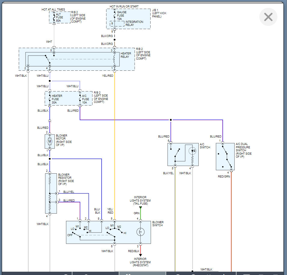

A friend had a quick look and said no juice was arriving to the magnetic clutch. I then tested the voltages going to the magnetic clutch and A/C fan relay.
I recorded that only 3.5V max. was being sent to the magnetic clutch which surely isn't enough.
No voltage was being sent to the A/C fan relay.
Note that the A/C controll module sends a signal. I have also checked the wiring and harness which is good.
So whatever is going on in the fuse box it recieves a signal but doesn't send out the voltage necessary to 'switch' either the magnetic clutch or the A/C fan relay.
I am going to look for a replacement fuse box to test the theory that the problem lies there.
(As discussed before there is no conventionnal magnetic clutch relay in the circuit, this function is surely within the fuse box (probably a 'semi-conductor' switch system?).

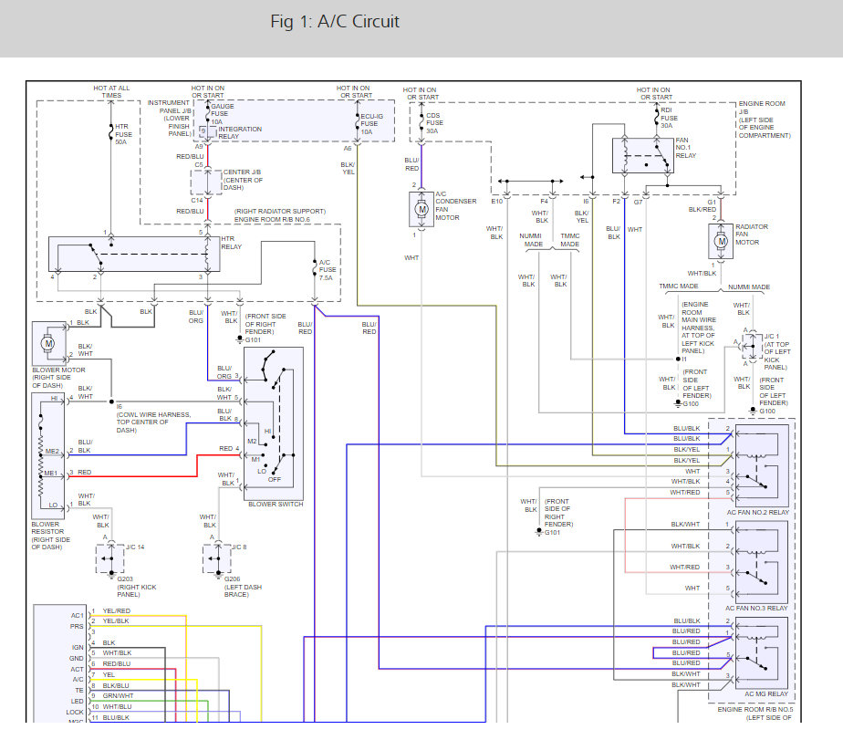

So I swapped out the fuse box and replaced it with a second hand one I picked up for15 euros (excluding postage).
Good news all is good the air conditioning works.
So it was a component in the fuse box that acts as the magnetic clutch relay.
Now all is working I'm going to take the old fuse box apart (something I didn't want to risk until I had a replacement) and see if there is anything evident wrong with it (I doubt I will see anything but who knows).
Anyway really please, thanks for the help, helped push me in the right direction. though the biggest problem was not having a correct wiring diagram so not knowing where/what the magnetic clutch relay was above all as there wasn't one.
I'll get back if I see a connection or burnt out component in the fuse box.
