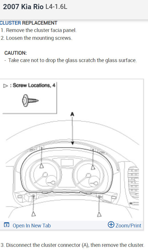

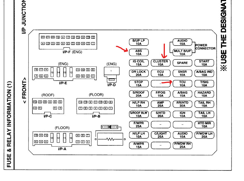

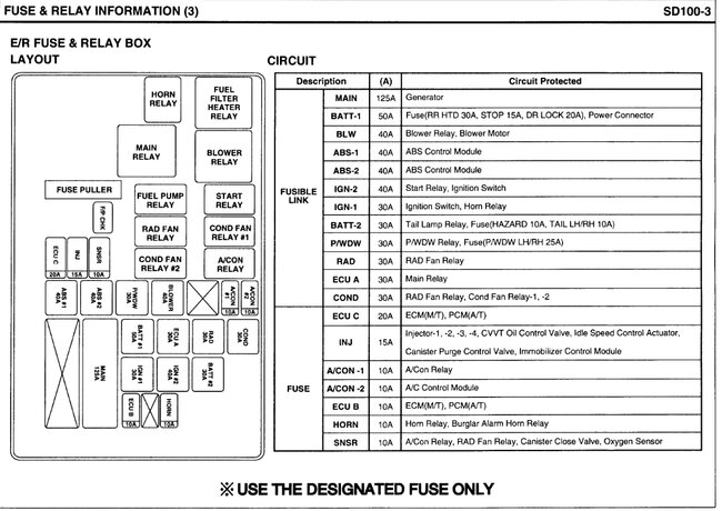

My airbag light came on and my speedometer stopped working. what could be the problem?
Oct 4, 2024 at 12:24 AM
  • 54,832 POSTS

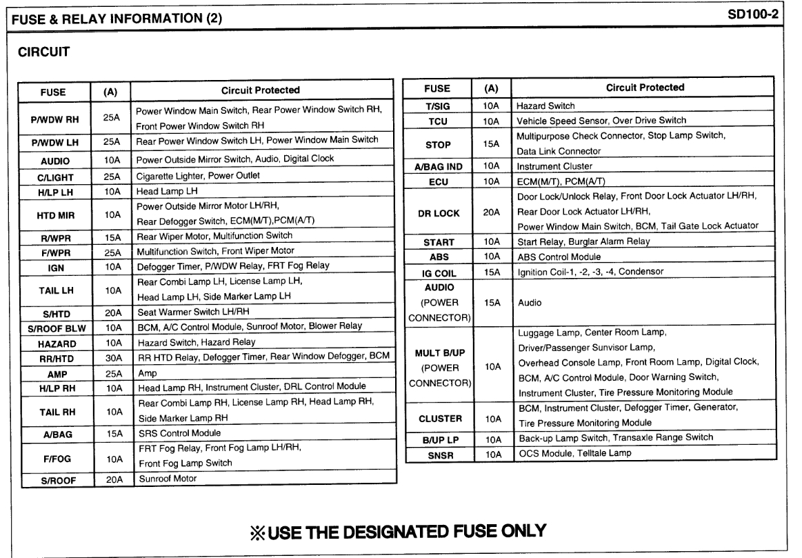

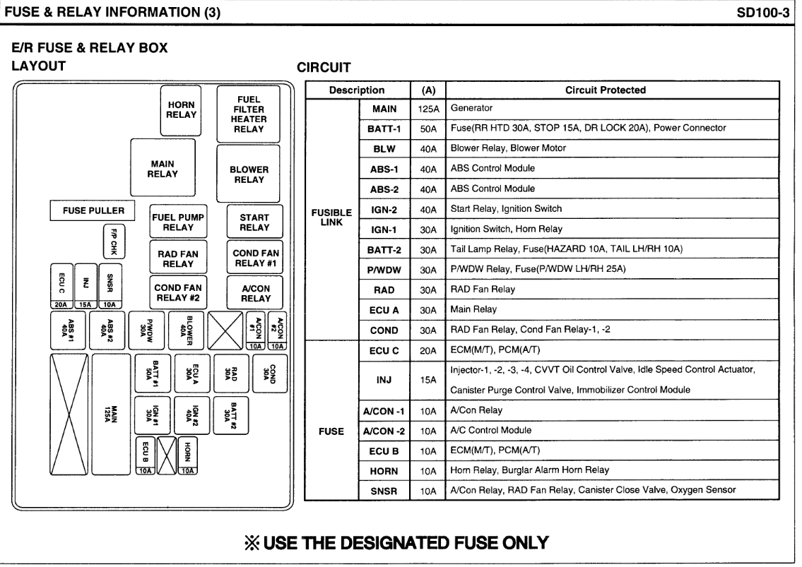

Hmm, that's a good one, I would start by checking all fuse with the key on, this guide can help:
If the fuses are okay, let's do a CAN scan. You can get a CAN scanner (Controller Area Network) which will work on most cars from Amazon.
https://youtu.be/u-4syLc-ifQ

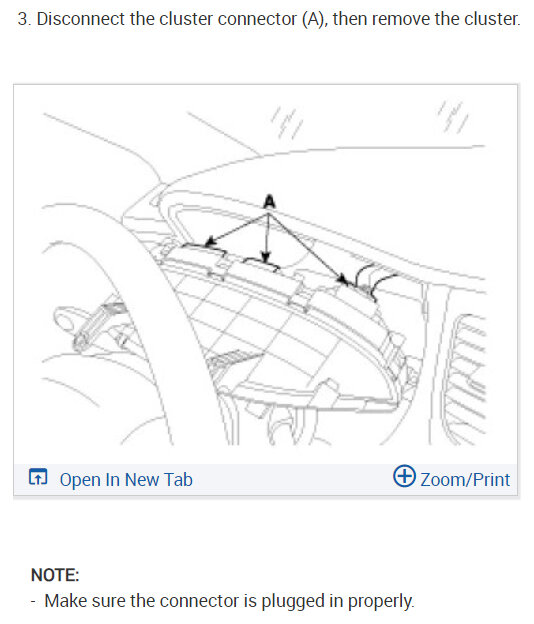

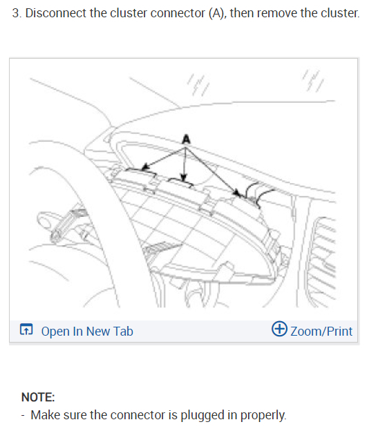

To me it sounds like the instrument cluster has gone out or you have corrosion at the cluster's electrical connector. You might want to remove the cluster for inspection. I have marked some fuses I would make sure are getting power. Also, how to remove the cluster as well. Check out the images (below). Let us know what you find.
