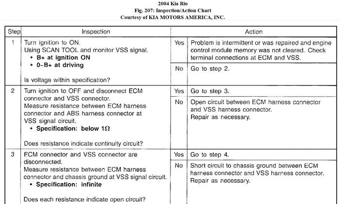

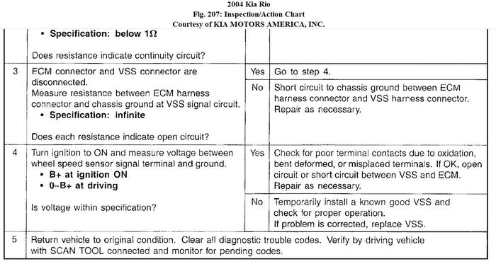

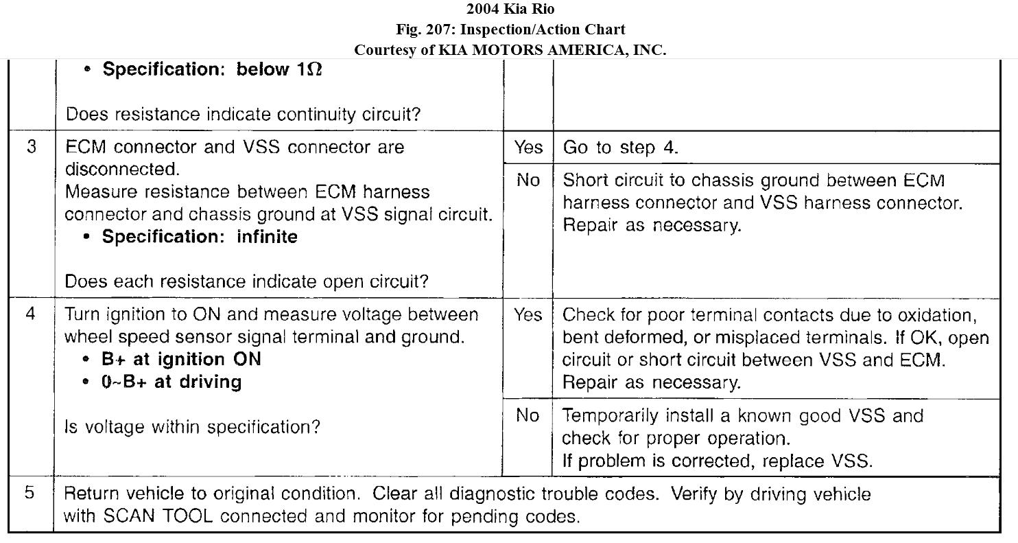

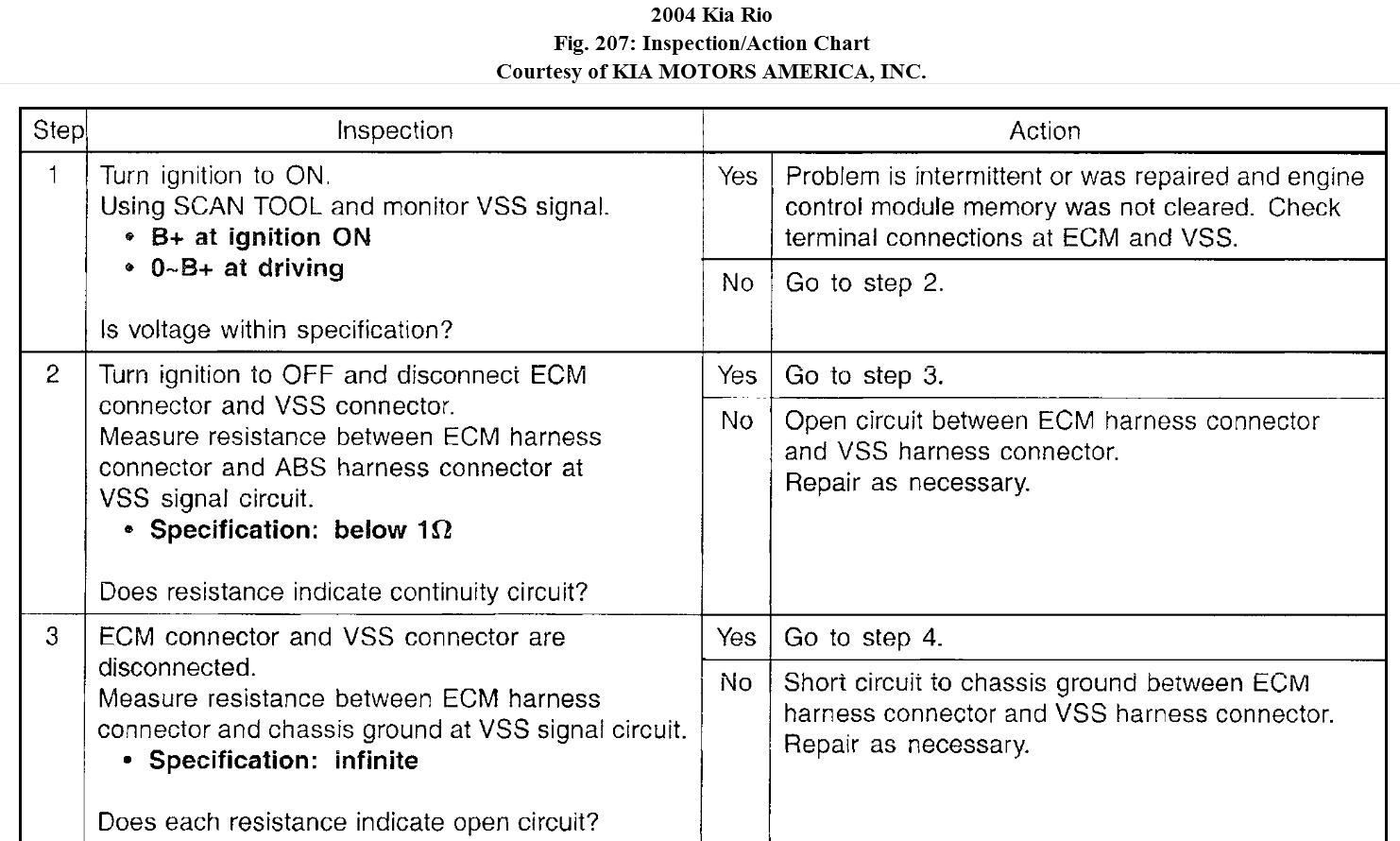

R_GOMEZ3
  • 2004 KIA RIO
  • 57,000 MILES
Getting check engine light code P0501, already changed out the wheel speed sensor and the differential abs sensor. Cleared the code and drove the car light came back on same error message. I don't know if when I got into an accident it messed up some of the wires and maybe shorted out the on board computer. Please help
Thursday, November 2nd, 2017 AT 9:11 PM (Merged)
KHLOW2008
  • 41,814 POSTS
See if the attached charts are helpful.
