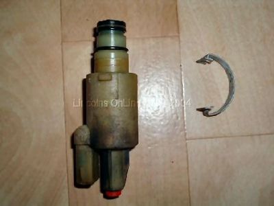

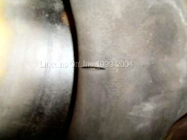

JNOVACK
  • 723 POSTS

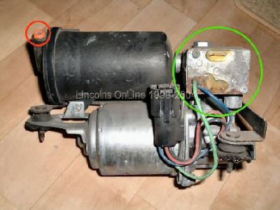

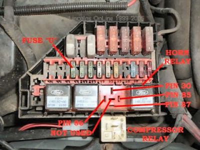

here is the testing for air system TOOLS FOR THE JOB Digital multi-meter and/or analog multi-meter Some jumper wires Small tool kit with assorted screwdrivers, wrenches and pliers Garden sprayer or spray bottle filled with soapy water Also an assistant can be useful at times COMPONENT LOCATIONS Compressor: under the hood, left front corner under the air cleaner Compressor relay/fuses A, C and U: under hood in power distribution box Other fuses: in instrument panel fuse board Control module '90 - '94: Right side of trunk behind trim panel Control module '95 - '97: Behind the glovebox On/Off switch: right side of trunk Height sensor: under the car from suspension to frame Air springs: one each side on rear axle to frame Air spring vent solenoids: one on the top of each air spring Diagnostic plug: right side of trunk behind trim panel AIR SUSPENSION TESTING Your "Check Suspension" light has come on, what do you do next? Well the first thing to check is the fuses and that the on/off switch is "on". Model Year I/P Fuses Under Hood Fuses 90 - 91 1 and 4 A (50amp) and U 92 - 93 1 and 8 A (50amp) and U 1, 4 and 8 A (50amp) and U 95 - 97 7 C (50amp) and U
https://images.2carpros.com/forum/automotive_pictures/52960_00061_1_1.jpg
The picture above shows the power distribution box of a '92 Town Car with the compressor relay removed and placed to one side, fuse "U" and the compressor relay pins labeled. TESTING THE MODULE POWER FEEDS AND ON/OFF SWITCH> Switch the air suspension off and disconnect the control module connector. Switch testing '90 - '94 Town Cars Connect a voltmeter or test light to the Dark Green/Yellow wire and ground. You should get twelve volts when the air suspension switch in turned on, if not check fuse 1 or service switch/wiring to fuse 1. '95 Town Cars Connect a voltmeter or test light to the Dark Green/Yellow wire and ground. You should get twelve volts when the air suspension switch is turned on, if not check fuse U or service switch/wiring to fuse U. NOTE: There are two terminals with Dark Green/Yellow wires, both should test the same. '96 - '97 Town Cars Connect a continuity meter (ohms) between the Dark Green/Yellow wire and the Purple/Light Green wire; you should have 0 ohms with the switch closed and infinity with the switch open. Other power feeds '90 - '91 Town Cars Check the Light Blue/Pink wire for battery voltage when the ignition is switched on, if no voltage check fuse 4 and wiring. '92 - '94 Town Cars Check the Red/Yellow wire for battery voltage when the ignition is switched on, if no voltage check fuse 8 and wiring. '95 Town Car Check the Light Blue/Pink wire for battery voltage when the ignition is switched on, if no voltage check fuse 7 and wiring. '96 - '97 Town Cars There are three Light Blue/Pink wires. The ones on pin 1 and 15 will have battery voltage all the time, if no voltage check fuse U and wiring. The one on pin 16 will have battery voltage when the ignition is switched on, if no voltage check fuse 7 and wiring. TESTING THE COMPRESSOR AND RELAY If the compressor appears to not be working, first check the fuses. Then check that the compressor actually works: the simplest way to do this is to remove the compressor relay and with a jumper wire bridge the terminals in the power distribution box for pins 30 & 87. You may get a small spark and the compressor should start. If the compressor doesn't start, remove the jumper wire and check for battery voltage on pin 30. If you have no battery voltage on pin 30 then there is a fault in the power distribution box or with fuse U. If you have battery voltage on pin 30 then gain access to the compressor and disconnect the compressor harness, reinstall the jumper wire to pins 30 & 87, and check for battery voltage on the Purple/Orange wire ('90 - '95) or Grey/Red wire ('96 - '97). If you have battery voltage then check for continuity to ground through the black wire, if you have continuity to ground and the compressor connector is in good condition then the compressor is bad. NOTE: The wires on the compressor side of the connector are different colors. If the compressor started when pins 30 & 87 were jumped then the next check is the relay. The easiest way to do this is fit it in the horn relay slot next to the compressor relay slot (first check the horn sounds), and then sound the horn - if the horn doesn't sound the relay is bad. To check the relay is functioning and wiring to the control module, first remove the compressor relay and check for battery voltage on pin 86. If there is no battery voltage then a fault exists in the power distribution box. If you do have voltage refit the relay and gain access to the control module and switch off the air suspension and disconnect the module connector. Now with a jumper wire ground the Dark Blue/Yellow wire (all years) and the compressor should start; if not then there is a fault with the wiring to the module from the power distribution box. If the compressor does start then the module may not be giving the signal to start the compressor, maybe the module, maybe the height sensor.
https://images.2carpros.com/forum/automotive_pictures/52960_00061_2_1.jpg
The picture above shows a Town Car compressor with the airline connection circled in red and the vent solenoid circled in green. TESTING THE DOOR INPUTS The air suspension will not vent if a door is open, the module may be receiving a false "Door open" signal from a faulty courtesy light switch. To test the door open signal switch the air suspension off and disconnect the control module connector. '90 - '94 Town Cars Connect a voltmeter between the Dark Blue/Orange wire and ground, you should have 0 volts, now open and close each door, you should get 12 volts each time a door is opened. '95 - '97 Town Cars The door open signal comes from the LCM (Lighting Control Module), I am not sure what type of signal is used but from studying the wiring diagrams I believe it to be low voltage, probably 5 volts. The door open signal wire is Black/Yellow; it may be possible to test using a voltmeter as for the '90 - '94 Town Cars. TESTING THE AIR SPRING AND VENT SOLENOIDS Venting test '90 - '94 Town Cars Switch off the air suspension and disconnect the control module connector, then simultaneously ground the Purple/Light Green, Light Blue/Black and Pink wires. The rear of the car should lower. If not then check fuse U and try again if blown. Next, gain access to the compressor assembly and disconnect the air line from the drier. Then once again ground the Purple/Light Green wire and the left side should lower - ground the Light Blue/Black wire and the right side should lower. From these tests you will know if both spring solenoids are working and if they are, whether or not the vent solenoid is working. Venting test '95 - '97 Town Cars Switch off air suspension and disconnect control module connector, then simultaneously ground the Brown/Pink, and Tan/White and Pink wires. The rear of the car should lower. If not then check fuse U and try again if blown. Next, gain access to the compressor assembly and disconnect the air line from the drier. Once again ground the Brown/Pink wire and the left side should lower; ground the Tan/White the right side should lower. From these tests you will know if both spring solenoids are working and if they are, whether or not the vent solenoid is working. If this test shows both spring solenoids and the vent solenoid are venting, then it could be the control module is not sending the signals to vent. This may be a bad control module, height sensor or false door open signal. Spring solenoid testing '90 - '94 Town Cars Switch the air suspension off and disconnect the control module connector. Next, gain access to the spring solenoids and disconnect the solenoid connectors. Now ground the Purple/Light Green and Light Blue/Black wires on the module connector. Next, using a voltmeter or test light bridge the two terminals of each spring solenoid connector and you should have battery voltage (test light lit). If not then connect your voltmeter to the Orange/Red wire of the solenoid connector and to a good chassis ground and you should have battery voltage. If not, check fuse U. If fuse U is okay then you have a wiring fault between the power distribution box and the spring solenoid. If you have battery voltage on the Orange/Red wire and when the two-solenoid connectors were previously bridged you did not get battery voltage then you have a wiring fault on the wire (Purple/Light Green or Light Blue/Black) between the control module and spring solenoid. Finally, remove the jumper wires from the control module connector and with your voltmeter or test light bridge the spring solenoid connectors - if you get battery voltage then the wire (Purple/Light Green or Light Blue/Black) between the control module and spring solenoid is shorted to ground. From these tests you will know if the wiring is okay. If during the previous venting test one or both air springs didn't vent and the wiring is okay, then it would be safe to assume that you have a bad spring solenoid(s).

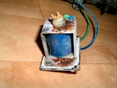

The picture above shows a spring solenoid and retaining clip. Spring solenoid testing '95 - '97 Town Cars Switch air suspension off and disconnect the control module connector. Next, gain access to the spring solenoids and disconnect the solenoid connectors. Now ground the Brown/Pink and Tan/White wires on the module connector and using a voltmeter or test light bridge the two terminals of each spring solenoid connector. You should have battery voltage (test light lit), but if not then connect your voltmeter to the Light Blue/Pink wire of the solenoid connector and to a good chassis ground. You should have battery voltage but if not check fuse U, If fuse U is okay then you have a wiring fault between the power distribution box and the spring solenoid. If you have battery voltage on the Light Blue/Pink wire and when the two-solenoid connectors were previously bridged you did not get battery voltage, then you have a wiring fault on the wire (Brown/Pink or Tan/White) between the control module and spring solenoid. Finally, remove the jumper wires from the control module connector and with your voltmeter or test light bridge the spring solenoid connectors if you get battery voltage then the wire (Brown/Pink or Tan/White) between the control module and spring solenoid is shorted to ground. From these tests you will know if the wiring is okay. If during the previous venting test one or both air springs didn't vent and the wiring is okay, then it would be safe to assume that you have a bad spring solenoid(s). Vent solenoid testing '90 - '95 Town Cars Switch air suspension off and disconnect the control module connector, next disconnect the compressor connector, then check for battery voltage on the Orange/red wire, if no voltage check fuse U, if fuse U is okay then you have a wiring fault between the power distribution box and compressor connector. If you had battery voltage, ground the Pink wire on the control module connector and bridge the Orange/Red and Pink wire of the compressor connector with your voltmeter. You should have battery voltage, but if not then there is a fault on the wire between the compressor connector and the control module connector. Next, with the voltmeter still bridging the compressor connector, remove the ground from the control module connector. If you still have battery voltage indicated then the Pink wire from the compressor connector to the control module is shorted to ground. NOTE: the wires colors are different on the compressor side of the connector. If the wiring is okay and the previous venting test showed the vent solenoid wasn't venting then you have a bad vent solenoid.
https://images.2carpros.com/forum/automotive_pictures/52960_00061_4_1.jpg
The picture above shows a Town Car vent solenoid removed from the compressor. Notice the corrosion - this is the usual cause of vent solenoid failure. Also notice the broken sealing tip - this occurred when I removed the vent solenoid as it was old and fragile. Vent solenoid testing '96 - '97 Town Cars Switch air suspension off and disconnect the control module connector, next disconnect the compressor connector, then check for battery voltage on the Light Blue/Pink wire, if no voltage check fuse U, if fuse U is okay then you have a wiring fault between the power distribution box and compressor connector. If you had battery voltage, ground the Pink wire on the control module connector, then bridge the Light Blue/Pink and Pink wire of the compressor connector with your voltmeter, you should have battery voltage, if not then there is a fault on the wire between the compressor connector and the control module connector. Next, with the voltmeter still bridging the compressor connector remove the ground from the control module connector, if you still have battery voltage indicated then the Pink wire from the compressor connector to the control module is shorted to ground. NOTE: the wires colors are different on the compressor side of the connector. If the wiring is okay and the previous venting test showed the vent solenoid wasn't venting then you have a bad vent solenoid. TESTING THE HEIGHT SENSOR Wiring colors 1990 - 1994 Pink/White = Power Black/Pink = Ground Orange/Black = Low height input Pink/Black = High height input Wiring colors 1995 - 1997 Purple/Light Green = Power Black/Pink = Ground Orange/Black = Low height input Pink/Black = High height input

The picture above shows a Town Car air spring with a crack in it that was almost certainly leaking. SOME COMMON FAILURES AND POSSIBLE REASONS Check Suspension light comes on after driving a while: You have an air leak on an air spring that the compressor cannot keep up with. Fuse U keeps blowing: The compressor is being overworked because you have an air leak or the compressor is badly worn and drawing too much current. Rear of car too high: Vent solenoid seized closed so no venting is possible Check Suspension light comes on but the rear height looks okay: The vent solenoid is seized closed so no venting is possible. Moisture is the enemy of the air suspension system and does the most damage to the compressor and vent solenoid usually seizing the vent solenoid closed. The only cure for excess moisture in the system is to replace the compressor/drier assembly, both rear air springs/spring solenoids, and blow through the air lines with compressed air.

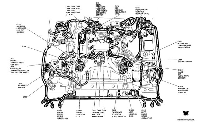

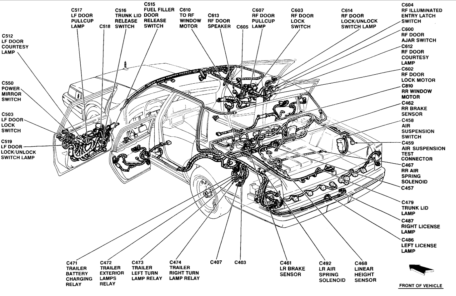

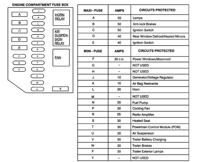

  • 75,988 POSTS
The compressor relay is in the relay center on the passenger side of the engine compartment
See the diagrams below
