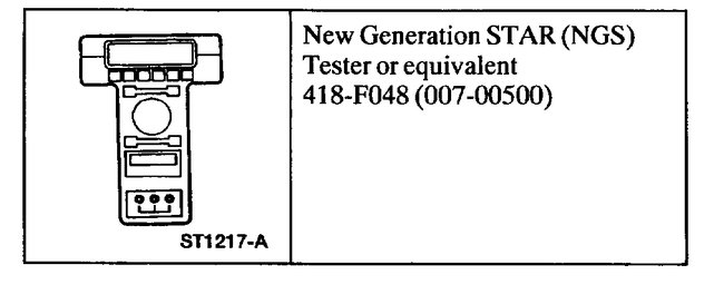

Have you checked for diagnostic trouble codes? That could help answer the question. Also, if you have a live data scanner, here is how to test both front and rear separately.

3. Connect NGS Tester to the Data Link Connector (DLC).
4. Select Air Suspension Control Module under Active Command Mode:
