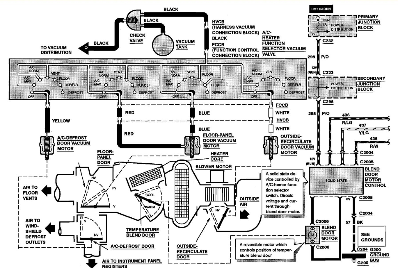

SURGEIMPULSE
  • 67 POSTS
I checked and as it turns out there is a yellow vacuum line that is not connected to anything, it is bolted down to hang next to the carpet. Is it supposed to just hang there and not be connected to anything? Maybe it is a intake hose or something.
Nov 1, 2018 at 1:12 AM
STEVE W.
  • 15,347 POSTS
Yellow is the line that goes to the defrost "motor" with it disconnected the door doesn't shut and the air all blows out the defroster.
Nov 1, 2018 at 9:13 AM

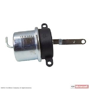

SURGEIMPULSE
  • 67 POSTS
Luckily I found that out myself with some research. I pushed down on the "motor" with my finger and it changed the door position in the vents, bringing air through the panel. I just need to reconnect the yellow hose to the nipple at the end, and it should be working fine, thank you! This is what it looks like, for people having a similar issue.
