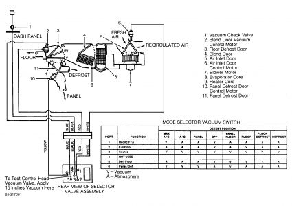

Ok I have had trouble with my compressor clutch locking up and I finally replaced the compressor, recharged the system and it worked great upon test drive. When I got back in it the top vents were not blowing. Everything else works but the top vents. I've checked the fuses but not the relays because I don't know how. Any help or info will be greatly appreciated.

Ok either there is a vacuum line that didn't get plugged in or one got cracked or the blend door acuator went bad. I would check vacuum lines first. Also is yours automatic A/C or manual. Here is a vacuum diagram to help.
https://images.2carpros.com/forum/automotive_pictures/249564_Manual_AC_1.jpg
