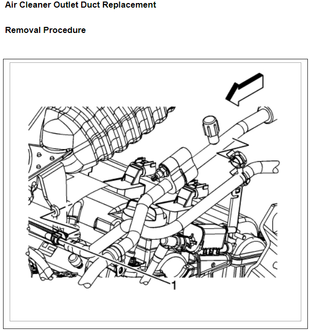

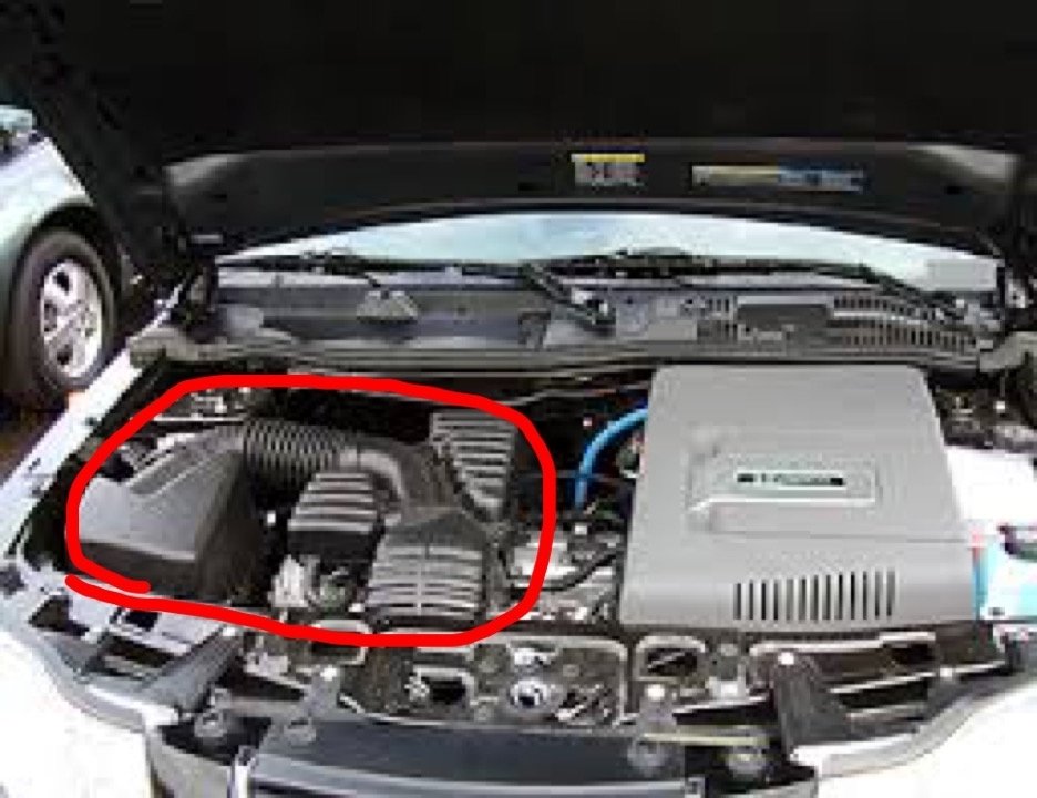

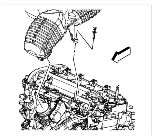

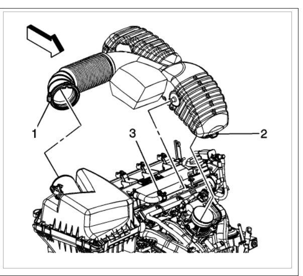

I am trying to get to my fuel injectors so that I can test and replace the faulty ones, but I cannot figure out how to get this thing off for the life of me!
Jan 13, 2018 at 4:29 AM
  • 55,433 POSTS
It looks like you have a couple of mounting bolts at the throttle body and air filter housing. Here are diagrams to help you get the job done (below).
