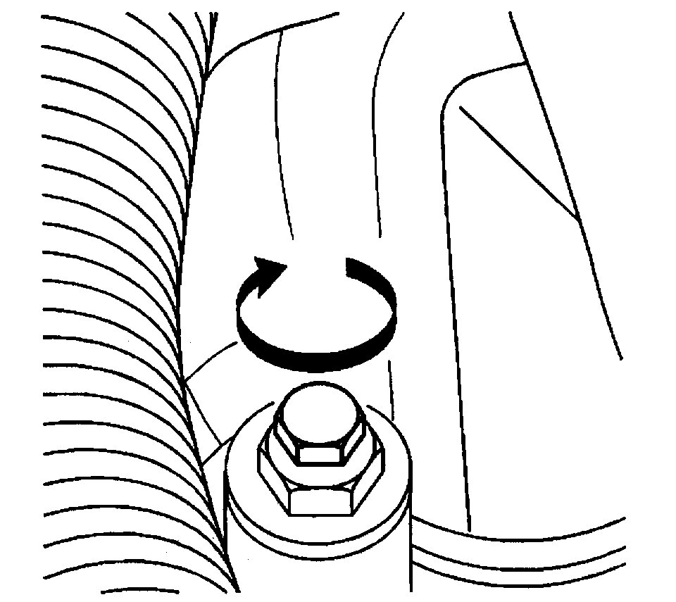

Refilling the system is straight forward. However, there is a bleeder that needs opened when you fill the system.

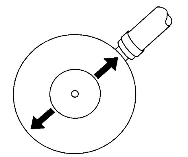

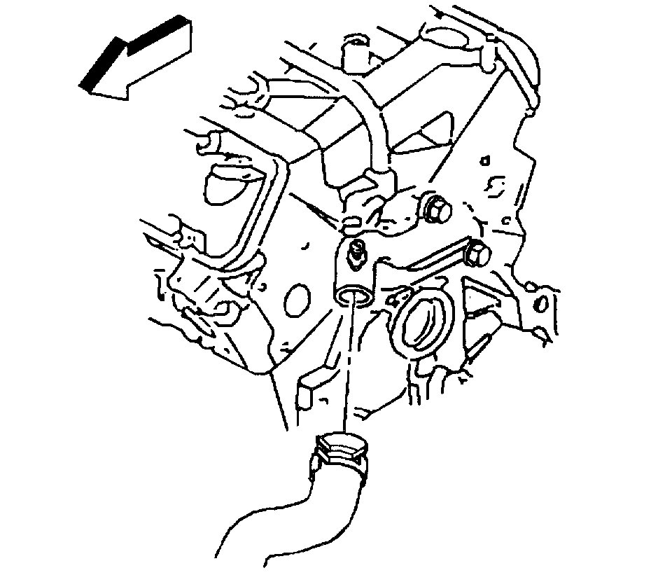

Here are the directions for refilling and bleeding the system. It starts with number 4 because the previous numbers are not relevant for the refilling process.
Notice: When adding coolant, it is important that you use GM Goodwrench DEX-COOL (R) or HAVOLINE (R) DEX-COOL (R) coolant. If Coolant other than DEX-COOL (R) or HAVOLINE (R) DEX-COOL (R) is added to the system the engine coolant will require change sooner-at 50 000 km (30,000 mi) or 24 months.
4. Slowly add a 50/50 mixture of GM Goodwrench DEX-COOL (R) or HAVOLINE (R) DEX-COOL (R) and clean, drinkable water to the radiator until the coolant level is at the base of the radiator fill neck.
5. Wait for two minutes and recheck the level of the coolant in the radiator. If necessary, add coolant to radiator until the coolant level is at the base of the radiator fill neck.
Picture 1

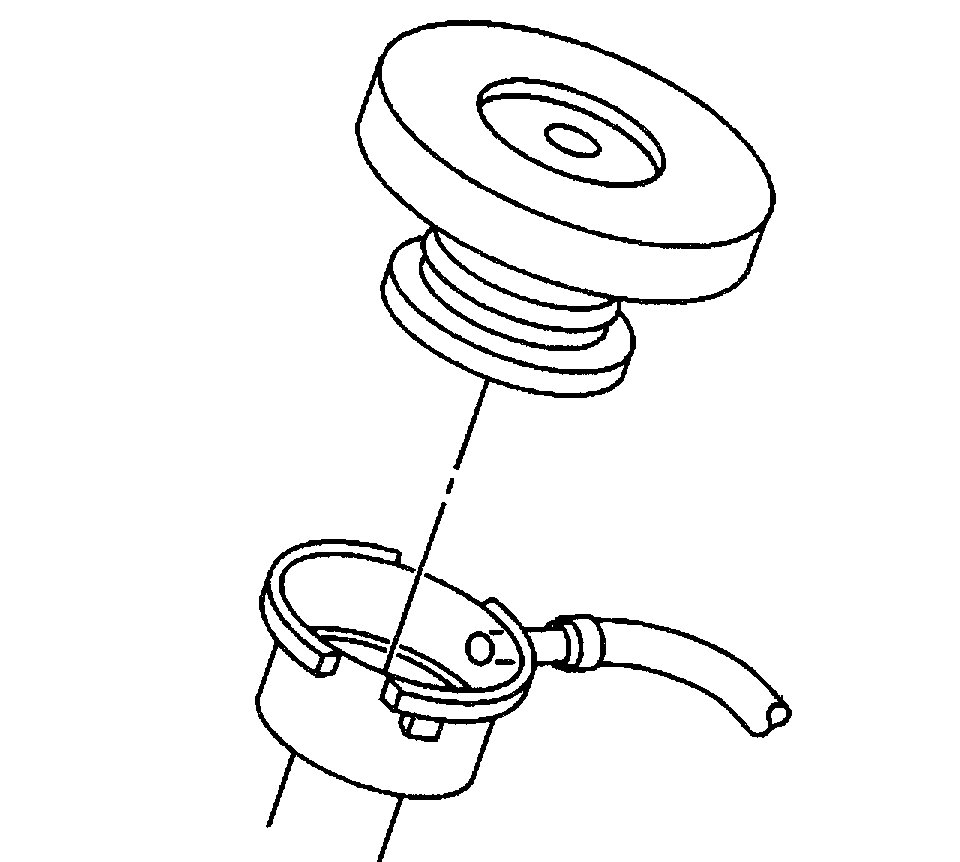

6. Install the radiator cap.
Picture 2
7. Ensure that the radiator cap arrow points toward the radiator overflow tube.

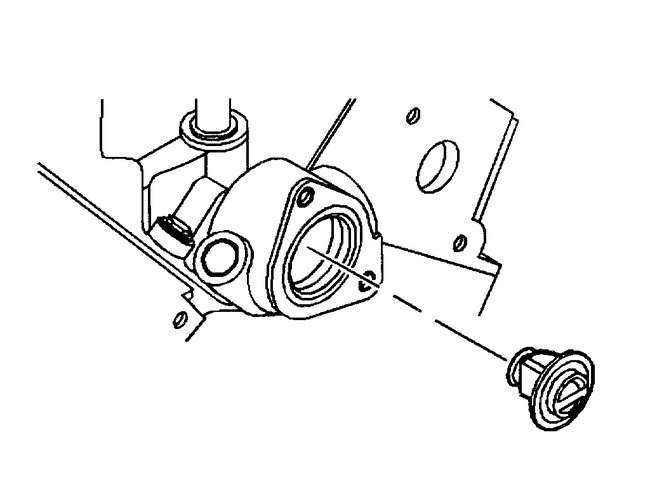

Important: The air bleed valves are brass. Do NOT over-tighten the air bleed valves.
Picture 3
8. Close the air bleed valve above coolant pump.

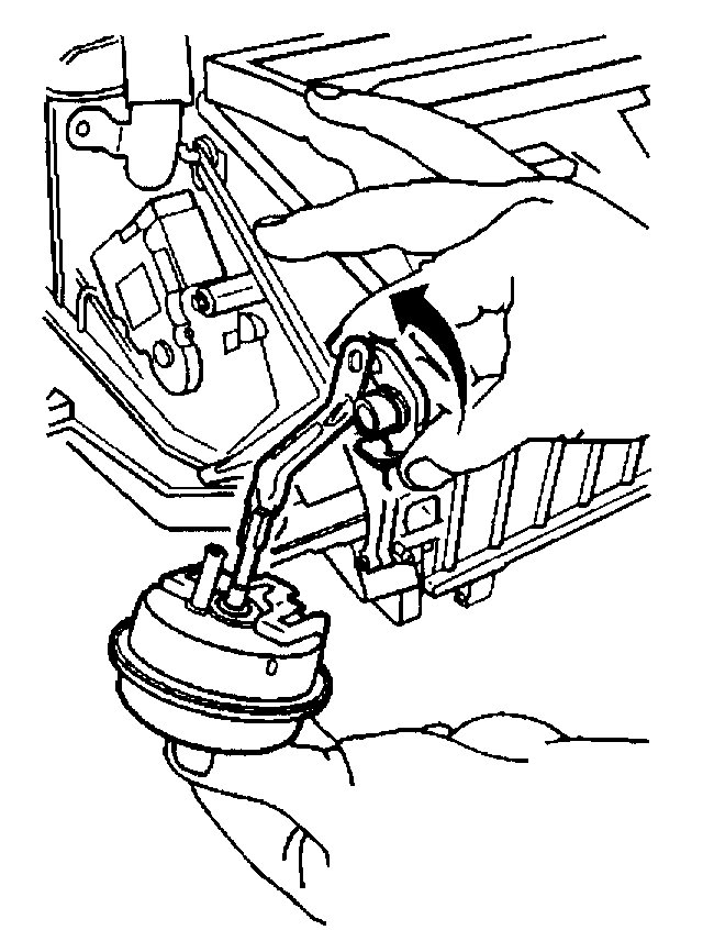

Picture 4
9. Close the air bleed valve on the thermostat housing.

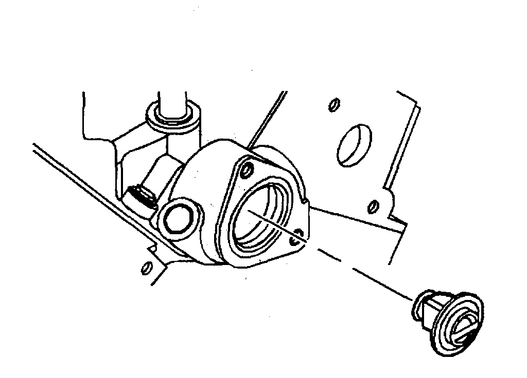

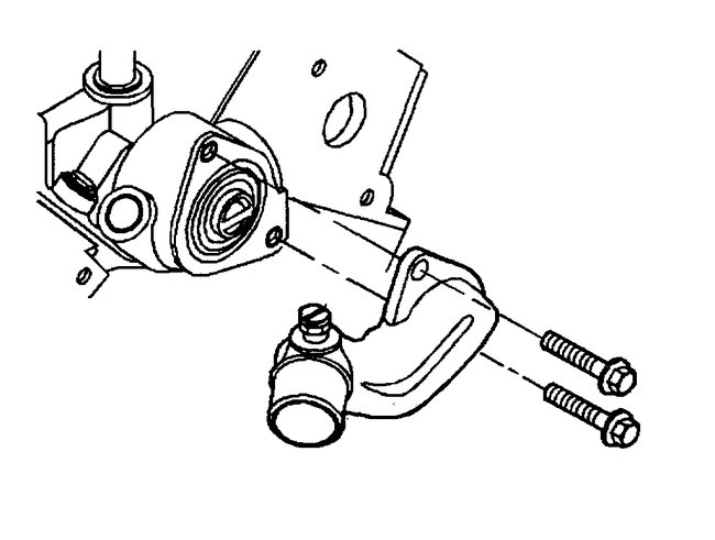

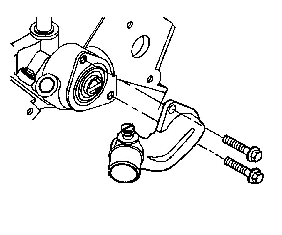

The sad part is if the thermostat needs replaced, you need to go through this all over again. Honestly, the bleeding process (bleeder) should have been opened when it was first being refilled. I wonder if that is why there is air blocked in places that are stubborn to get. Honestly, it may be time to replace the thermostat. It may be sticking or not fully opening.
Regardless, here are the directions for replacing the thermostat. I figured I would include them. The attached pictures correlate with these directions.
THERMOSTAT REPLACEMENT
Removal Procedure
Picture 1
1. Remove the air cleaner and duct assembly. Refer to Air Filter Element Replacement in Computers and Controls.
2. Drain the coolant until the coolant level is below the thermostat. Refer to Draining and Filling Cooling System.
3. Remove the radiator hose from the thermostat housing. Refer to Radiator Hose Replacement - Inlet.
4. Remove the thermostat housing bolts and clean any sealer from the bolt threads.
5. Remove the thermostat housing and gasket.
Picture 2
6. Remove the thermostat.

Picture 4
2. Install the thermostat housing and gasket.

Picture 5
4. Install the thermostat housing bolts.
Tighten the bolts to 25 Nm (18 ft. Lbs.).

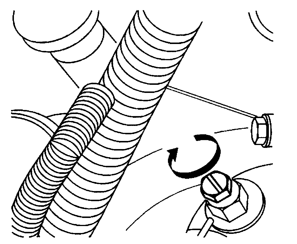

Also, here are the directions for replacing the mode door actuator so you can control air flow. The attached pics correlate with these directions
__________________________________________________
MODE ACTUATOR REPLACEMENT
REMOVAL PROCEDURE

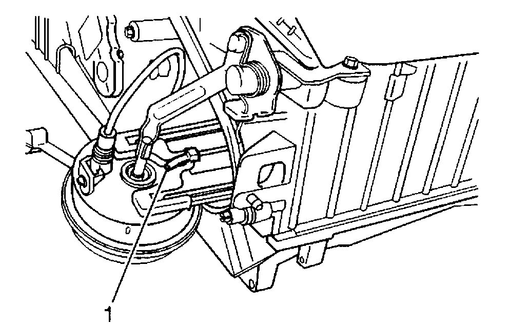

Picture 6
1. Remove the left instrument panel insulator.
2. Remove the knee bolster from the instrument panel.
3. Disconnect the vacuum lines from the mode valve vacuum actuator.
4. Cut the tie strap (1) that is on the back side of the mode valve vacuum actuator.
Picture 7
5. Lift to release the mode vacuum actuator retaining tab and just begin to slide the vacuum actuator toward the steering column.

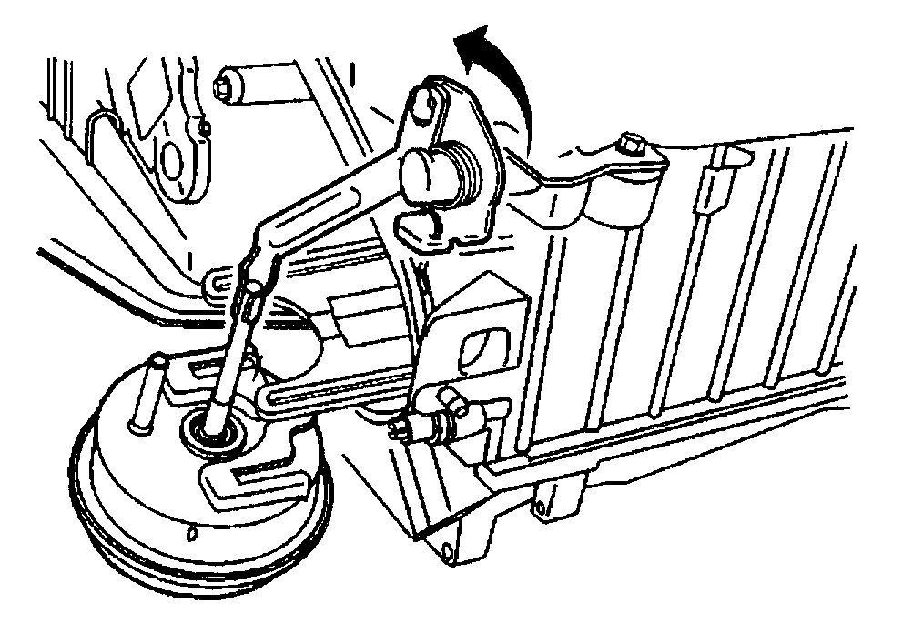

6. Rotate the mode valve lever fully forward (counterclockwise) and hold in place until instructed.
7. Carefully rotate the vacuum actuator toward the front of the vehicle until the actuator is released from the mounting pins on the HVAC module case.
Picture 8
8. Extend the vacuum actuator below the HVAC module case mounting pins, then slide the vacuum actuator rearward in vehicle, past the pins.
9. Disconnect the vacuum actuator pushrod from the mode valve lever and remove the vacuum actuator.
