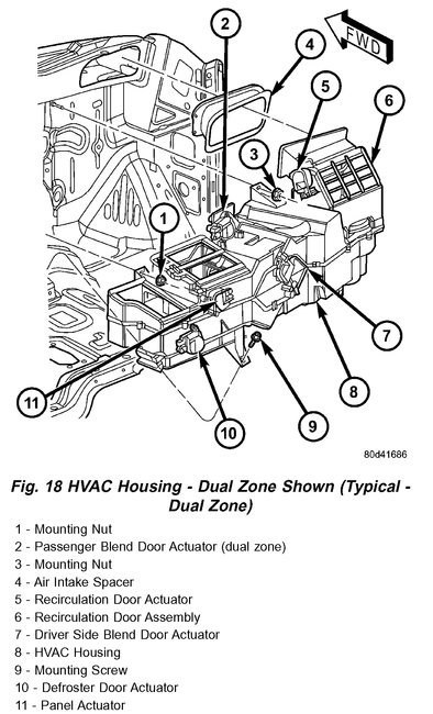

Cannot change the air flow direction when turning the selector knob. Air flows from floor vent regardless of position of selector.

Based on your description, it sounds like the mode door actuator has failed. The mode door is what determines air flow directions. The single mode door actuator is located on the driver side end of the heater-A/C housing unit, close to the top of the distribution housing.
Here are the directions for replacement:

3. Disconnect the electrical connector from the actuator (single or dual zone as required).

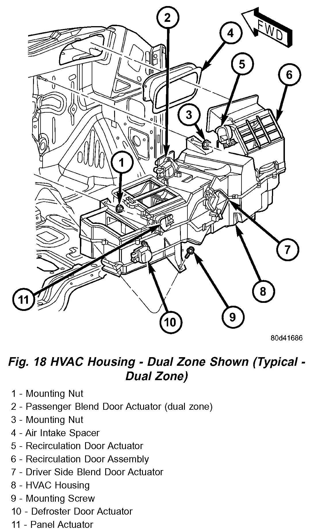

Fig. 18 HVAC Housing - Dual Zone Shown (Typical - Dual Zone)
see pic 11
4. Remove the two screws that secure the mode door actuators to the distribution housing. For single zone systems only lower actuator in present. For dual zone systems remove second actuator which is mounted on top of HVAC housing.
5. Remove the mode door actuators from the distribution housing.

1. Position the mode door actuators onto the heater/AC housing. If necessary, rotate the actuator slightly to align the splines on the actuator output shaft with those in the mode door linkage.
2. Install and tighten the two screws that secure the mode door actuators to the distribution housing. Tighten the screws to 2 Nm (17 in. lbs.).
3. Reconnect the HVAC wire harness connector for the mode door actuators to the actuator connector receptacle.
